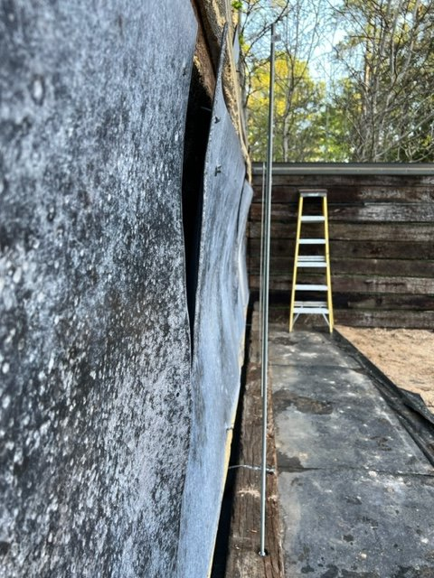

   / Lead Contamination at Shooting Ranges #29
I like that idea, may try it. So did he cut the rubber mats in the shapes of the steel plates?
Didn't need to. The Steel plates are full size 4'x8' half inch thick plates and oriented horizontally. The rubber mats are 5' by 4' (I think, or something like that). He hung them vertically, so 2 mats for each steel plate.
As a side note: He originally had 1/4" plates up, but over several years they were deformed and bulging by several inches (see photo) which caused him to go to 1/2". The new backstop is in front of the old one so more material in the backstop.
