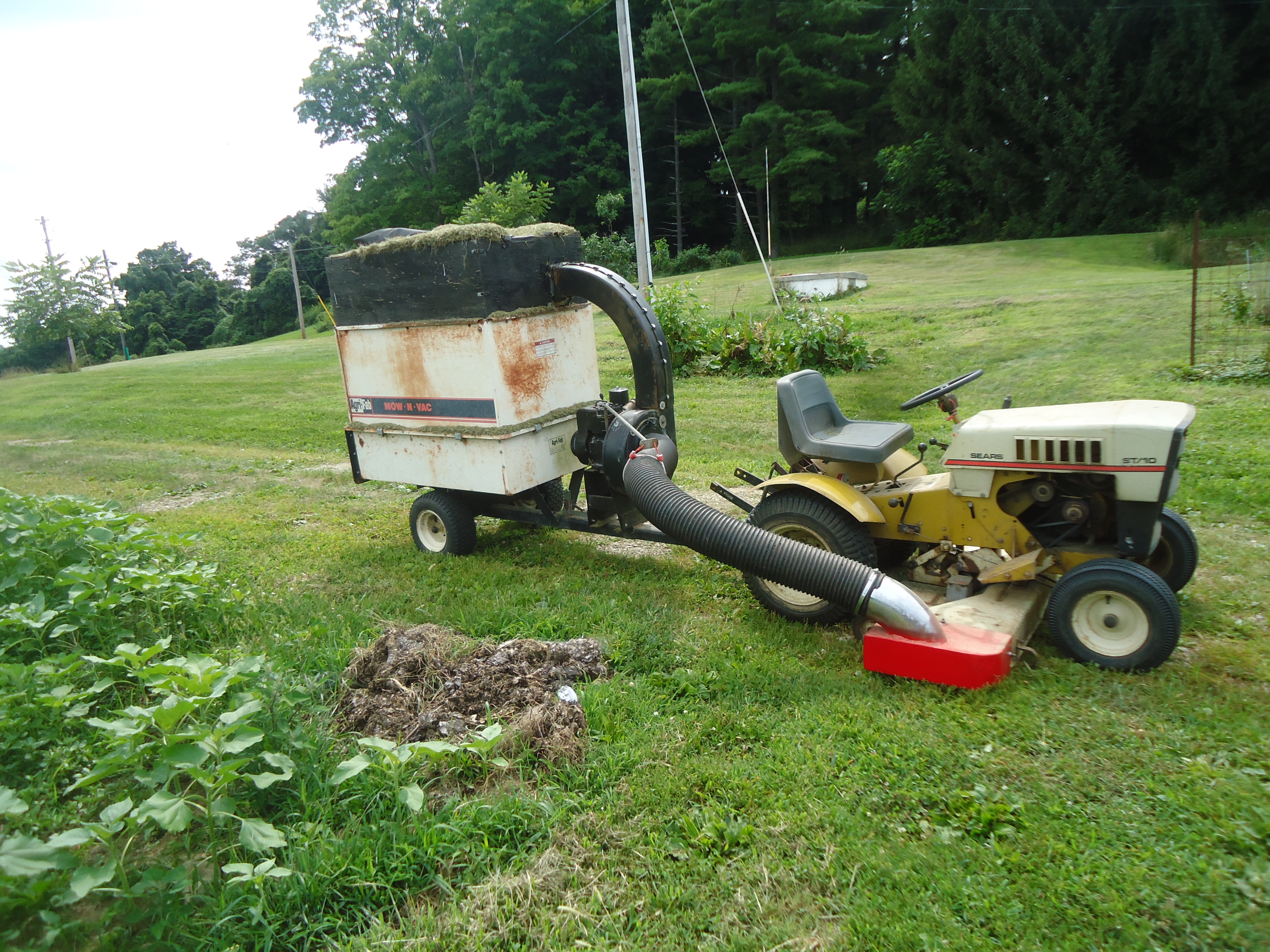

I have a tow behind vac, and unless its attached to mower deck and mower deck is spinning up, they don't pick up anything.... Mow deck has to lift the leaves and grass and then vac will suck them in, without mow deck running it does nothing...... But now with using vac I have piles of leaves to deal with.... I think mulching them is better if you can...
My JD L120 handles it well,.... Its great for just cutting grass, but just mulching has about same results....
