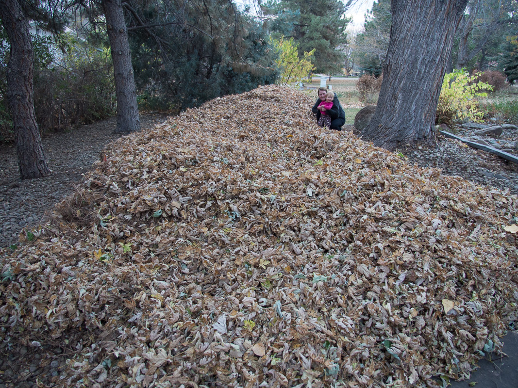

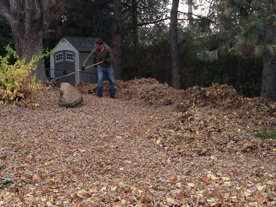

Time for a little leaf planning.
I'm on an acre, with about 1/4 of it getting pretty heavily covered by 6-12" of leaves (3 mature maples). Most of the rest of the lot is pines/spruce and some larger honey locust. About 35 mature trees, in total. Last year was the first year here, and using the small leaf shredder yielded about 3 yards of finely mulched maple leaves (about 800 lbs)... maybe another 4 yards of pine needles (now have a 3pt pine needle rake). It was painful shredding these with the electric shredder, and want to figure out an alternate solution this year for picking up and mulching the leaves well. The maple leaves are too think to leave... though I'd be OK leaving like 1/4 of them if mulched.
Equipment wise, I have a Massey Ferguson GC 1705 with the 60" MMM.
Using a sweeper, would I be able to pick up most of these leaves, once 'mulched' with my mowing deck? Or, would that still be pretty tedious (or not work well)? Most would be going to the garden.
Alternate solutions that would cost a lot more are a Protero PTO catcher (think I probably have enough HP to mow and vac?) or a Cyclone Rake or similar. Of course, for something I use a few times a year, I'd prefer to not spend tons of money, take up significant storage space, or have to maintain additional engines, if avoidable.
Thanks for your thoughts as to what I can get away with (with out great pain)!
The pile in the pics is about 3' tall.

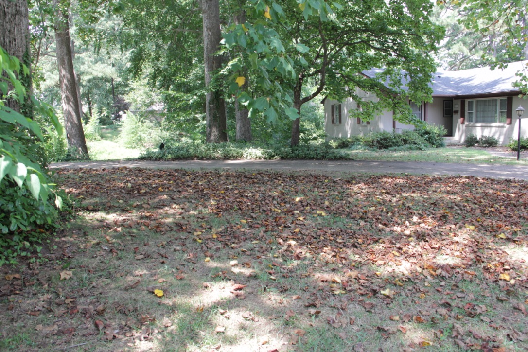

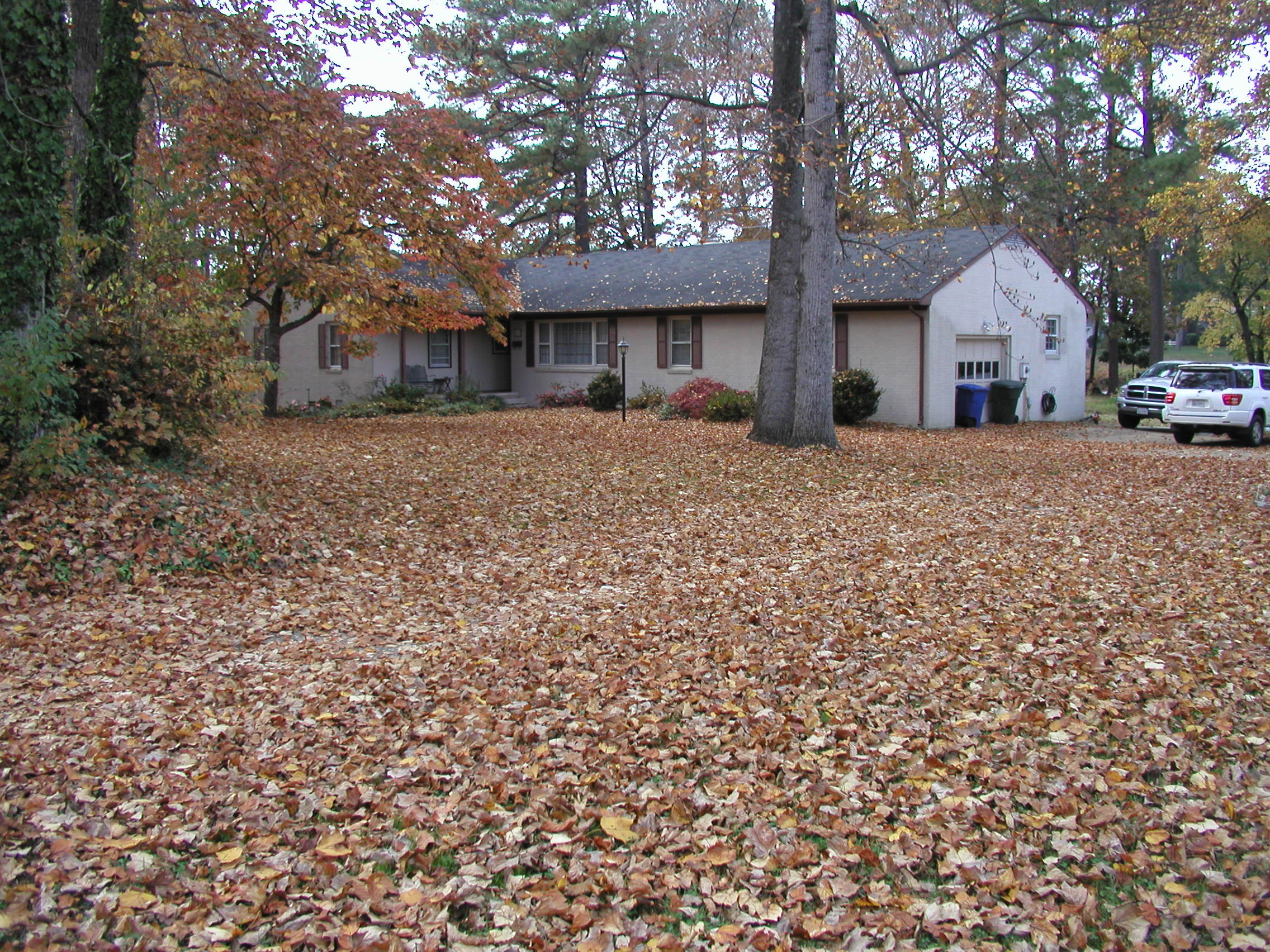

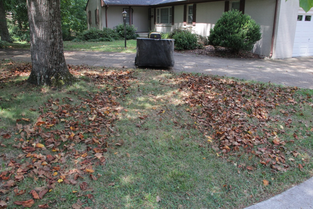

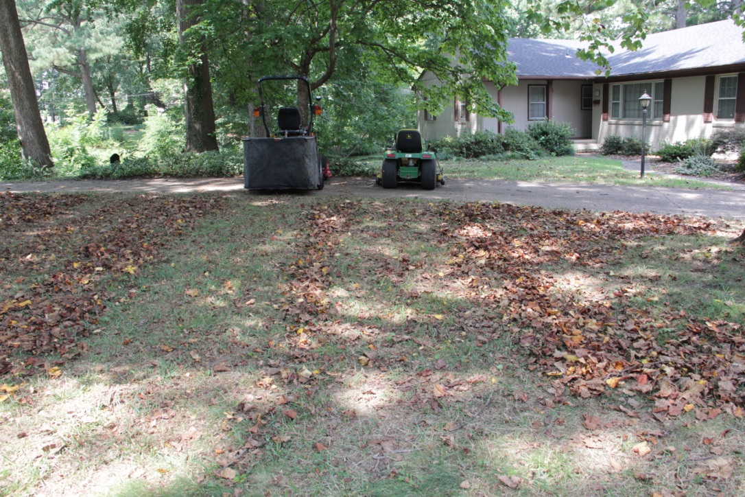

I do my lawn with a John Deere GT235 fitted with a mulching kit on the deck. I pull a Sears lawn sweeper to sweep up the mulch leaves. I have been doing it this way for years. I now own a Massey Ferguson with a dedicated mulching deck (disappointed, but more on that later).
When using a sweeper, the leaves have to be mulched or the sweeper will fill too quickly. The good part is you can cover a large area with minimal manual labor, and do so very quickly. Mulching the leaves, will leave crumbs all over the yard, but you will not notice them unless you get close and look down. If you don't mulch, and just sweep, then the sweeper cleans the yard very well, but the sweeper gets full quickly and keeps you busy just emptying the leaves.
Here is a fall photo, my JD and sweeper takes care of this, but I won"t let it get this bad very often.
I had some early leaves come down so I did an experiment comparing the JD to the Massey Ferguson with the Mulching deck. With and without the sweeper.
As you can see the MF with the mulching deck left a strip of non-mulched leaves in the center but a sweeper cleaned it up. The problem is un-mulched leaves take up too much space in the sweeper.
The JD with the sweeper does a better job, I have no complaints
