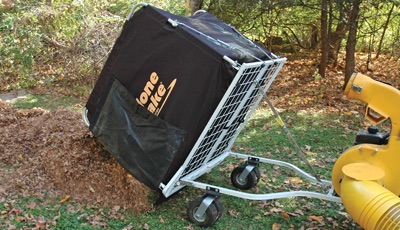

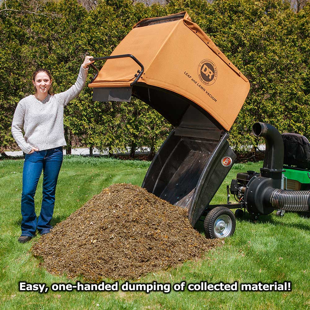

Since I just purchased one of these about 18 months ago, in case it's helpful, here's why I chose the DR over the Cyclone Rake.
1. DR has a toothed metal impeller that also mulches. Since most of my leaf collection is in areas where the mower can't/shouldn't go, and I wanted to compost, this was important.
2. I liked that the path from the mower discharge to the impeller was level, whereas the CR it curves up. Figured less chance for clogs.
3. Overall sturdiness, the DR seems miles above the CR. Size of wheels, the construction of the collector, ease of dumping, etc.
4. Price is about the same.

I like the DR better than the CR if I was choosing between the two it would certainly be the DR. Space isn't really a concern for me as I have a pole barn for my attachments. I would agree the DR is a better built product just from the pics. The price for the Trac Vac is a bit over 3k so a bit more expensive

I don't really want to start an argument, but I don't think the impression that the Cyclone Rake is lower quality or less sturdy than others is correct. There is a difference between designed heavy and designed well. The CR is optimized to be able to store by hanging on a wall. If that's not important, other options may be better. However, if you talk to CR owners, you will find they are virtually indestructible. I don't really claim to have extreme long term experience, but after 7 years of use, mine looks essentially new.
Of the units out there, the DR does stand out because of the shredding impeller, which I was not aware of. The CR stores best and has the rigid mount, which has some maneuvering advantages. The Trac Vac and Agri Fab units seem to me more basic. Around here they are commonly available used, generally needing repair and looking pretty beat up.
By the way, the small, heavy duty wheels are a feature on the CR. Since they swivel, they can be under the unit, minimizing width. Dual wheels are an option for use in rough ground.

No argument at all! It was a tough decision between the two, as each definitely has its points. With our rough mountainous terrain, the sturdiness of the DR was attractive.
One final point, the CR pulls directly in line with the tractor; jacknife-proof but also less manuverable. With all our tight spaces, trails, etc., the DR won out there too. And yes, I have jacknifed it. :)
I was really attracted to the plastic impeller on the CR as there is simply no avoiding sucking up rocks around here, and they claim the impeller is rock-proof. So that was a big plus for the CR, though you do lose mulching ability.
