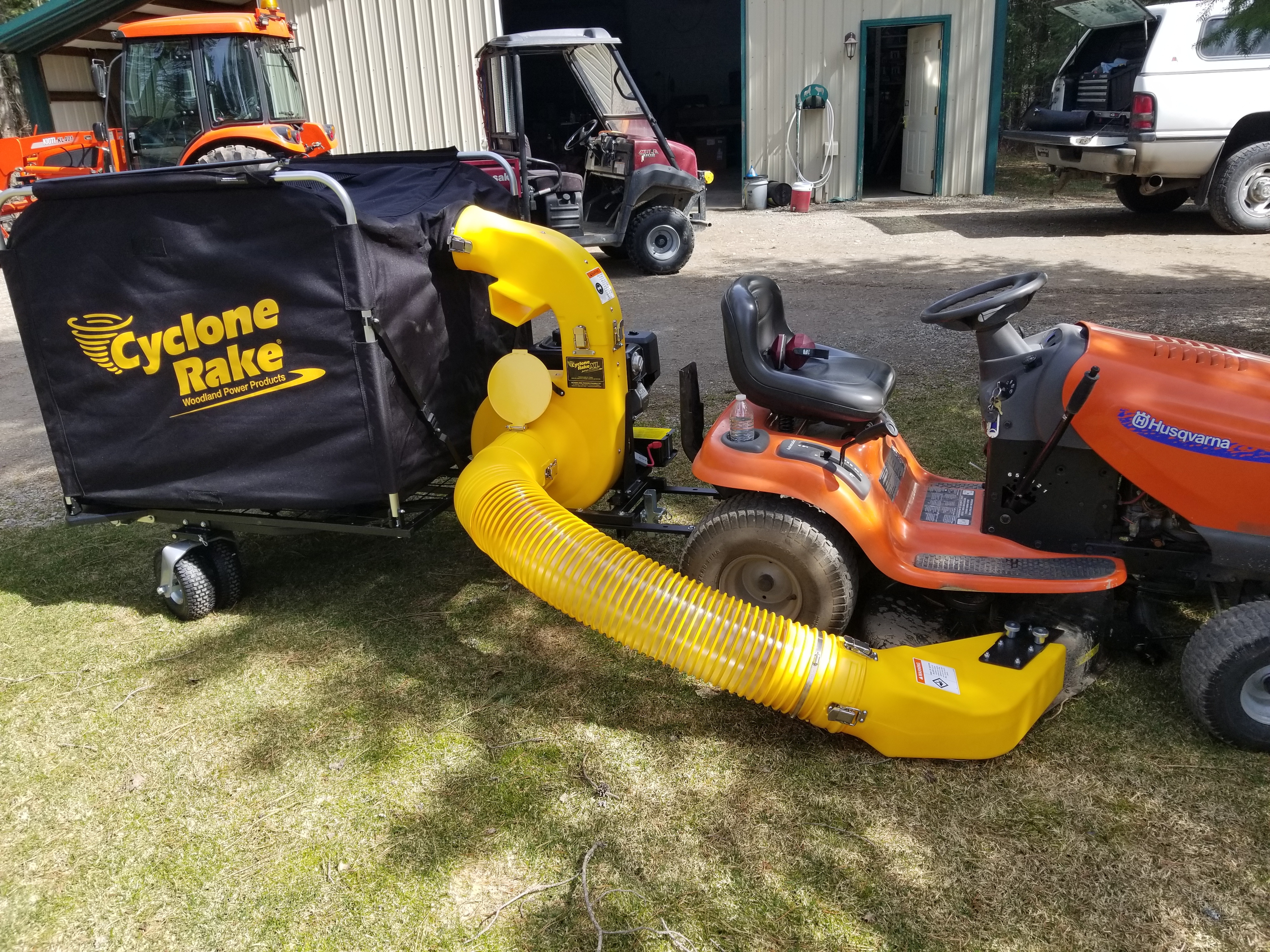

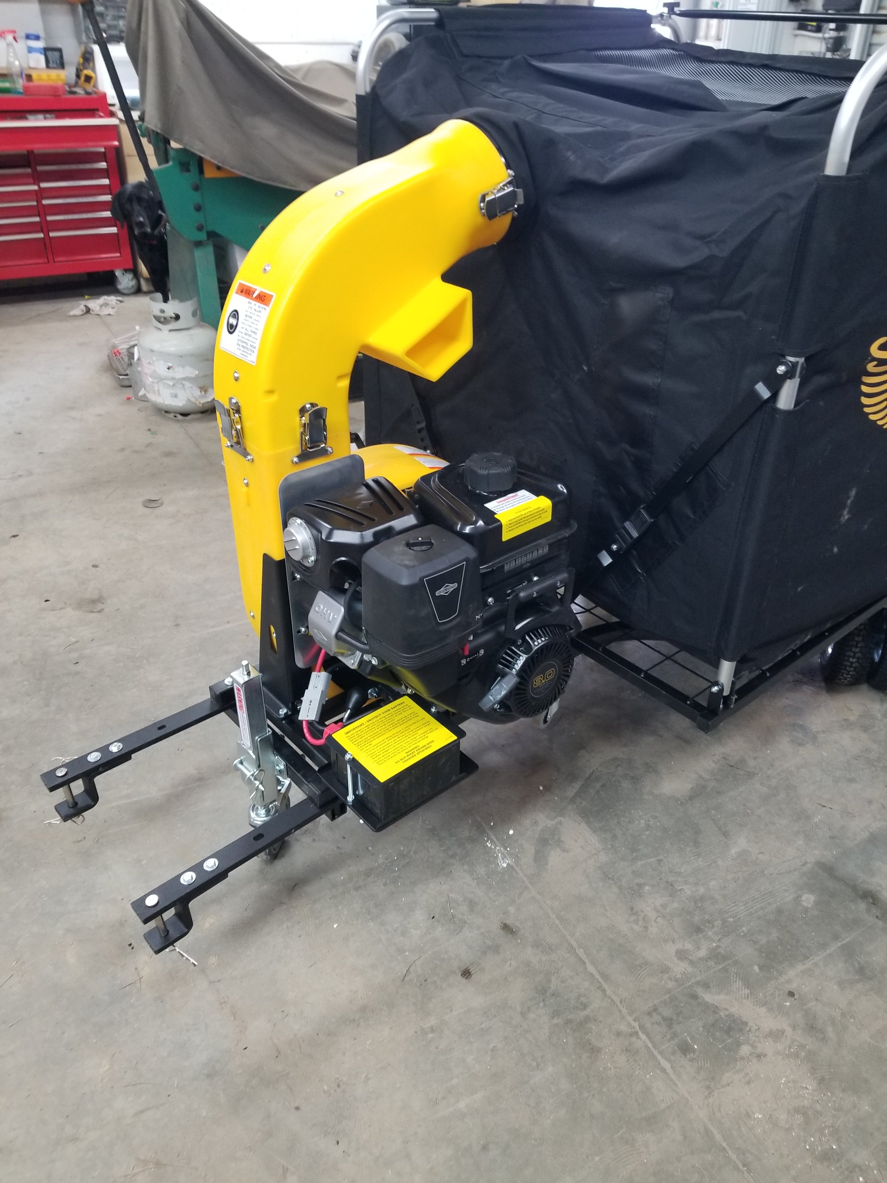

/ Leaf Vacuum/ grass catcher #8
I have a cyclone rake, and its amazing. However it takes abit of room to maneuver. If you have lots of tight spaces and trees, not the best option.
8hp elect start motor, large, heavy plastic impeller. It eats pinecones for breakfast.

/ Leaf Vacuum/ grass catcher #10

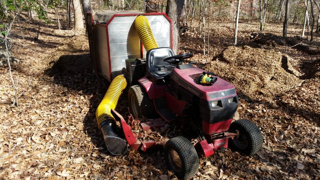

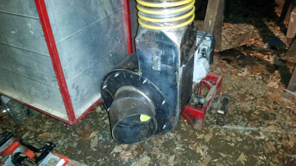

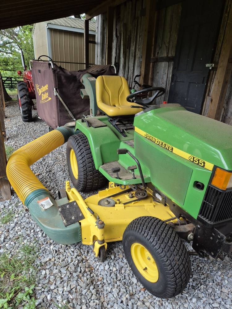

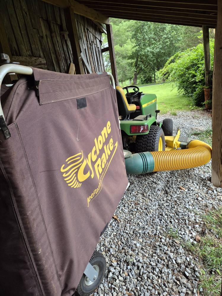

View attachment 3521875View attachment 3521876
Yes. As he said the Cyclone wants to "scoot" around when turning which I have to keep in mind going around sheds & buildings. The TracVac blew out mulched leaf bits which Cyclone doesn't do much.
