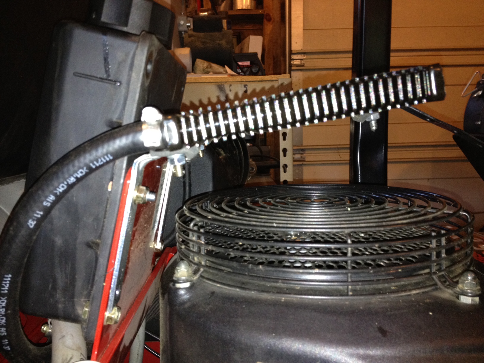

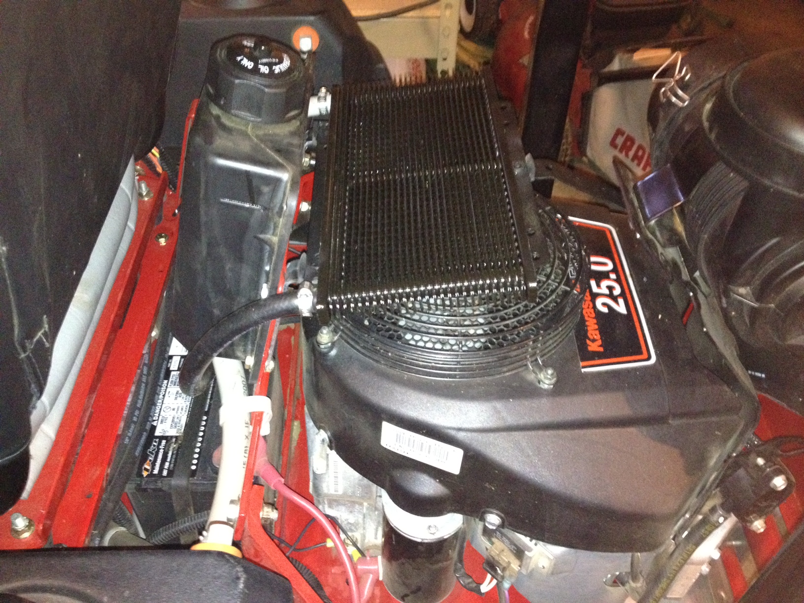

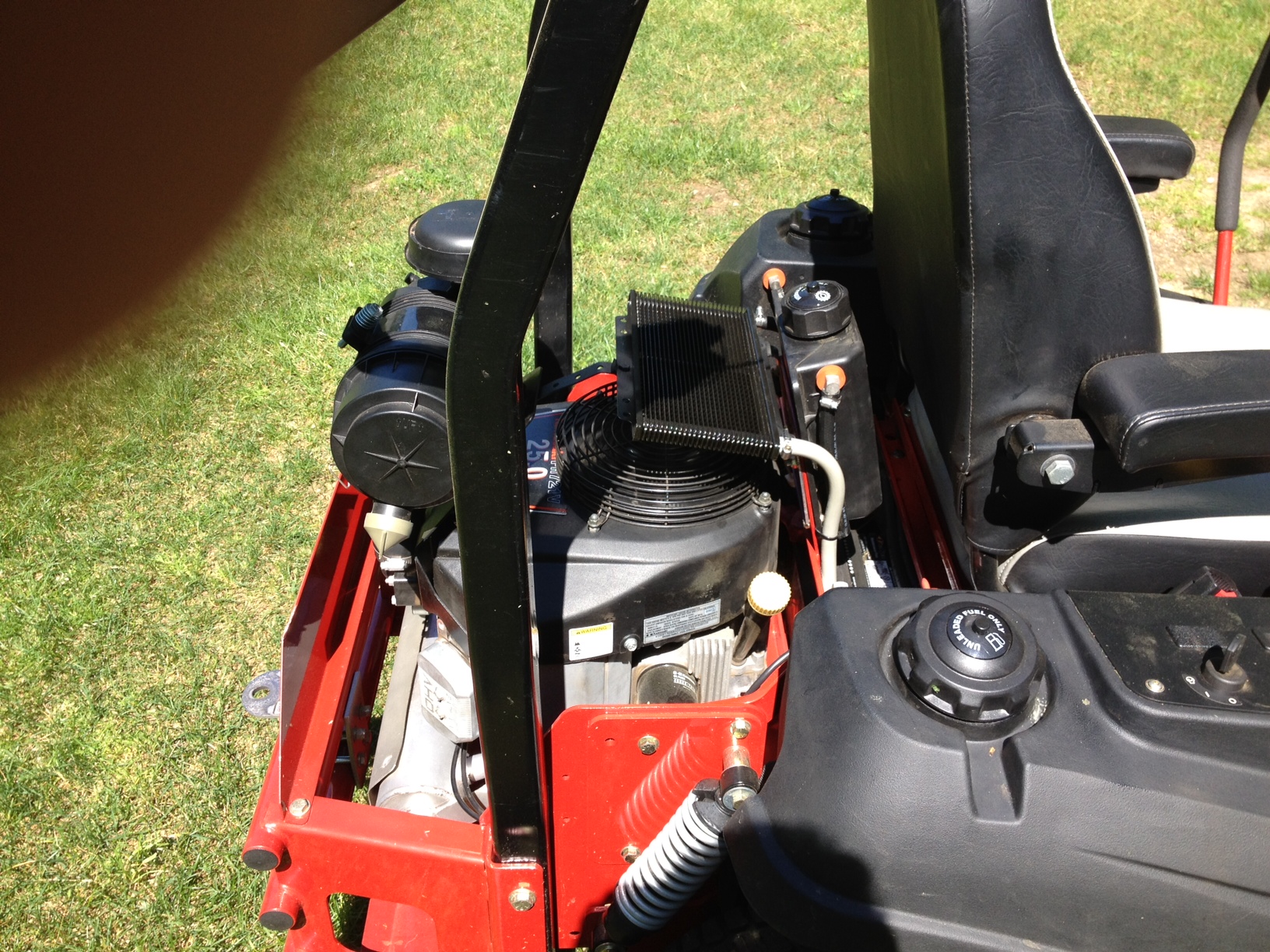

I got the Ferris Zero turn in 2010 52" deck IS2000 with 25 HP Kawasaki (commercial unit with separate pumps and wheel motors) and started using that with the trac vac and noticed the hydro oil was getting hot 200* when pulling the trac vac and it smelled a bit burnt. So I spoke to Ferris and they said these machines are not meant to pull heavy loads, then I noticed the larger Ferris machines had a transmission cooler installed, so I fabricated one using a 40$ transmission cooler and piped the return lines to the holding tank thru the cooler, changed the oil.
Now the temp doesn't get over 150-160* and no more burnt oil and no issues pulling the trac vac for the last 9 years. So your concern about the lighter duty ZT mowers and towing IMO is valid, so if you do get the Kubota Z400 get a smaller Cyclone rake model. If you want to go bigger, I would look at some near commercial - like the Exmark, Scag, Kubota line if you plan to tow a bigger leaf vacuum for the long term. Also get Gator blades for your zero turn and mulch them into the grass, then windrow them and vacuum them up - this reduces the volume and vacuum and clean up time a lot.
