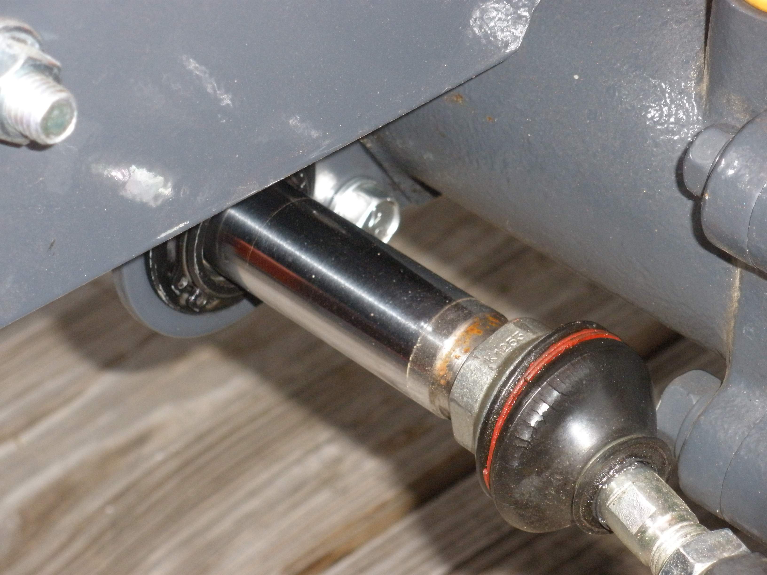

There is most likely another oil seal behind the wiper seal that is visible from outside, the inner seal is what holds back the oil pressure. Good side is they will have to polish off that rust to make the repair and if too pitted will have to replace the rod.

When I dropped her off they told me this had happened before, infrequently, on other new tractors as well. Something about Kubota buying the cylinders in bulk and they sit around until installed sometimes allowing enough moisture inside to cause rusting. So yes, most probably an inner seal. Kinda hope they do replace the cylinder, that way both sides will be new and I won't need to worry about or expect the same thing on the right side.

Called the dealer this morning to check on my BX. He said the mechanic had it in Fri and ordered a cylinder rebuild kit. Not sure when it'll be in but hopefully won't take too long to install when they get it. I hope they rebuild the entire cylinder so I don't have to worry about the right side later but he wasn't sure what the kit included. I also heard that alot of BX and B model's front axles come from the factory low on oil so I asked them to check and top off if needed and if this was covered by warranty. It's covered and they will.
