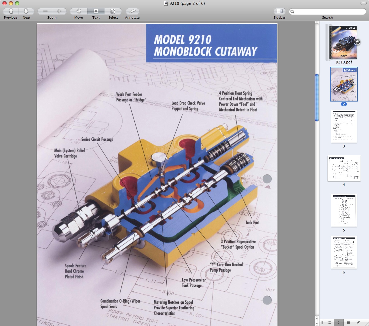

The attachments are for Husco valve One is a the hydraulic schematic and the other is a sectional view. On the sectional view it shows a combination wiper / spool seal. If you follow the blue coring in the casting you will see that this is the tank line. IF this tank line is connected to another function down stream then you are pressurizing this tank port. What this sectional does not show is the "power Beyond" feature which would be connected to the orange "Y" core thru pump passage.
On some models of valves you have to install a plug to isolate the Power Beyond from the tank port. If this plug is not installed and the valve is used in a power beyond circuit two or more things can happen.
1) The system relief will not operate when the power beyond feature is active. reason is that the relief spring chamber is now being pressurized.
2) spool seals leak.
3) casting cracks.
Hope these crayons help.

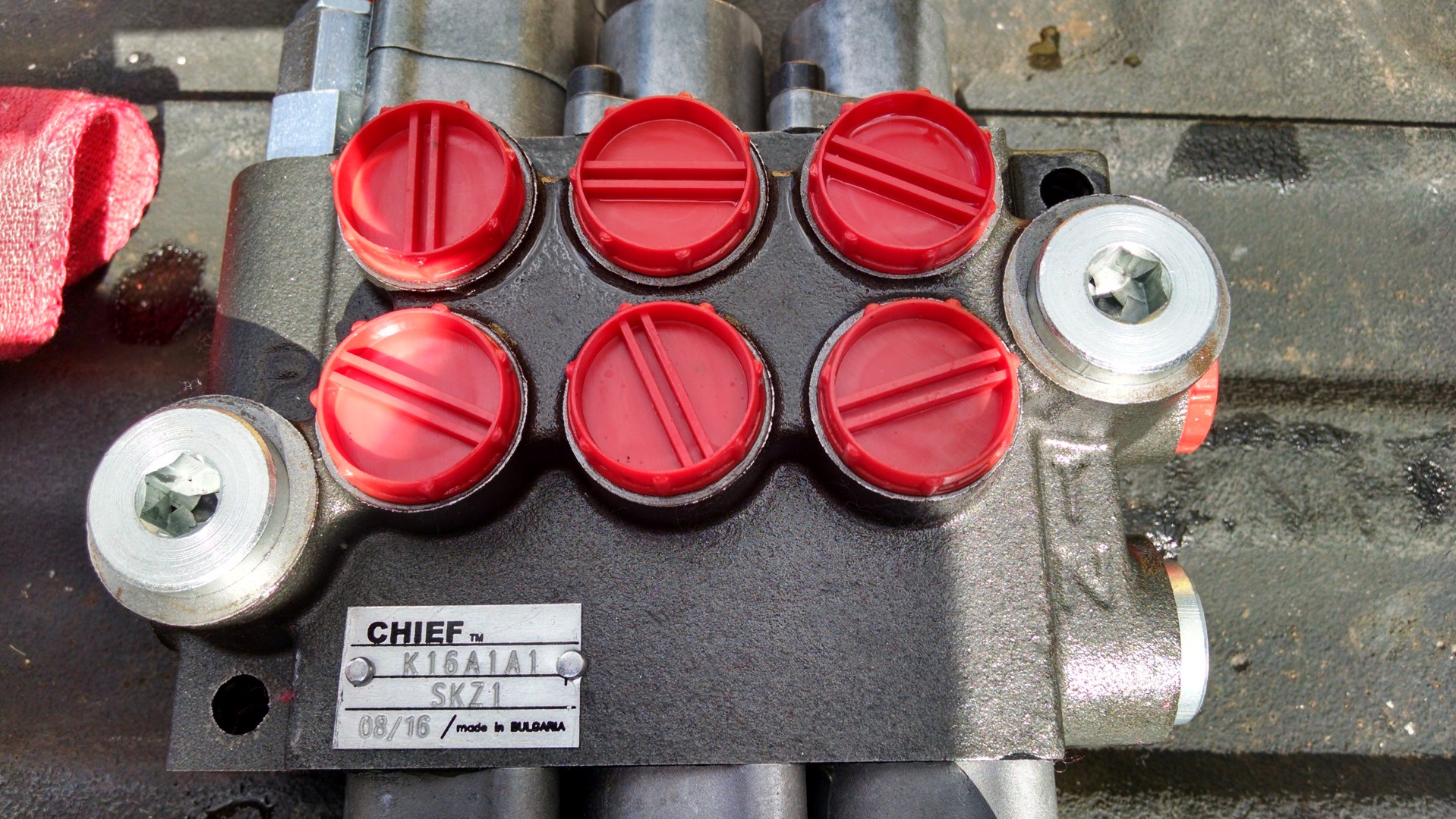

Ok, I've got the hose routing sussed out, with pics. Whether it's hooked up correctly: You review, you decide.
Let's start with the basic 3 spool 10 gpm Chief prior to painting:
In the above pic, you can see the input/output ports clearly (I hope) marked. "P" to the left; "N" and "T" to the right, with "T" on top. P = Power Beyond, T = Tank, N = ???. Again, not to belabor the point, but LD has this same exact valve on his M-series Kubota, so he can clarify/correct any of the above.

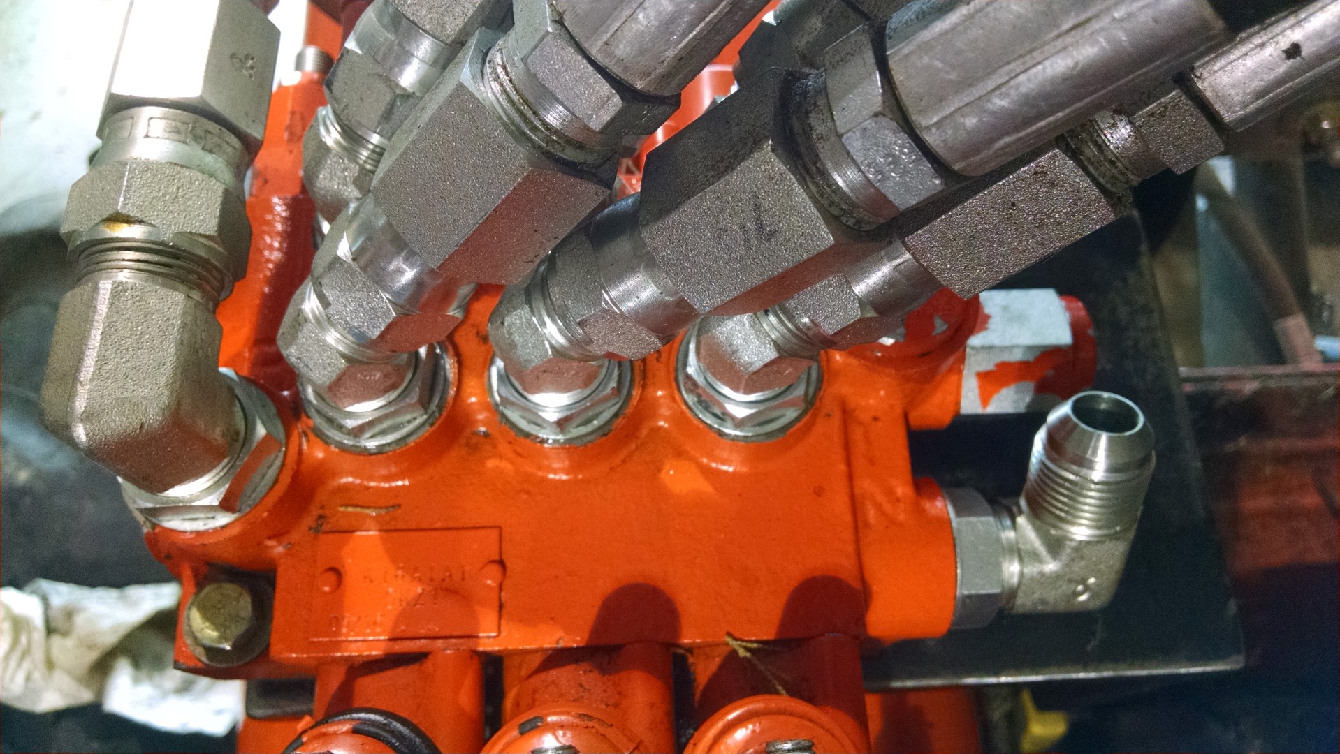

Now, here is the same valve in the same orientation, but painted and hooked up, except for the "N" port since I unkinked the hose before taking pics.
In this pic, you can see what appears to be the Power Beyond plug installed on the "T" port.

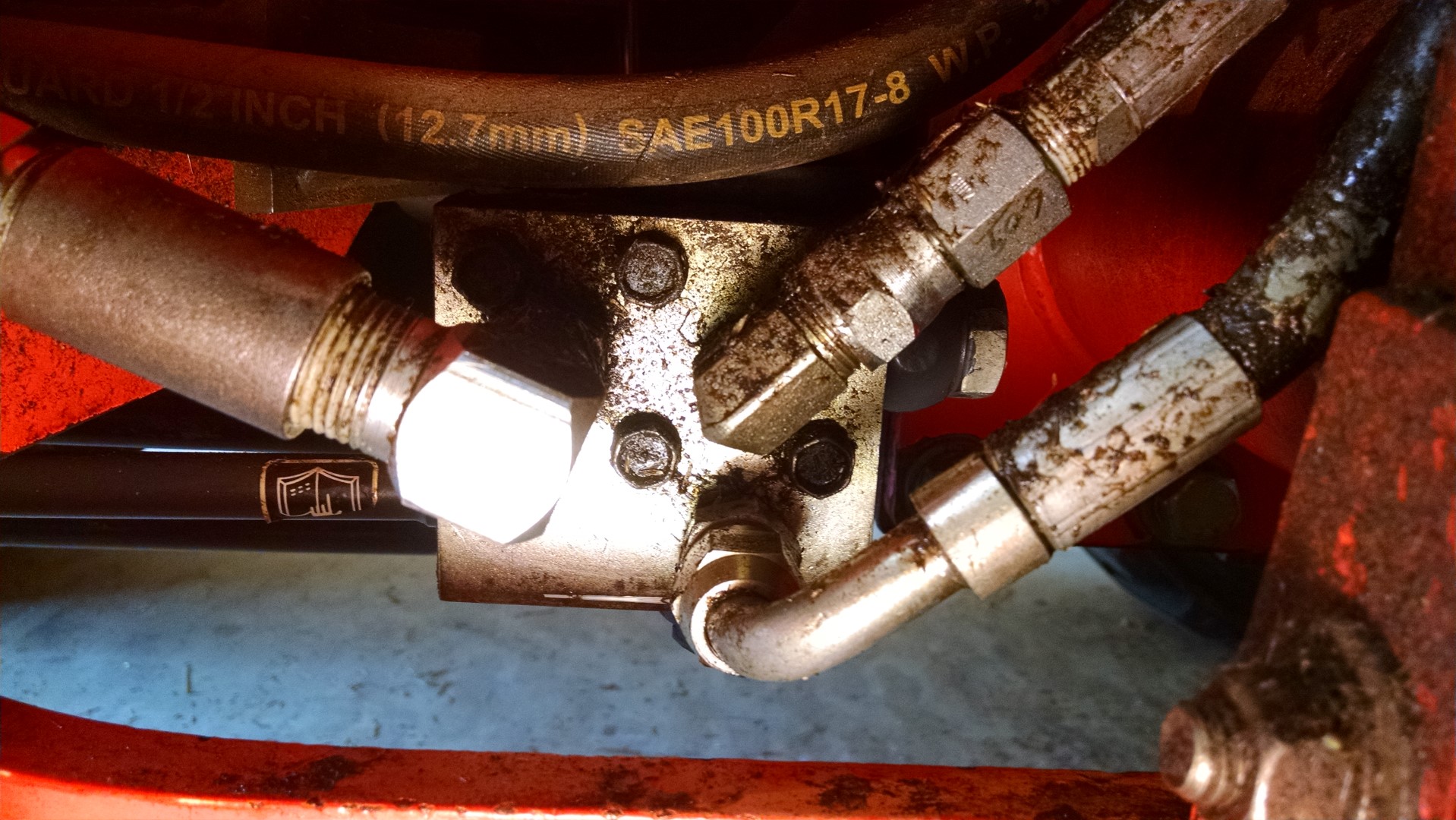

And in this pic, you can see the "N" port is connected to the hydraulic block on the tractor:
In the above pic, the "N" port hose is the one on the left center. The "P" port hose is the upper hose that is going to the 3rd function valve. ETA: I don't know what "hydraulic block" this is on the tractor since it doesn't show it on the hydraulic system diagram in the WSM (page 8-M1). I *assume* it was added along with the FEL when the FEL was added (at the factory?).
So basically, the Power Beyond goes to the 3rd function valve. The "N" goes to the tractor's hydraulic block and the "T" port is blocked by the Power Beyond plug.
Is this valve connected correctly?
