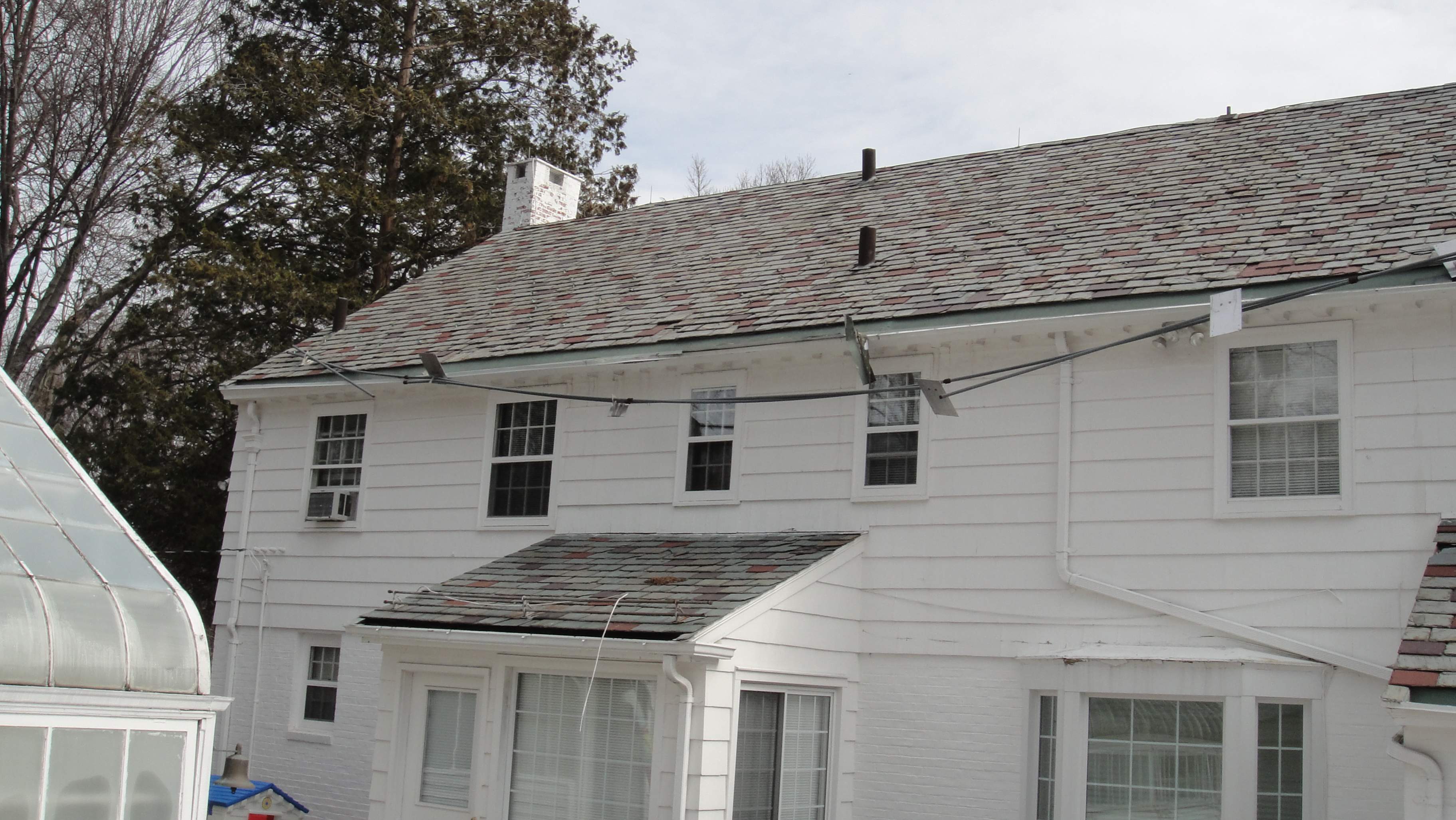

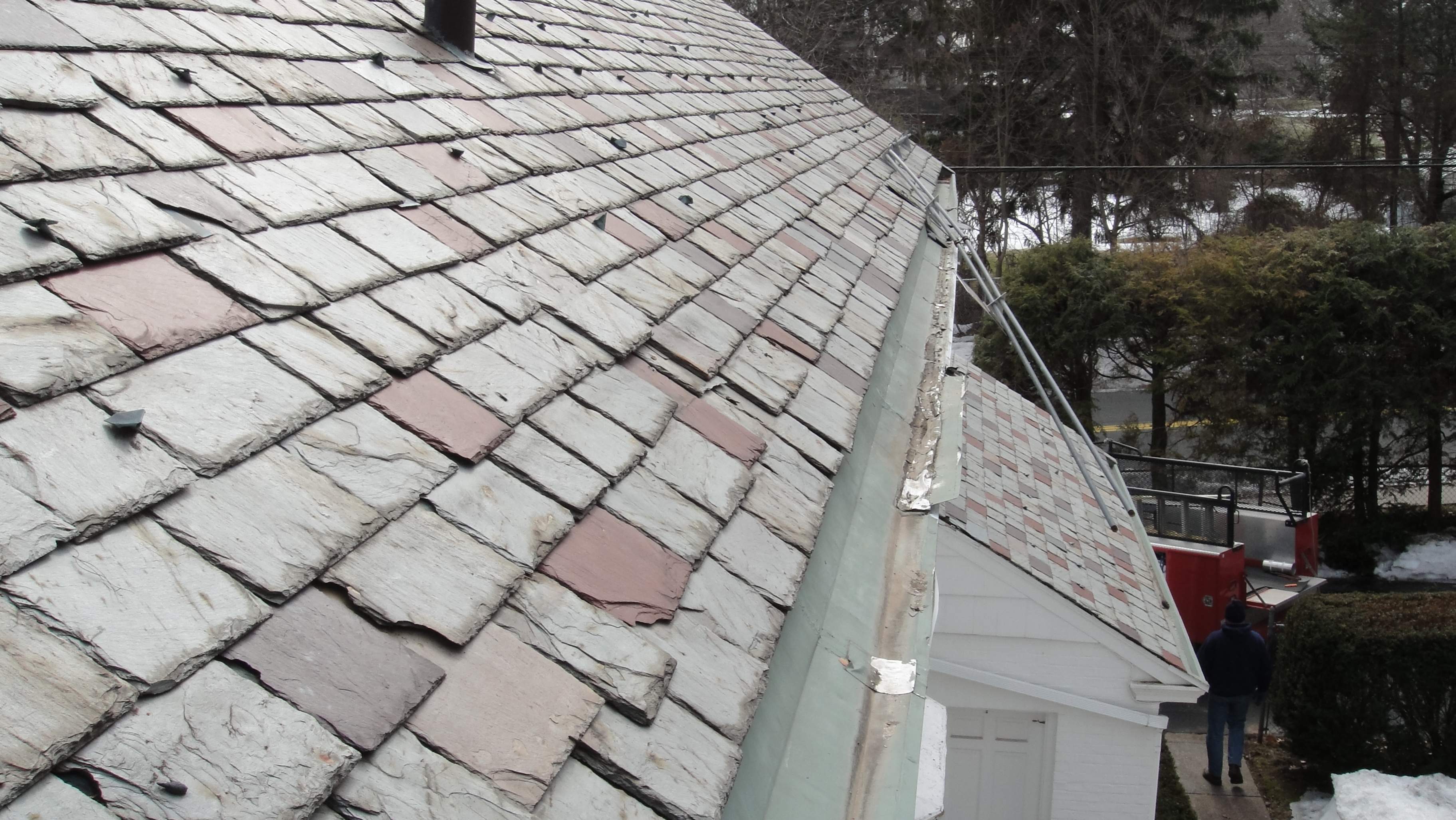

If I put a rope over the ridge and put my weight on it , it is likely to destroy the slate on the ridge. The ladder needs support from below. This stuff is quite fragile. The ordinary approach to working on the roof is supposed to be lifting the slate out of the way where you want to walk. The 4th slate I lifted was split entirely through horizontally. 1 of 4 did not strike me as good odds to lift several dozen. The stuff is not holding up as it is supposed to.

I'm curious what makes this roof so different, is it the material or the way it was installed? is it real natural slate? Or some artificial material. I'm not doubting you anymore, just curious.
Couple of pics of what snow load can do, theses are schd 40 steel pipes with SS mounting plates that got ripped off this 80 year old roof. Damaged the slate around the mounting plates but the rest of the roof is still in very good condition. Notice some of those never fading colors, after 80 years in the sun and still the same color, nothing man made can do that.

The slate is real slate, with widely varying thickness. I am in a forest and I was trying to make things as fire resistant as I could. I was looking at metal, but did not like it. Tried artificial slate, but I could not find any where the actually material was fire rated. A lot of them said they were fire rated but if you poked around real hard in the specs; it was only if you put a fire rated roof under them. Then I found this stuff.
The way it is installed is to lay down horizontal strips of galvanized strips and nail that to the roof. They have stainless steel wires with hocks on the end. Over this you put foot or so wide continuous roll stiff plastic sheeting.
This plastic is the waterproof membrane. Then starting from the top down, you stick a piece of slate up under the one above, place it a bit behind the hooks and slide it down to contact the hooks. Repeat as needed.
During installation we found that you just could not walk around on the stuff. Too many broke. The idea was that if you need to access the roof, you pull up slates and set them aside and walk on the exposed plastic. Which, incidentally, is quite slippery. Particularly when wet. I would not let anyone on the roof when there was dew or rain. As noted above somewhere, the fourth piece I tried to lift off had split into two pieces. Hence my effort to be able to distribute forces enough to move on top of the slate.
The manufacturer claims 100 year life. The problem that is developing is that the slate is shedding layers. It is not tight enough and freeze/thaw seems to be deteriorating it. So far it has not caused major obvious problems. And the slate is not the waterproof layer.
