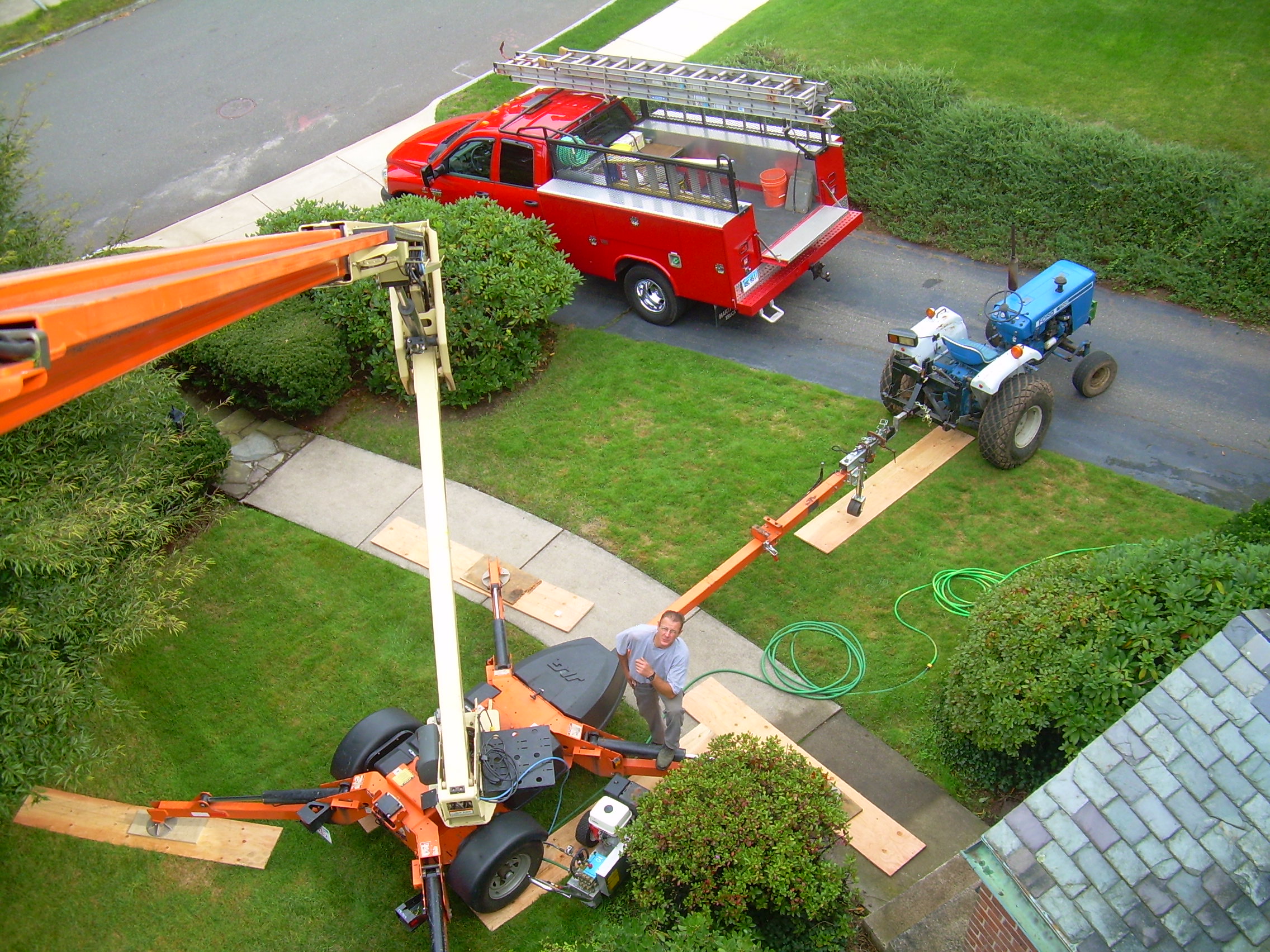

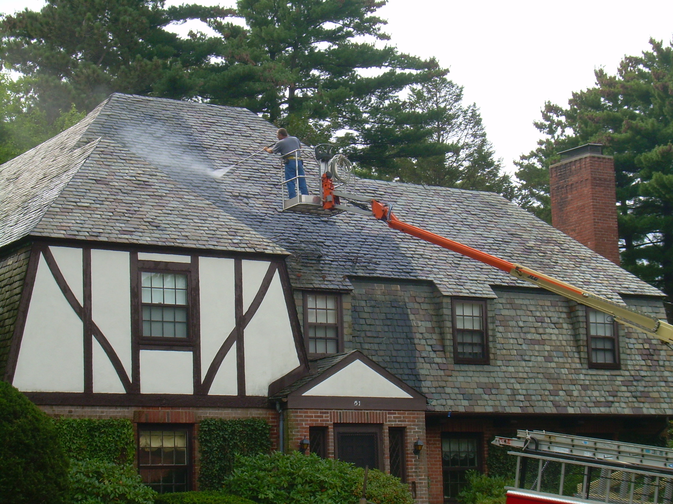

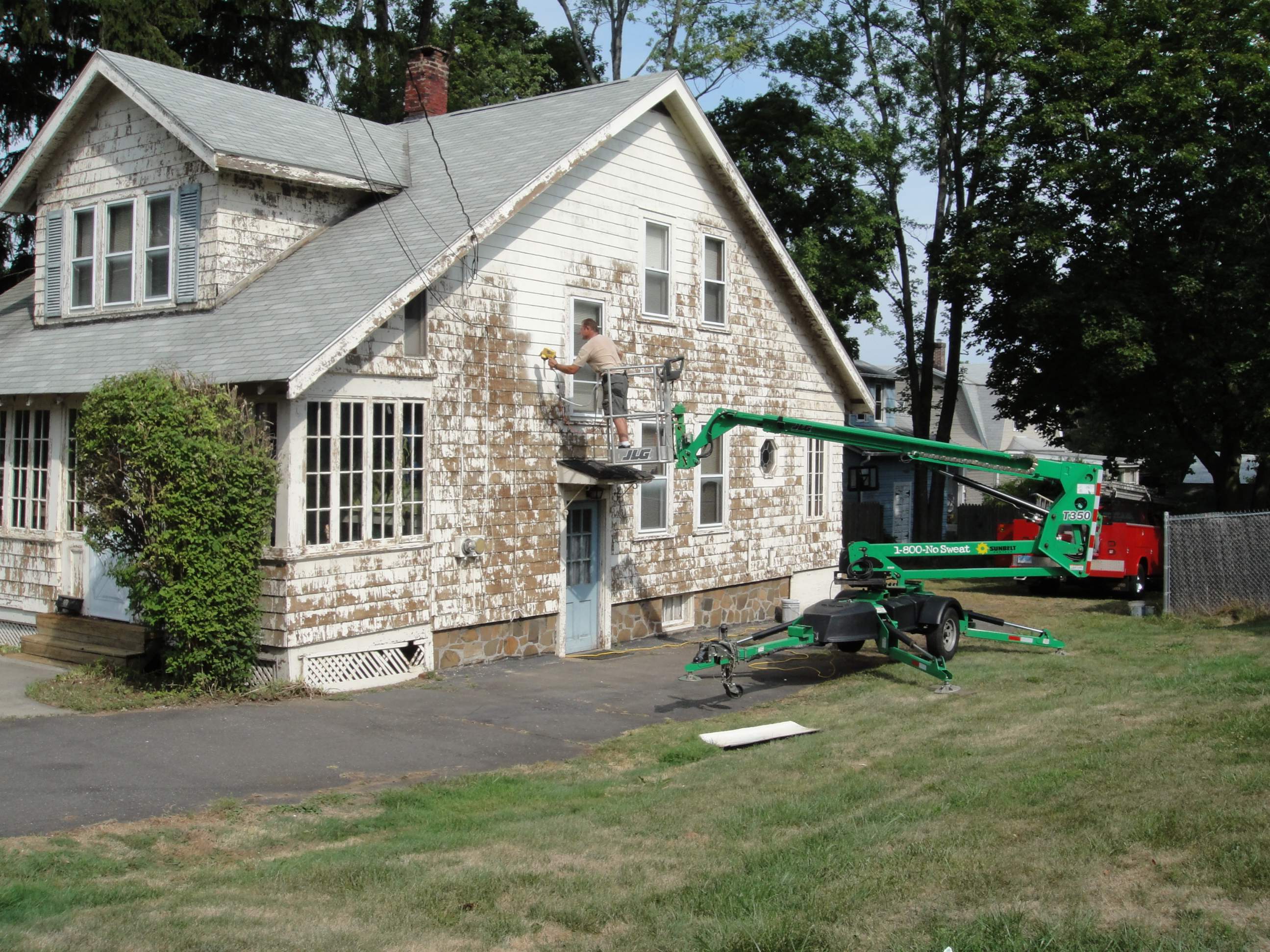

Yes that is a premium lift. Very expensive, I've never seen them for rent, only one tree company around here has one. The one this guy has will fit thru a 30" gate! I've been thinking someday when I can't climb ladders anymore, I may invest in one so I can keep working.

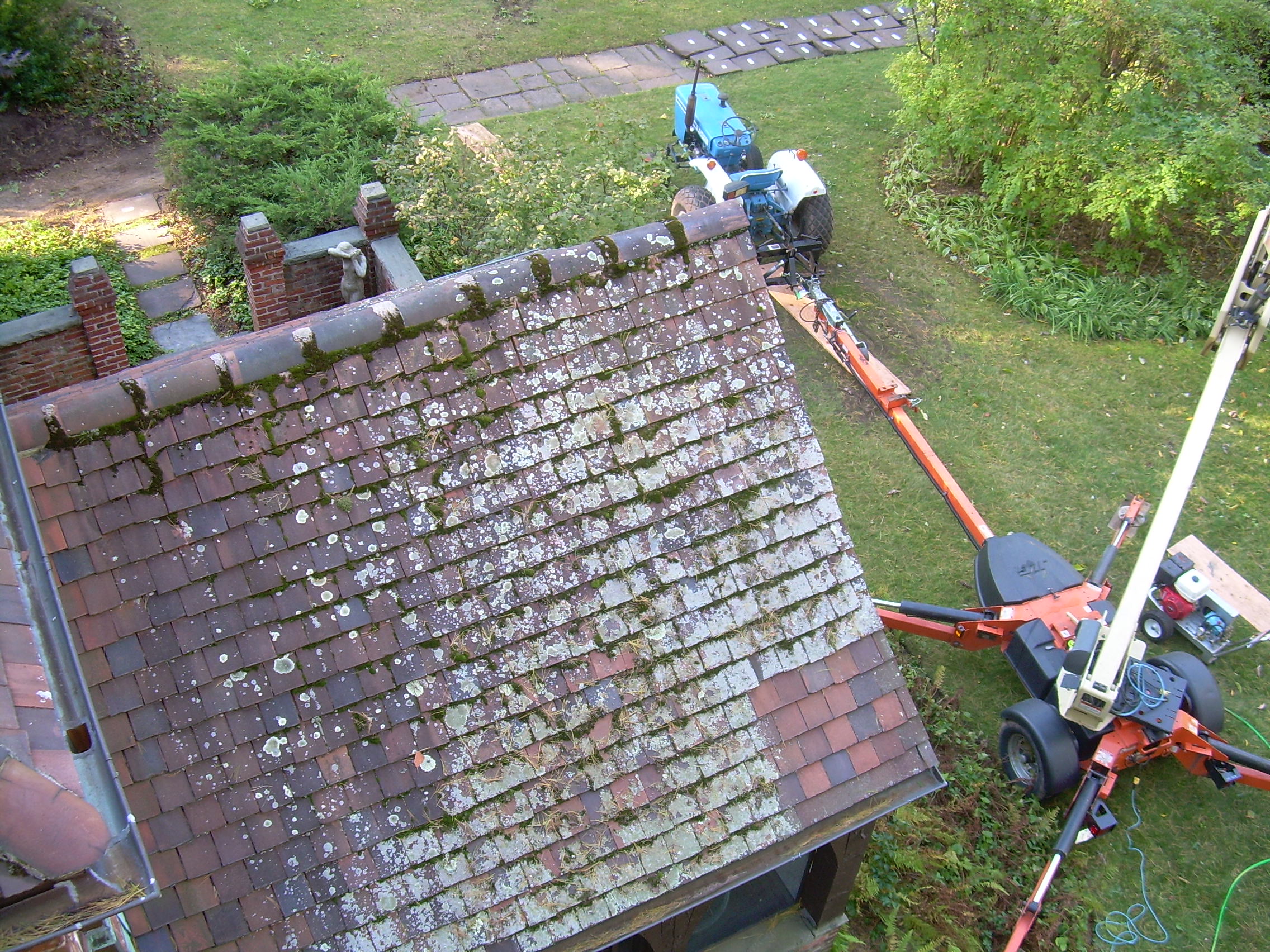

Most of the rental companies have tow behinds for like you said a couple hundred a day, in 35 and 50 footers. i pulled mine around with a 3pt receiver hitch on my tractor, much more maneuverable than with a truck.
I respect your cautious approach, but I think you are being over protective. there's no way the roof can be that delicate as to worry about the pressure points a sheet of plywood would excert. If it were that susceptible, it would not be suitable for protection against the elements. But to try and help further I would say maybe that 1 inch thick Styrofoam board glued to the plywood, it comes in large sheets and should eliminate that pressure point fear.
Matter of fact, it sounds like it's the concentrated pressure you are concerned with, you may just use the foam board, no plywood??
Some pics of tow behind boom lifts, the green one is 35 foot and the orange is 50 foot. Very capable little machines.

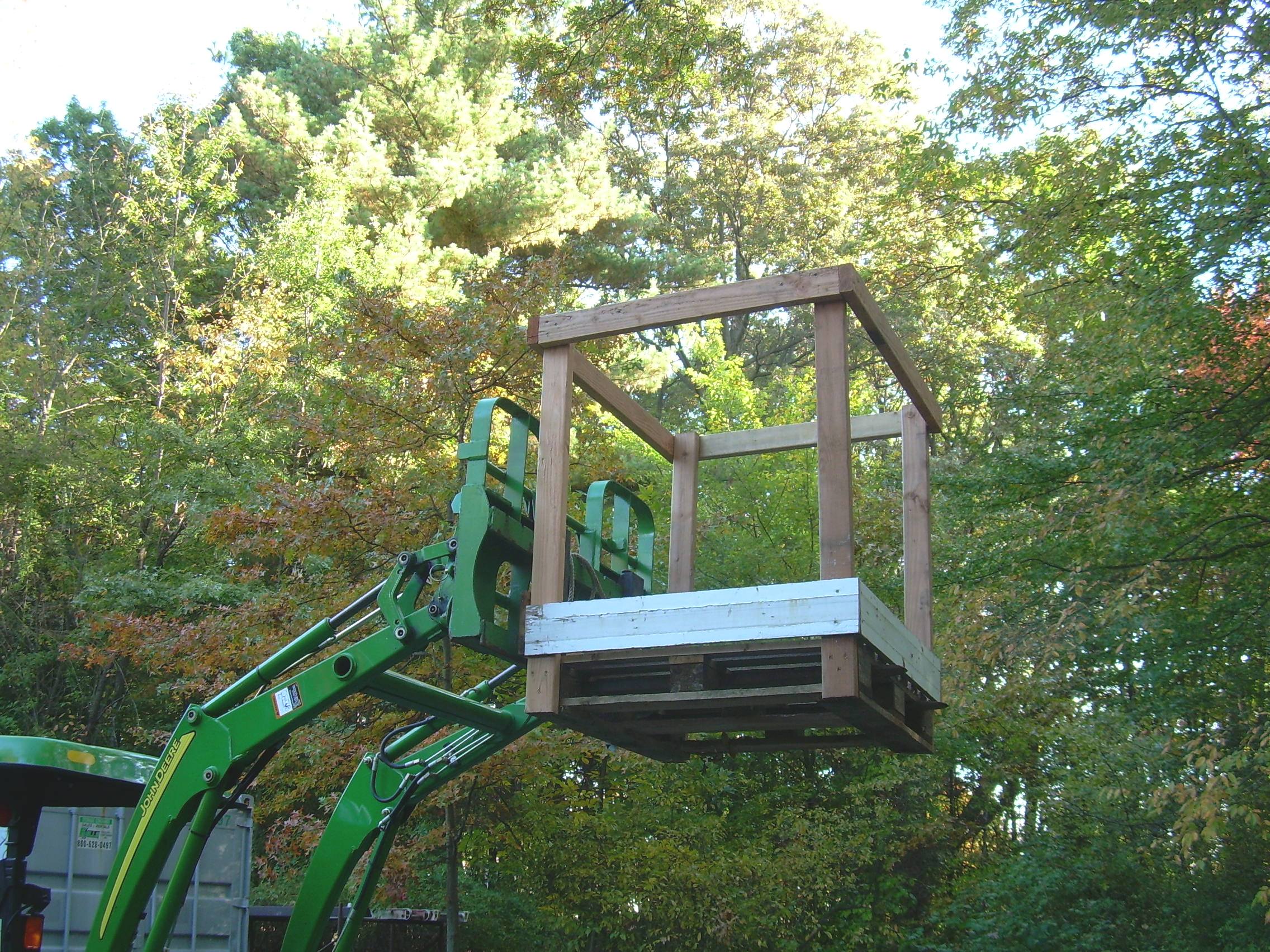

Mine drops noticeably in just a few minutes, maybe as much as half an inch in a minute or 2. I know because I use mine with a homemade man lift platform for trimming trees, cleaning gutters etc.
If I stay in one place to long we have to raise the bucket. I do this with 2 people. 1 in the seat and 1 on the platform.
This is with engine off, with engine running it is not as noticeable.
If it's not high enough drive the front tires up onto some wood, blocks, ramps etc. just make sure to ckok the wheels and set the parking brake.
To prevent bucket bleed down, if you're by yourself, you could prop the loader up with a 4x4 for support.
