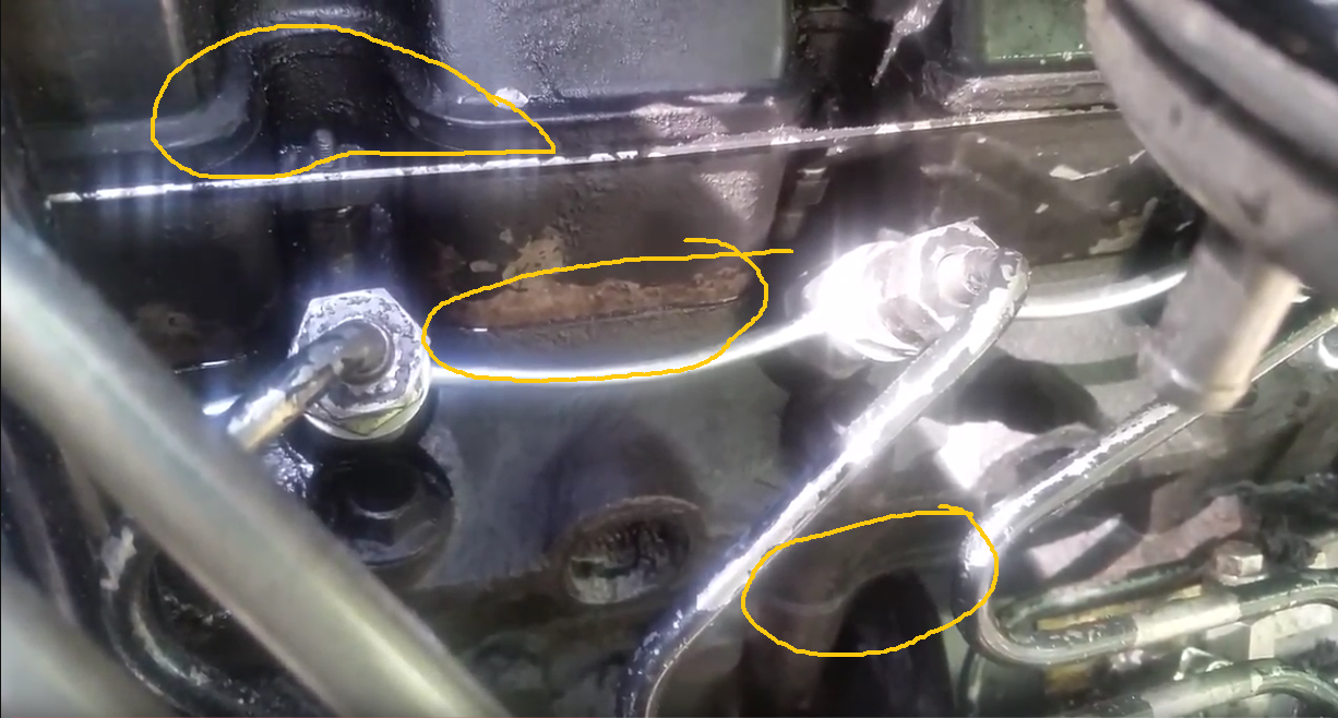

I'm confused- your video shows the injector and the "cylinder head" leak ABOVE it. But all the tractors I've owned or looked at had the injectors in the head. They kind of have to be as the injector fires at about TDC. (ok I could come up with a stepped piston that would allow the injector to be on the cylinder wall but it'd result in a poor combustion chamber shape. Or the head could be one piece like on a chain saw or early gas engines but that's hard to manufacture).
That joint doesn't look like the valve cover though I could be mistaken about that. Could the head be one of those two piece ones? Seems unlikely as that's normally done on DOHC heads not simple pushrod two valve ones.

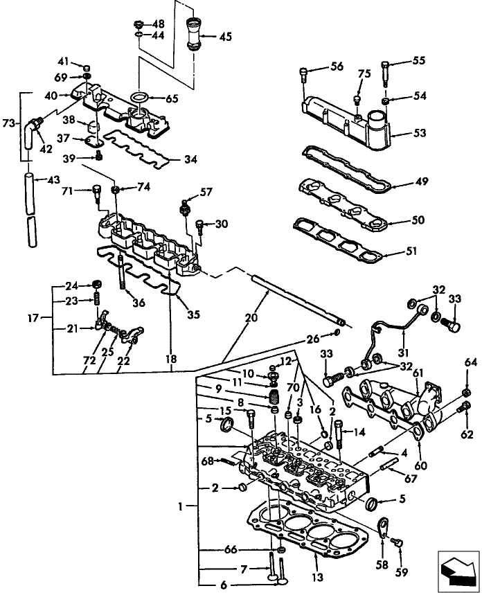

I hadn't looked at it, and didn't think about it, but I think it is a split head. *was tryin to explain it, but I think a picture is better served here :p *
I circled the sections of the motor from block-head, head-head, head-cover. I also included a picture of the head parts assembly. As you can see it is in 3 parts total for the head section.

eric: I'm actually glad you asked this question. I didn't realize the head was 2 sections. After thinking about it, the problem is probably not quite as severe as I had originally thought it might be. So, it's not a head gasket, in the traditional sense from a more familiar block-head gasket. It's between the two sections of the head.
So, with that enlightenment, could it be that the upper gasket is leaking oil down into the chamber through the valve or some other means? I'd like to try to figure out what I might be needing to look for before I start pulling the top of the motor apart. As the tractor is usable right now; so I don't want to shut it down and find something else is possibly wrong and have to wait longer to get it back up.

Dang, it is a two piece. The upper part is the rocker box. Your problem gasket is #35. It's just leaking to the outside, not the combustion chamber. The valves are already operating in oil. Often there's an oil seal on top of the valve guide (possibly its #8, it looks too short for a guide). Sometimes the tight clearance between the valve and valve guide is enough to keep most oil out of the combustion chamber. The oil in the rocker box is not under pressure and there's not a huge amount of it. I'd be leery of oil additives that plug leaks. What else do they plug?
It should be pretty easy to replace the #35 gasket though you'll need to loosen the valve adjusters before removing the rocker box and adjust the valves afterwards. You'll probably want to replace #34 too.
In any case I don't think the gasket weeping is causing the rough running problem.
