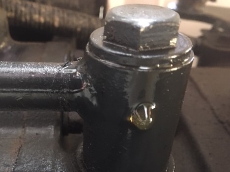

another perspective
   / leaking hydro coolant line 2009 CT 235
#12
I wondered if I could, I dont think I can tig well enough tho
#13
Now that I look at these on my computer screens, it almost looks like a bad weld, not real sure.
While I was under there, I was engineering a guard for this, if it is a bad weld, I wonder if it really needs a guard
I guess I will make the call on trying to weld it after I get a price on a new one

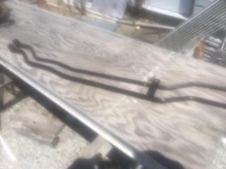

OK, so last week I went ahead and ordered a new tube, earlier in the week before I knew the tube was cracked I had ordered o rings and a banjo bolt, so that if anything went wrong in the o ring replacement I would have a new banjo bolt.
They told me while ordering the new oil tube that it had changed part numbers (which always makes me a tad nervous) apparently they re-enforced the end that had cracked and attached a hanger bracket on it, from what the parts guy said they must have had a problem with the old design.
The tube arrived this morning, I got a phone call at 7:57 AM that it was in.
I drove into have breakfast and then pick up the oil tube, and they gave me a tech sheet on the new hanger installation.
Well......
They never mentioned that to drill the frame for the new hanger that you have to drop the left loader mount pedestal because the bracket falls between the frame and the pedestal.
I was not prepared to drop that mount so as of now the hanger has not been fastened to the frame, but at least it is not leaking
I took some pictures but they turned out terrible, I will attach one to see how it looks. If anyone wants to see any more let me know
