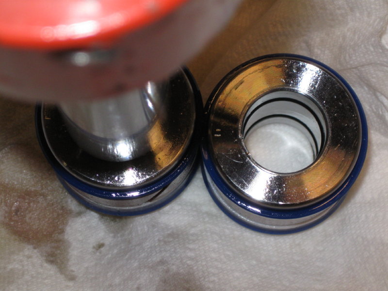

Yes, Hold the cylinder by the end eyelet in a vice. Level the cylinder with a block of wood near the end cap. The cap can stay on the rod. The cap may be 'stuck' in position on the end plug or it may be loose. Some penetrant on the end of the end cap wouldn't hurt. If the two pieces are stuck together the end plug unscrews with the end cap. Either way a little lite tapping and the two pieces should come apart.
Removing the piston from the end of the rod gives an unobstructed install of the inner seal. Otherwise you'll be dragging the seal all the way across the piston surface and if you nick the seal.....it's not a good thing.
I only have one picture of the rod, piston and the cap. You can see the inner O-rings on the one piston detached from the rod. I didn't change the inner O-rings and I don't know the size. Not the greatest picture, I attached it.
