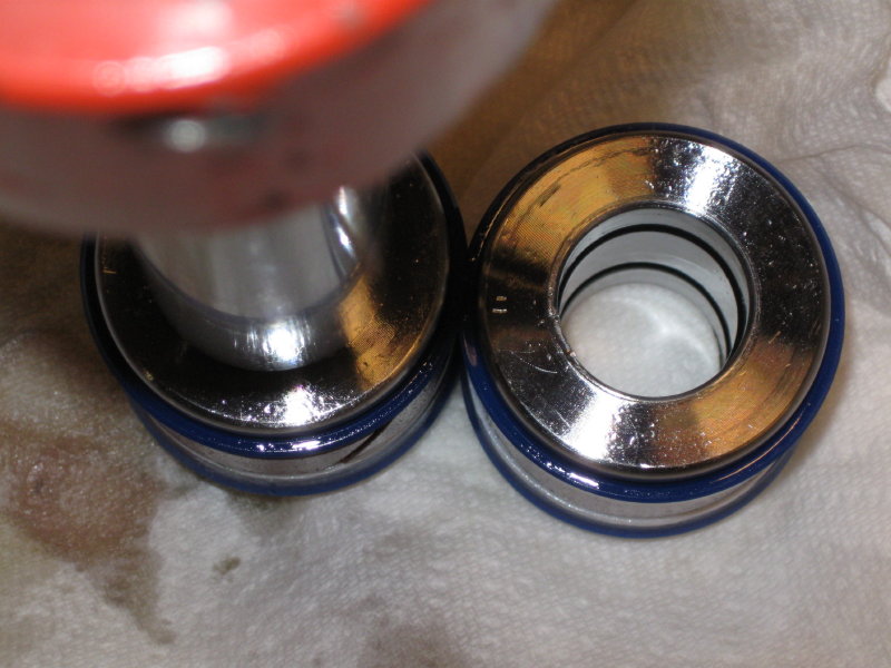

My tractor is about 4 - 4 1/2 years old, with around 320 hours, second set of curl cylinders. Both sets developed leakdown issues. So far, the new seals are a tremendous improvement. I can walk away from the tractor and come back later and not have the bucket contents dumped on the ground. :)
I would recommend squirting some penetrant on the cylinder threads ahead of time to aide in the cap removal. With the loader at rest gravity is our friend.

There is a hole on either side of the end cap. Here's three ways: For one time use, try a couple punches that are the same size as the holes in the end cap and try to spin the cap off. There is also a wrench called a 'spanner wrench'. The wrenches came in a set of three and cost me in the $50 range. I was successful using the spanner wrench on one of the cylinders. The second cylinder I did a better job at oblonging the hole out than anything else. Here's where the 3rd way came into play. A large pipe wrench removed the second cap. After reassembling the cylinders, I filed down the gouges from the pipe wrench teeth and repainted. Good to go.
The cap serves to hold everything together. The cap has no O-rings and is not meant to seal the cylinder. The plug that the rod slides through at the end of the cylinder under the cap has O-rings and forms the seal. Mine weren't leaking externally, I was careful handling when disassembling & reassembling and so far I'm good. I don't know the sizes for these O-rings. Start out with a clean work area. Dirt is the enemy.

Yes, Hold the cylinder by the end eyelet in a vice. Level the cylinder with a block of wood near the end cap. The cap can stay on the rod. The cap may be 'stuck' in position on the end plug or it may be loose. Some penetrant on the end of the end cap wouldn't hurt. If the two pieces are stuck together the end plug unscrews with the end cap. Either way a little lite tapping and the two pieces should come apart.
Removing the piston from the end of the rod gives an unobstructed install of the inner seal. Otherwise you'll be dragging the seal all the way across the piston surface and if you nick the seal.....it's not a good thing.
I only have one picture of the rod, piston and the cap. You can see the inner O-rings on the one piston detached from the rod. I didn't change the inner O-rings and I don't know the size. Not the greatest picture, I attached it.
Don

Remember to inspect the inside of the cylinders to make sure they are not scratched or gouged......
