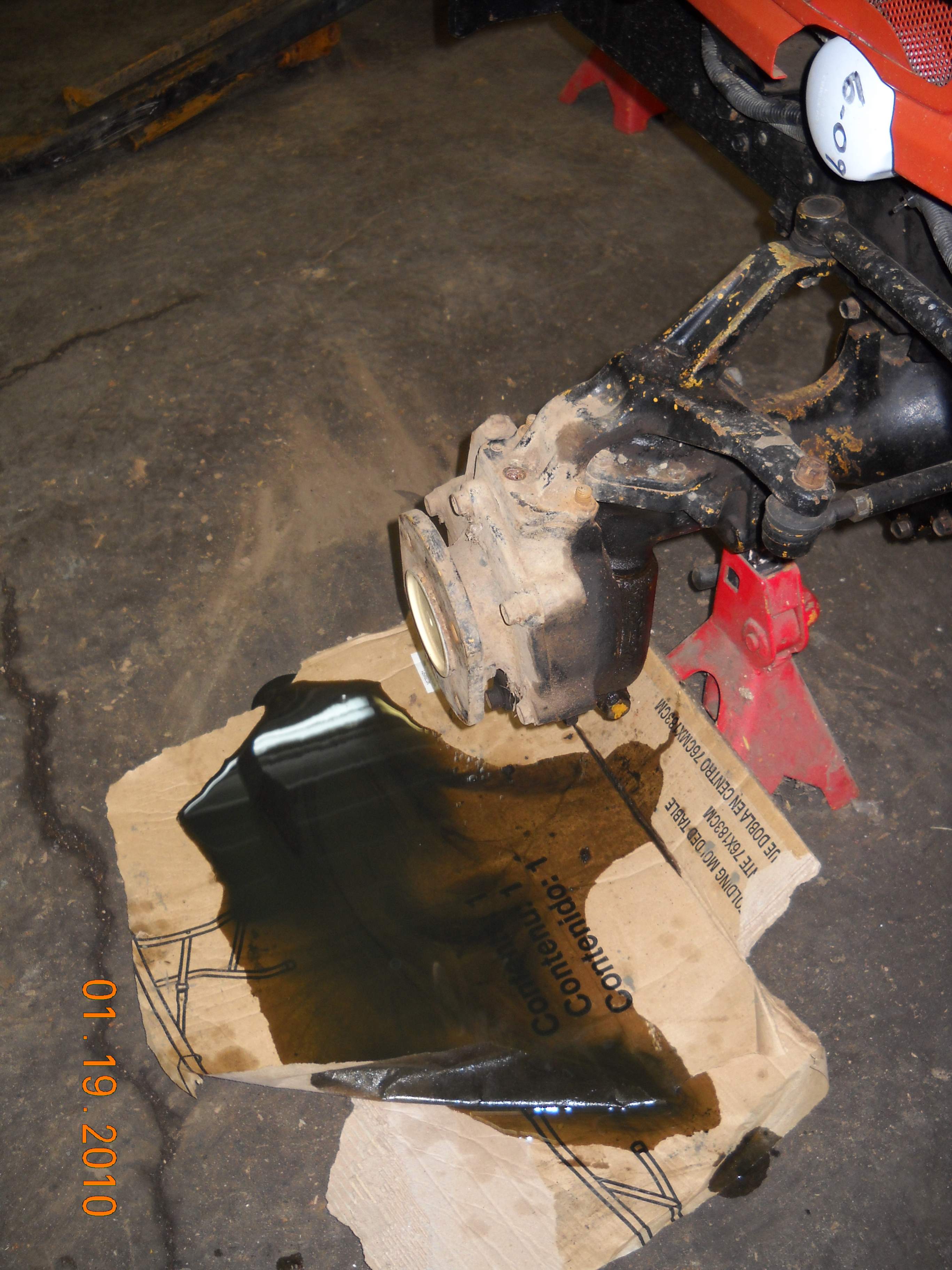

If your talking about what I'm thinking it is quite a thing to fix. Lucky I was able to locate a seal at John Deere but i know that all of the parts are not easily obtained for the front axle. Mine leaked a lot on our garage floor (concrete) and since I did not want to stain the floor I just decided to fix the leak at hand. If you do go ahead and fix it you should take your time, I spent a good 4 days working on it for about 2-3 hour intervals and since I had to locate some parts which turned weren't available so I had to use the old ones. Good luck on the fix! :)

On almost everyone I worked on the surface the seal mated to was worn. It is steel/cast. A new seal wasn't able to fix it without some work to that surface. It should be smooth and not have a groove where the seal mates. There is a repair part for seals to slide over the old surface. Has anyone found one for this seal? I cleaned the groove with solvent and wire brushed it. Then I took JB weld and built up the groove and then sanded it back down to smooth. As far as I know they are all still working. The grey market tractors were all used in volcanic soil that wore the surface bad. Yours is a US model. If the soil it was exposed to wasn't as abrasive as the volcanic, you might get by with just the seal.

I have changed both knuckle seals on my 2002d without a speedi sleeve and both have been holding over year. Wear area wasn't in bad shape. I don't know what seal you are talking about but there are many speedi sleeves available. For instance, I believe the 99452 speedi sleeve will work with a 115x140x15 seal used on a 1500. Word of caution, speedi sleeves are expensive.

You can't get grease anywhere near where it seals from the outside. It has a triple lip seal that is designed to keep dirt from getting to the sealing surface. That seal failing is what usually lets the inner seal get worn. If you take it down to grease it, you might as well fix it. The seals aren't that expensive.

I tried the stop-leak fix in my 240D and it slowed the leak but didn't stop it. Ordered the seals from Hoye and changed them out. Only took abut an hour and an extremely easy repair. Been a year now and no more issues.
