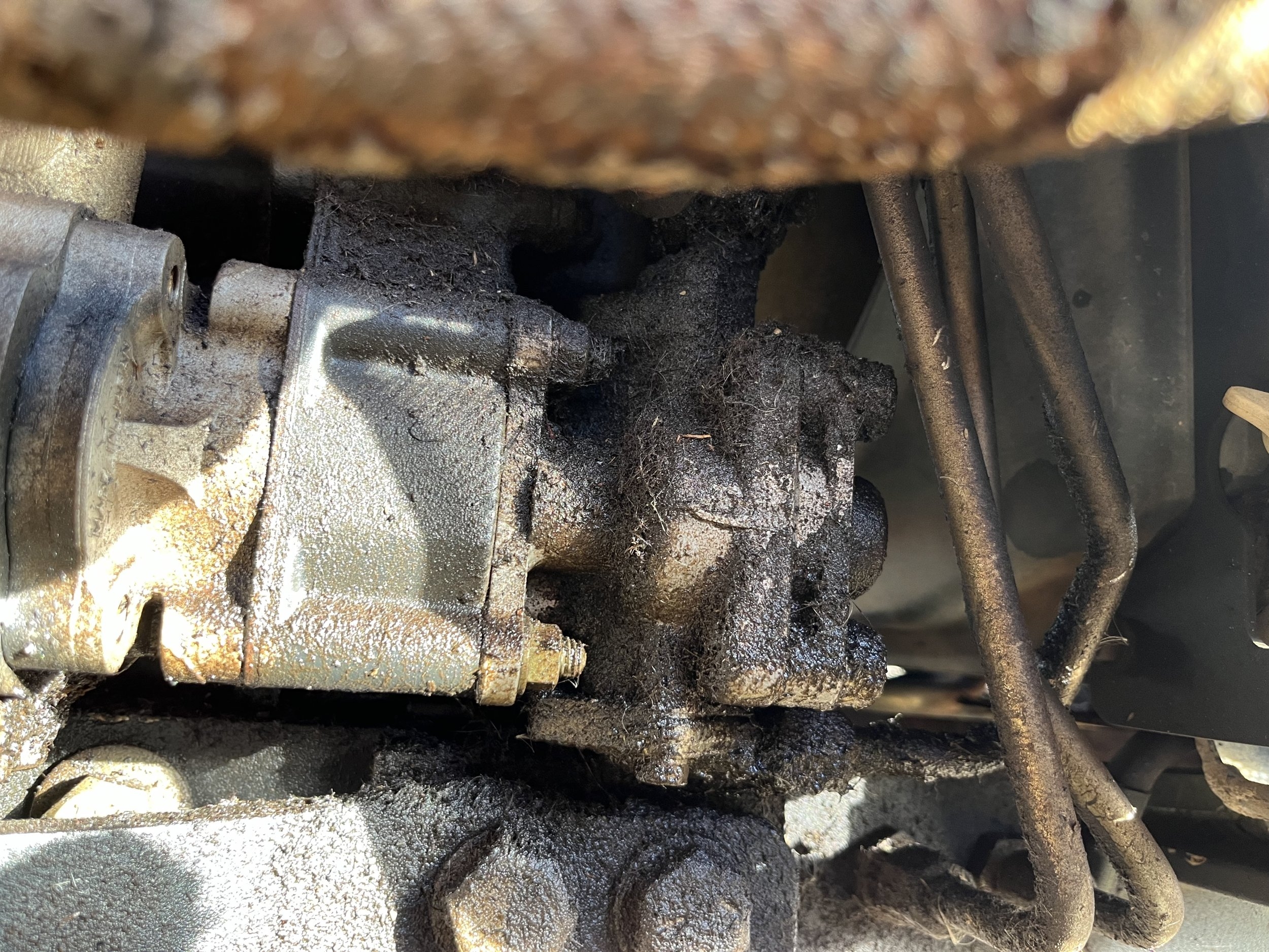

All, I noticed I my TC45DA is leaking/weeping hydraulic fluid.
It looks like it’s leaking where the hydraulic pump bolts to the front cover of the engine and it’s not engine oil.
Is there a chance that the hydraulic pump is just loos and that tightening the bolts will slow or stop the flow?
I will post a picture tomorrow.

Here’s a picture of the leak.

If the pump shaft seal that is a "double lip seal with spring" is leaking then no tightening will help out. I would worry about jumping out and start tightening things. Pump case tightening has very little to do with the seal. If it were my rig, I would then clean the area to the best of my ability. I would turn the tractor on and push the pump a bit by manipulating either 3 point or loader bucket just a bit passed max to cause the pressure relief to pop. I would only do it for a few lil seconds.Put a card board under and keep checking. one thing to remember pump shaft seal leakage will go to the timing gear cover and you may not be able to see that clearly. I would just not hurry, losing a bit of hyd fluid may be manageable. Make sure to check hyd fluid reservoir level by checking the dipstick.

What you pictured is not a shaft seal leak, and that's not your hydraulic pump. It's the steering pump. Whatever you do with the hydraulics (other than steering) won't influence that leak at all.
