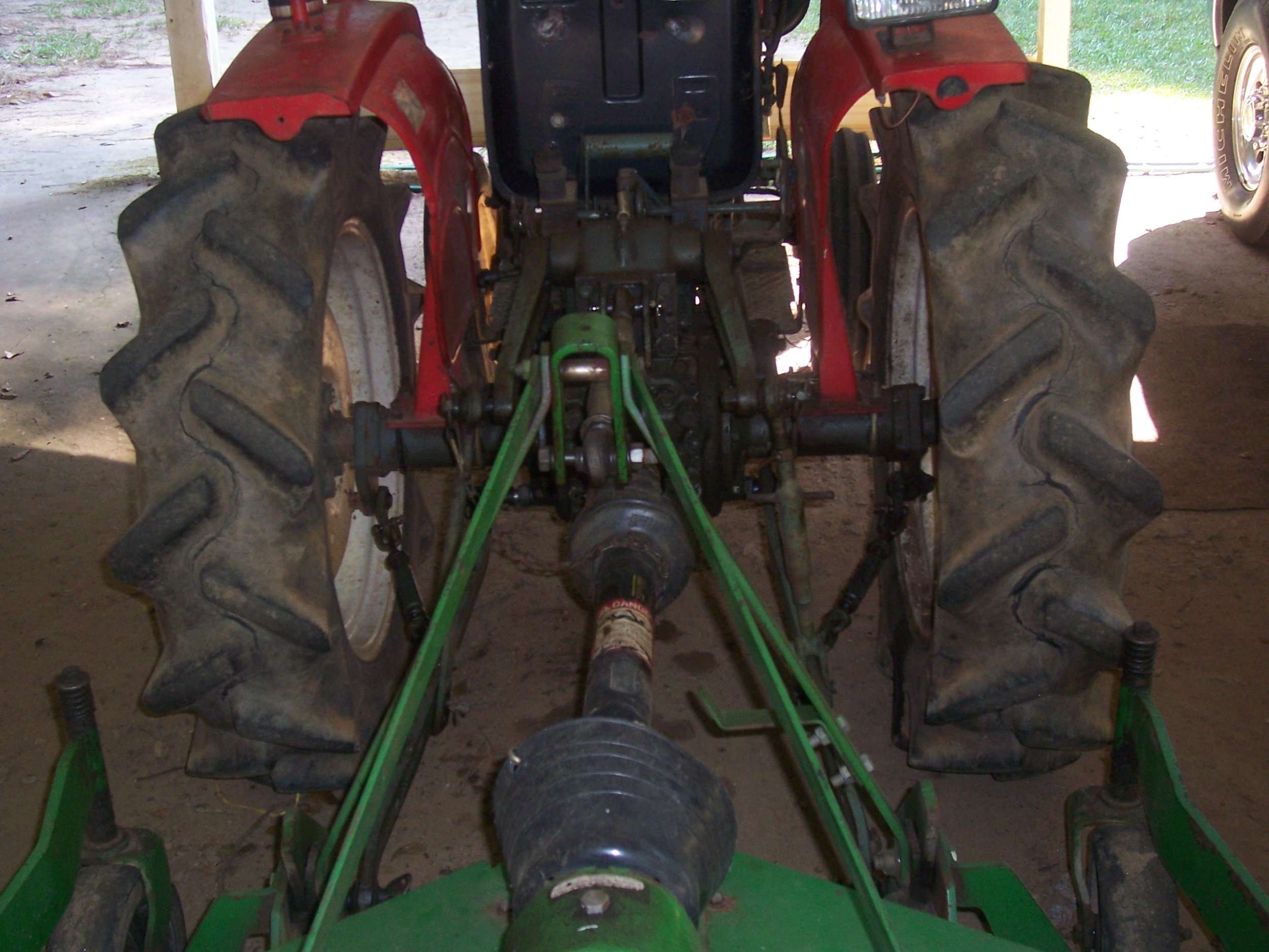

2015 Full tire ;) 150.00 Shop remounted them. Not the first complaint. Sidewall also!

You only have to break the bead for a tube which in turn all you need to do to insert the Reliner. Both tires Shop installed them Nylon Puncture resistant Have I missed anything. Oh there going to last decades Forever! Tire shop do a tube. That's a roll over Spec... Don't even have to remove the wheel. Only reason I'm 1 arm and handed and took them to do it Simple.

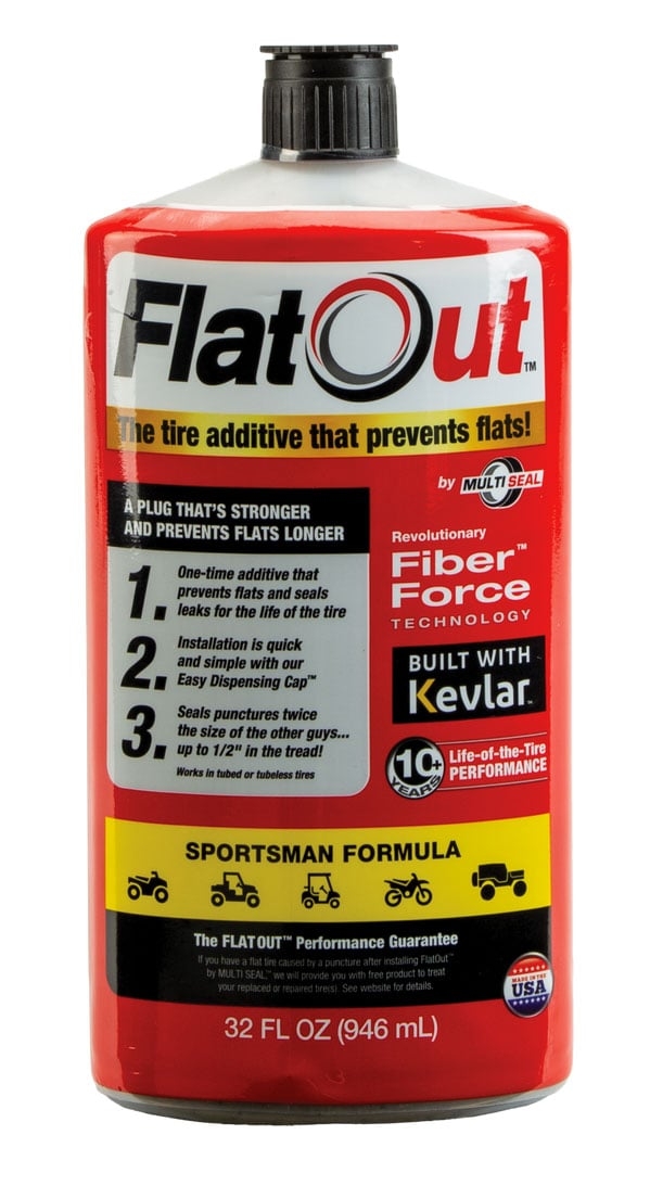

For my Yanmar tires, I'm using FlatOut by Multi-Seal. It is liquid Kevlar. MIL standard and non-flammable. Simple formula and no mess.

The Kevlar fibers will repair a side wall hole. It takes a bit of work as the tire needs to be laid on its side. I know, already done this due to the Locust tree thorn punctures in the side wall.

any tricks to this? i followed the instructions to the letter but cannot squeeze bottle hard enough to get any sealant to enter the tire .the schrader valve is out but only air will come out nothing will go in .almost as though there is a check valve in the valve stem. i mean shouldn't the valve stem be completely open into the rim ? should the bottle be vented somehow ? never seen anything like it !
Did you remove the valve from the valve stem, and deflate the tire? Usually, I've been able to use the tire to suck the sealant in by getting air out and then vacuuming in the sealant. If you did and it still isn't going in, try a ratchet strap around the circumference of the tire (on the tread), then compress it with the ratchet, connect the squeeze bottle and release.

The trick I do is this,
- Shake the FlatOut container.
- With the FlatOut squeeze until the fill tube is full, but not leaking out.
- Position the valve stem near the ground.
- For a tire I can sit on and it will flatten, connect the FlatOut tube.
- Now squeeze the FlatOut bottle and rise off the tire. This will cause the fluid to enter the tire.
- Put the schrader valve back in the valve stem.
For a common CUT front tractor tire, 1/4 to 1/2 a bottle of fluid.
Add about 10psi of air to the tire.
Take the tire for a rolling walk.
Not fast but where the hole(s) might be.
Rock and roll the fluid in the areas of the hole(s) where gravity works to your advantage and the hole is at the bottom.
For side walls, lay the tire on the ground and rock and roll the fluid toward the hole(s) to fill those voids.
Once the tire hole(s) are filled, let the tire sit for about 2 hours. Every now and then rock the tire. Monitor the psi. Keep it about 10psi. You want the Kevlar fibers to bond and lock with each other. At the end of the 2 hours, inflate to the full psi. Listen for any leaks. A little more rocking and rolling.
Now, I'm very cautious with any of the tire seals on the market. I've been disappointed in some until I did this last trick. With the tire now at full psi, do not place it on the tractor until 24hrs has pass. Its up to you if you want to wait 24hrs or not. I tend to error on the side of complete success vs thinking its good to go, run the tractor awhile, park it and the next day the tire is flat! ugh.
