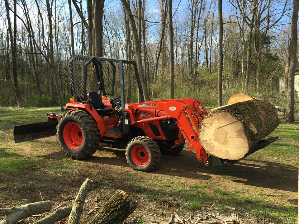

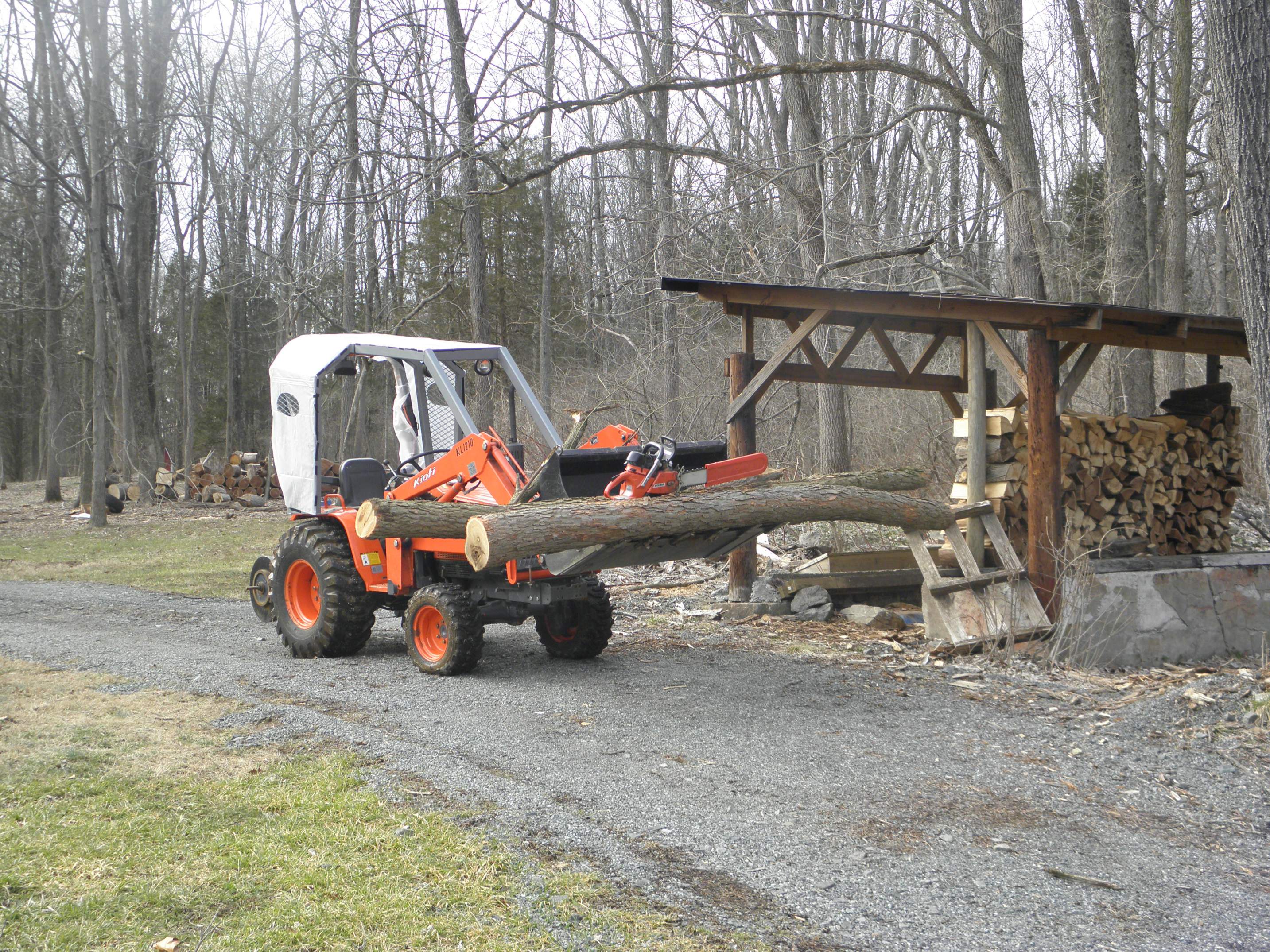

   / Leaning toward Kubota B2601-- what else should I consider? #20
* moving fallen/cut trees - How big of a piece of wood do you need to lift or drag?
* clearing brush - Is the brush loose or do you need to uproot it. some brush is tough and a "B" wont have the weight or lift to uproot all brush.
* moving dirt, compost, and soiled animal bedding - A "B" would be fine.
* towing things (mobile animal shelters) - how heavy (trailer weight and tongue weight), on flat ground or hilly?
* clearing snow - any tractor can clear snow (so can a shovel). It depends on how fast you expect it to clear snow and how deep in one shot. But I think a B is plenty adequate for most personal snow clearing tasks.
Below are the kinds of logs a "B" could probably carry around (this isn't a B but it is a similar size Kioti LB1914)
A "B" would not be able to lift the log in the next picture at all. You would have to cut this in about 18" long slabs to carry it with a "B". Tractor in picture is 45hp with a strong loader.
