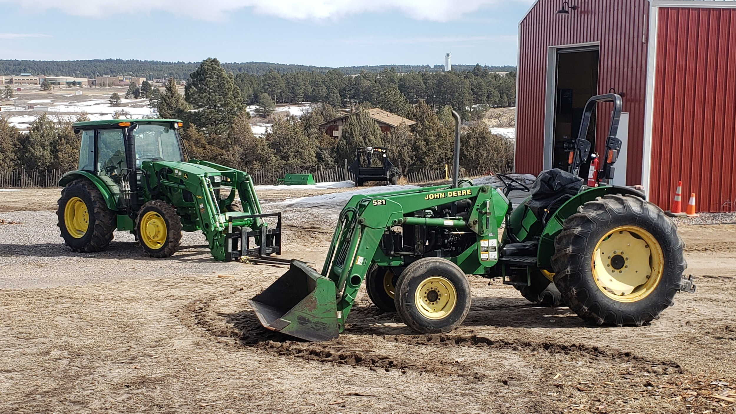

I've had the 5055E for about nine months now. I really like it so far. Of course, a cab heat/AC, and radio is always an improvement. We've had a pretty snowy winter, so it was nice to have.
The back end is a bit light for the heavy duty loader. If I keep the box blade on the back, it helps quite a bit. I also want to move the tires out a bit.
I've been fixing up the 5105 as well. It's usable now, but I still need a hood.

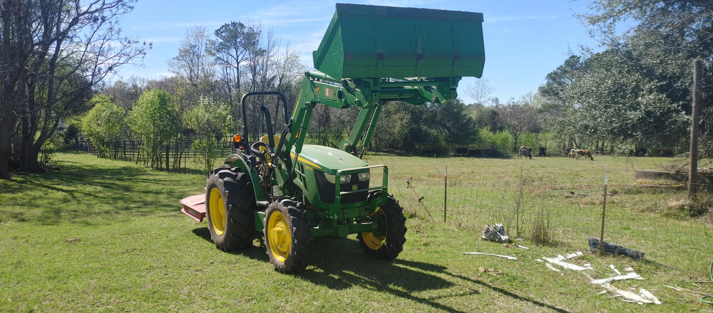

Seems everyone is always comparing the differences between the E and the M in the Deere 5 series which is for the most part weight, most of which comes from a heavier rear end in the M. I have a 5115m with a 540R loader , very well built heavy duty tractor that I’ve been happy with. I don’t see many comparisons between the 3cyl and 4cyl in the 5E series.
Last fall I was in the market for a OOS 4wd loader tractor in the 70-80 hp range . I was looking for a late model very low houred 5075E . Spent a lot of time searching tractor house/ marketbook and expanded my search to include 5085E/5090E . I noticed a lot of upgrades that came with the jump from 5075E to the 5085/5090E for not much more money on the low houred used market.
Upgrades I found that came standard with the jump from 3cyl to 4cyl 5E’s; much bigger 4.5L intercooled engine vs 2.9L non intercooled in the 5075E, Much heavier front axle (basically same front axle as my 5115m) , two sets of SCV’ s standard (only one set standard on 5075E) , about 25% more hydraulic flow standard, 12x12 power reverser wet clutch transmission standard, bigger front and rear tires standard, larger fuel capacity standard, longer wheelbase with the 4cyl yet a foot tighter turning radius than the 3cyl, heavier capacity drawbar standard and higher output alternator standard.
All these upgrades along with 10 more Hp for very little difference in price and I started to concentrate on finding a 5085/5090E . Ended up finding a 2018 5085E with 540m loader and 73” HD bucket, only 14 hrs on it. For my needs it was the right choice.
