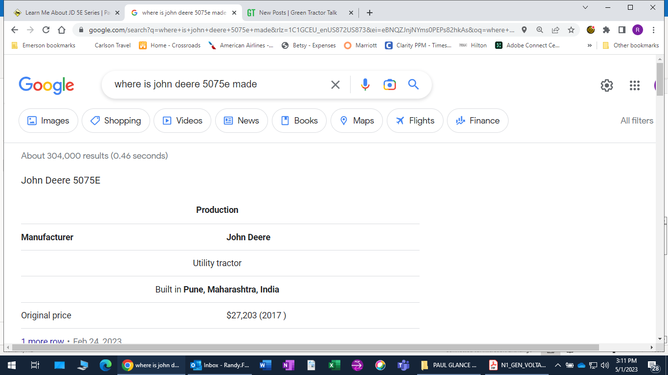

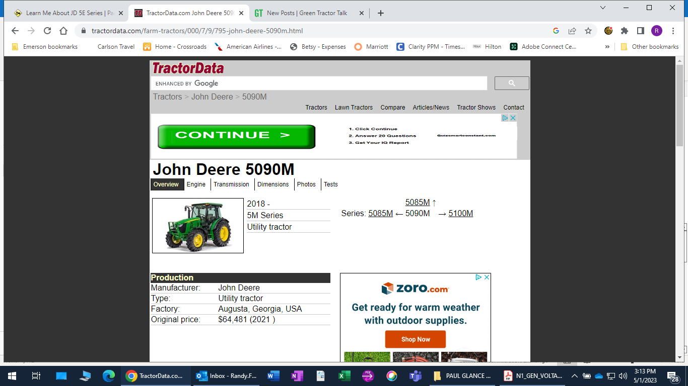

The 5Ms are now also built entirely in India as of the FY23 refresh according to Deere's website. The larger 5Es are now assembled in Saltillo, Mexico, I assume using Indian components, while the smaller ones are still assembled in Georgia.
