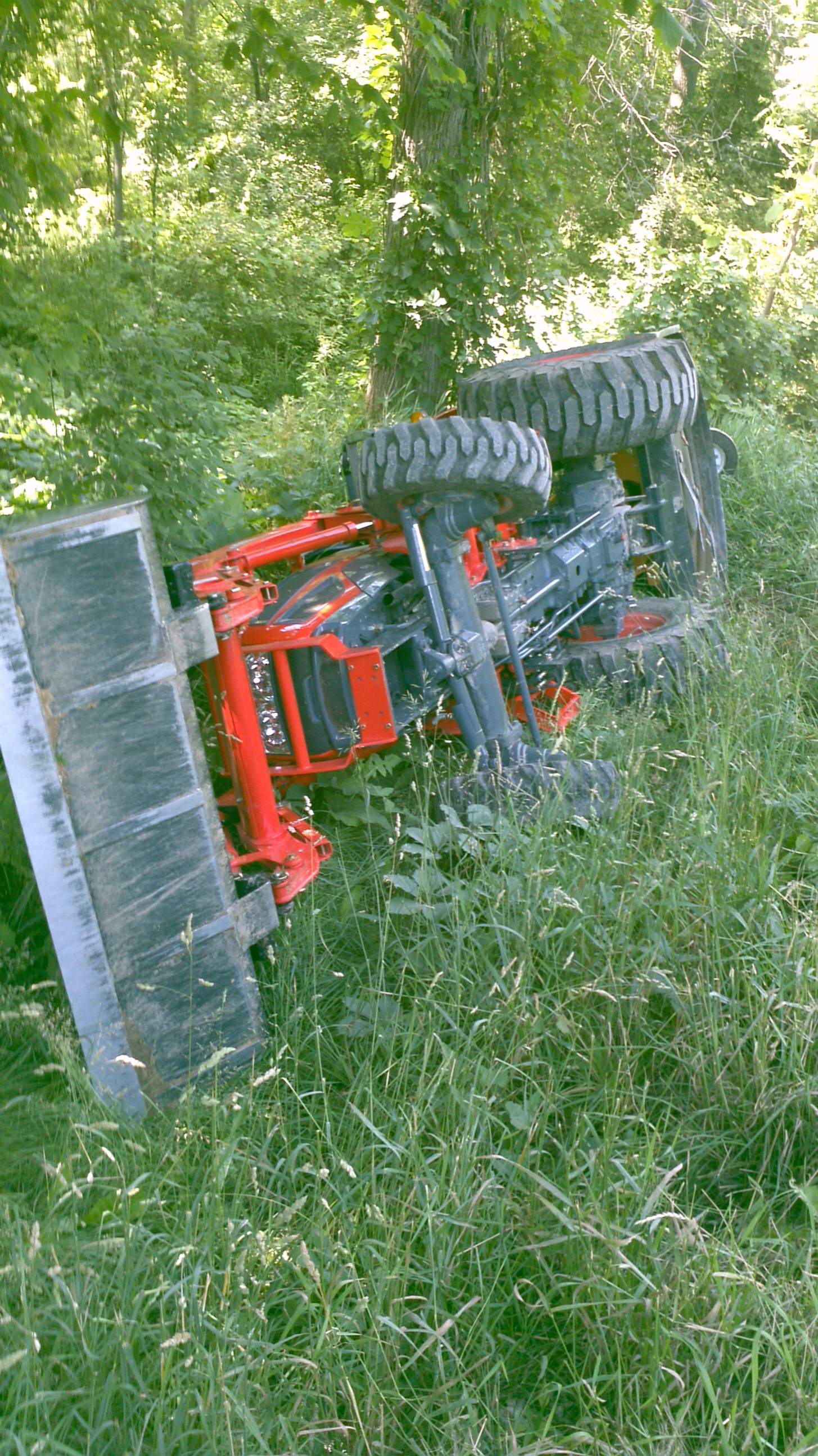

Just glad your ok! I dont even put my loader on unless I have a massive counter weight. My loader saved my butt this past friday....

My closest call came while hauling a log on pallet forks on the FEL. It was about 20 feet long so it stuck out to the sides pretty far. I had to climb out of an old creek channel where I was building my pond and to make it up the bank I had to pick up the FEL higher than usual while hauling something that long/heavy. The tractor got overbalanced to one side and started going over. Luckily, I always keep my hand on the loader control and immediately dumped/lowered the FEL.
I always keep my hand on the joystick for such situations.

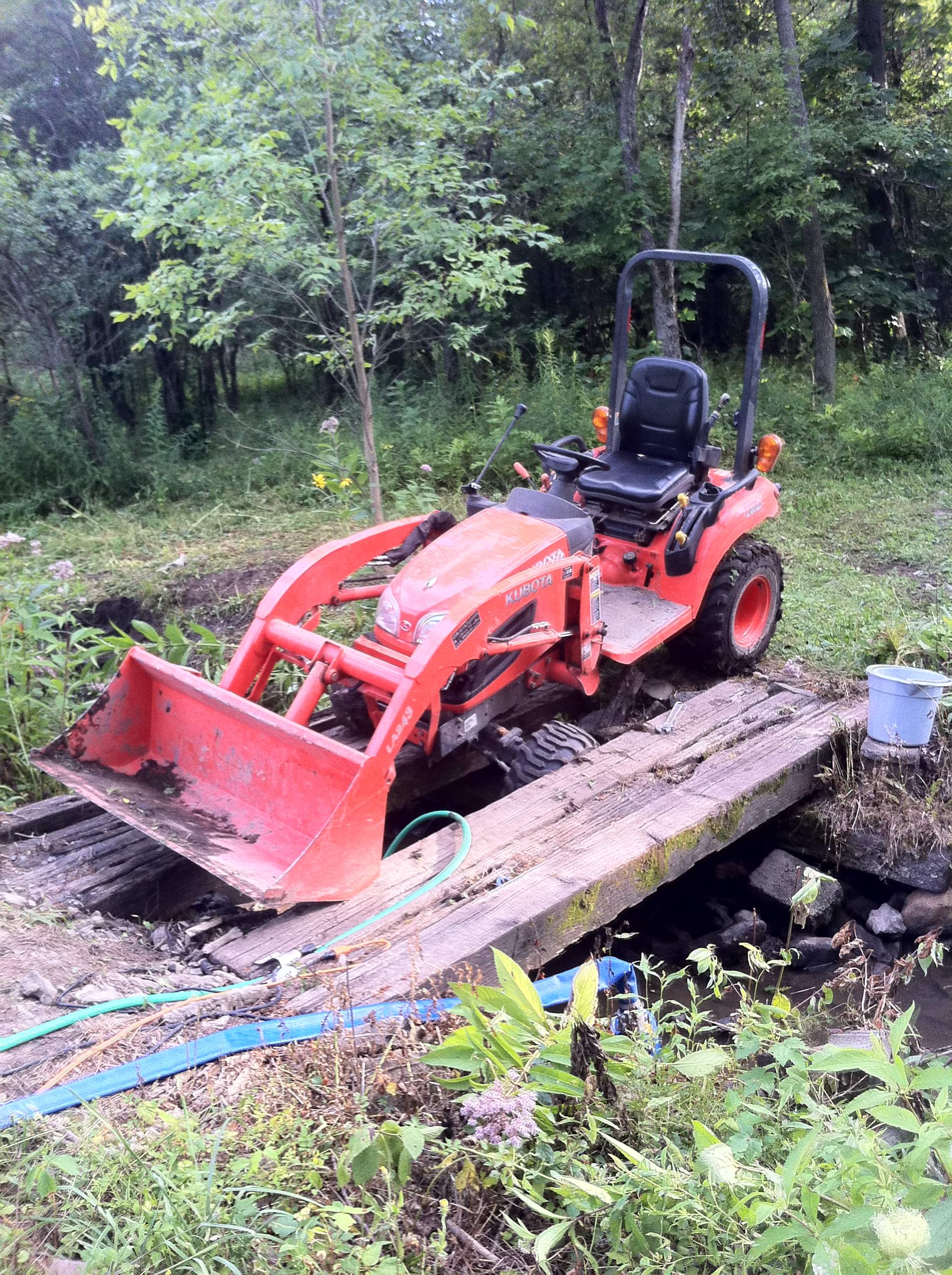

Wow.... good save! I had a similar incident loading my tractor onto a trailer. Board floor gave way to one of the front wheels. Without the loader, It would have surely been catastrophic.

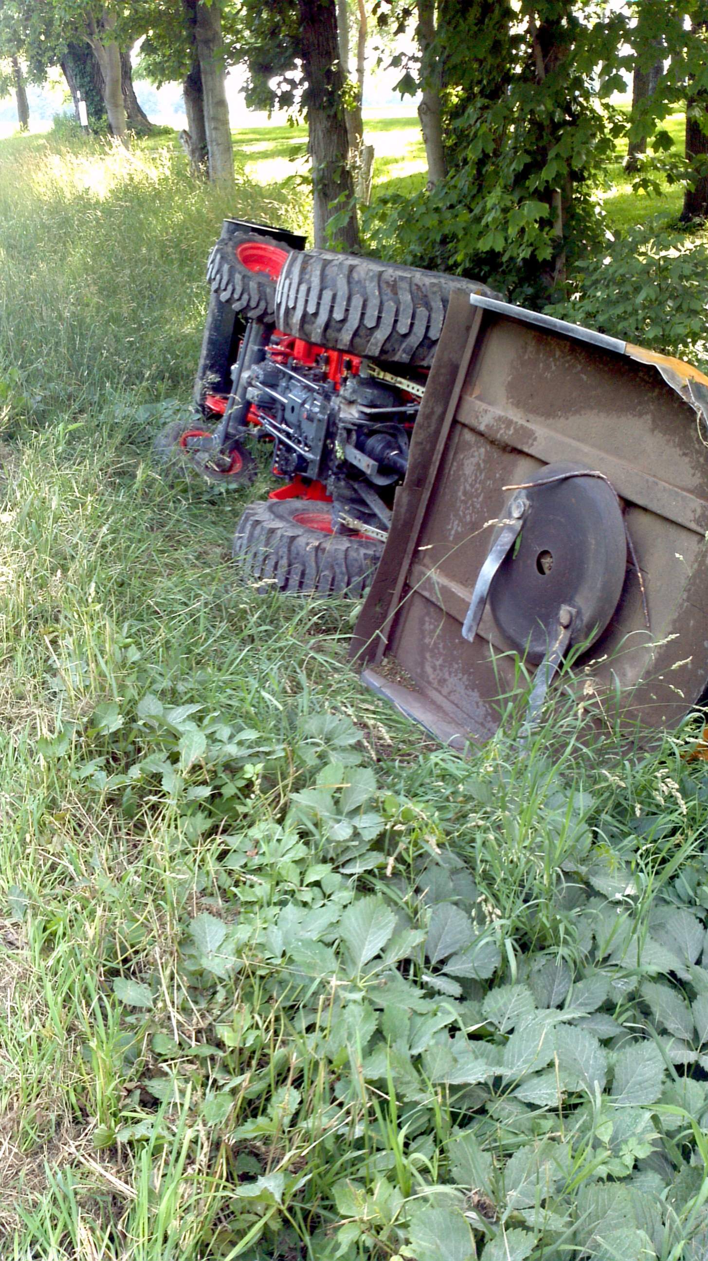

It is somewhat embarrassing to admit this, but I nearly rolled over my still new b2320. I went out right after heavy rain to move a pile of dirt. The ground was soaking wet and after moving a few buckets, a slight rut developed on the right side of the tractor... Right where the back wheel is. I did not have my backhoe attached so the tractor was light. In a split second while backing away from the pile with a full bucket, the tractor rolled right after biting the rut. There was no time to react... I could not believe how quick and easy it is roll this thing. What saved me is kind of funny.... While the tractor was rolling to the right my shorts got caught on the loader control stick.... Somehow my pants pulled the lever down and the bucked dropped quickly.... I sat there maybe for 10 minutes going over and over what just happened. I guess I am lucky to say that I was saved by the seam of my pants. Lesson learned: I will not lift stuff without a backhoe for added weight and stability. A weight box or filled tires will also be considered.
Did both wheels on one side come off the ground or just the rear tire off the ground? While a little unnerving the first time, lifting one back wheel, even quite a bit, isn't necessarily that dangerous (front axle pivots only so far). When you get it up on the side on two wheels that is scary.
