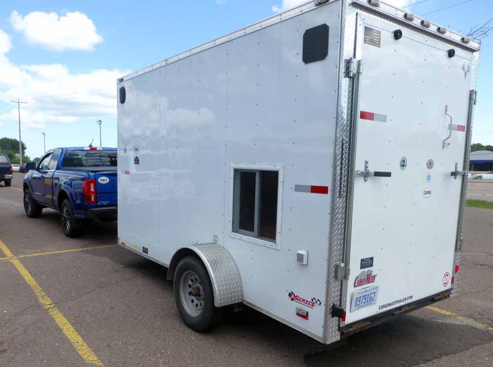

Then you haven’t backed anything but a flat bed or small boat trailer. Slap a camper on behind you or back a semi trailer without the ability to turn around and look out the back. You won’t use that method again. I guess what we are all missing is are you backing on roads you can’t see the traffic behind you. In that case, don’t get into that position to start with. The next I will add to my last post is, don’t even attempt a curve until you can back straight. Curves can definitely be done with mirrors but try to make the road as straight as you can. In other words, put the tire on your drivers side on the inside of the first curve and as soon as you start around it, start catching up to the trailer. This is where you would use the other mirror. Put the right side trailer tire right on the edge of the road. You can see that in your mirror. There is Mitch more to curves than this but you don’t need to worry about that until you know what happens to correct a trailer backing in a straight line. Once that becomes second nature you are ready for a curve. It’s easier than you think. Try to always start backing using your side, side (drivers) mirror if possible.
Like this?

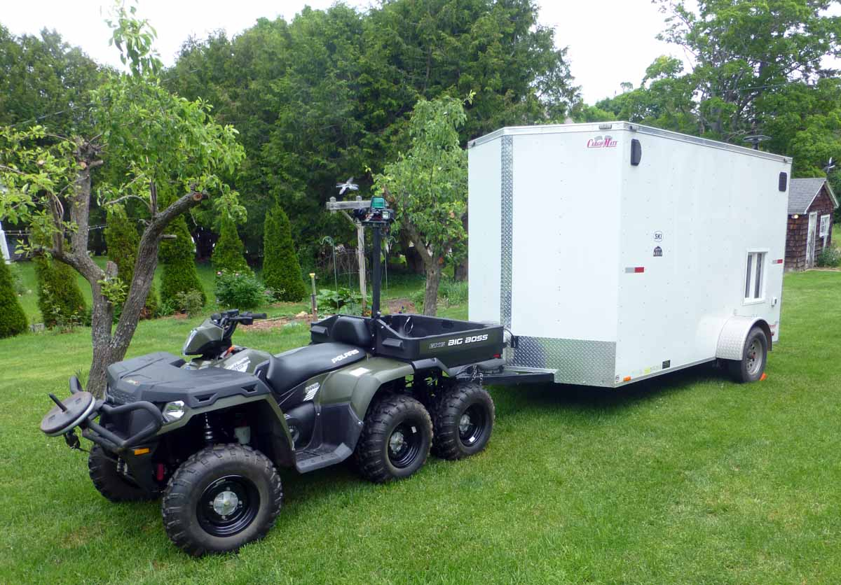

If you have a garden tractor or a compact one, could you practice with that? I find backing with our atv to be much easier than a truck. Point is to practice with something that is easier. View attachment 788197
Right, but that atv costs more than my truck! ;)
And, with a short wheelbase on my CanAm 330 and a log splitter with no 'steering wheel' to 'center' your hand on . . .
