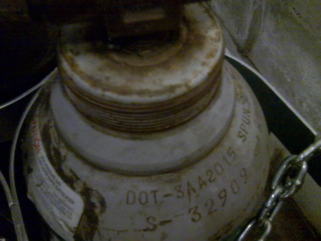

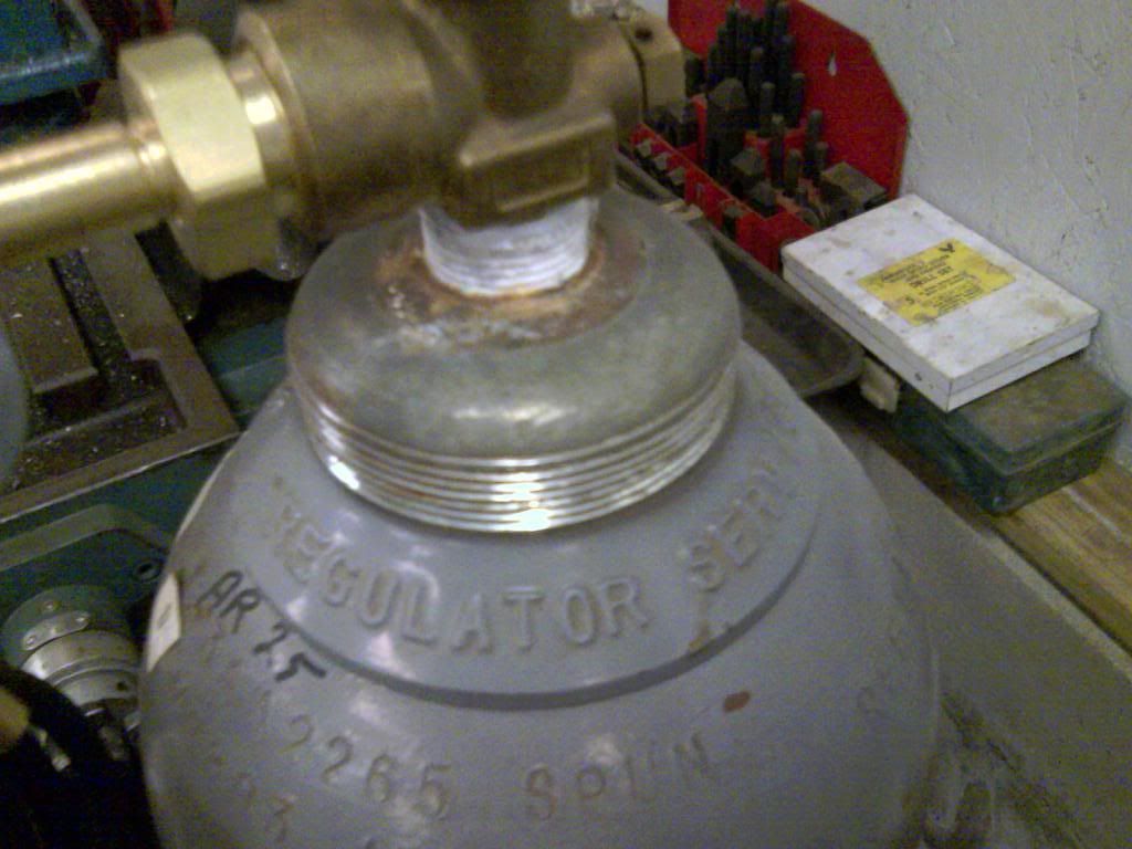

if you look at the ring just below the valve you can see that the top picture has a smooth raised ring. the lower picture has a name stamped into it. this is what people are talking about when they describe the top of the tank. the smooth one is an owned tank and the named tank is leased.
i acquired the smooth tank as part of a private sale deal when i bought a welder. it is a 60cf tank, and i went to three welding supply stores in a 30 mile radius and every one had no issue setting me up with a customer owned bottle swap deal. each one pretty much said that tanks that size are generally customer owned, and they have no issues with filling them.

Lostcause - THANK YOU! That is exactly what I was looking for. The Oxy tank that I saw had "Union Carbide" stamped where yours says "Regulator Service" (or whatever it fully reads). This is what I suspected it would look like, but was never sure without someone showing me just what you did!

Just because it has or does not have a company name on the ring isn't a sure thing the bottle is a lease or a customer owned tank. The only time I am sure it always applies is when it has the name" Customer owned" stamped into the ring. (ie raised letters). The size plus the ring and the prefix of the serial number of the bottle are all factors.
