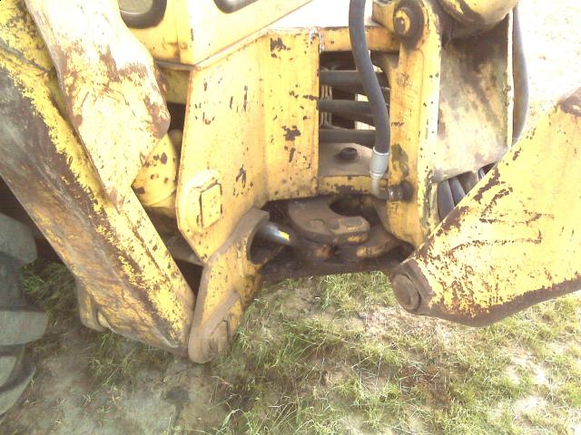

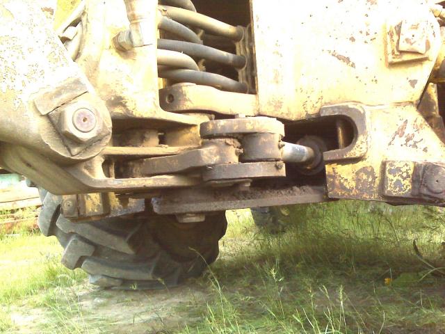

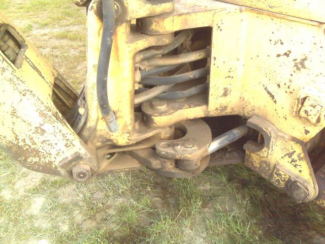

Bingrank....How does your 655d swing???
And does anyone know about the 555's, did they still use the swing chain like the 4500 that came before it??
If I had to say anything bad about fords at all, it would be how the "engineered" the swing. On my 5500, just to connect the cylinders to the swing post, there is a total of about 8 pins, and probably about 25 or 30 bushings. NOT a good design IMO, cause just a little wear in each bushing adds up to a bunch of slop at the end of a 20' or so reach.
I think the case and deere's of the era used a cylinder pinned direct to the swing post, and not a bunch of linkages like mine. And dads 4500 has the chain, which is either really expensive, or really time consuming if you make your own chain...

That must be nice. IIRC, the 655 was somewhere in the middle. The 5500 basically became the 755, and the 4500-555, and the 655 was smaller than the 755 but bigger than the 555.
I'll have to see if I can get (or find) a picture of how complicated my is. And I dont really see the advantage...
/ Least complicated used loader backhoe #26
These arent my pics, but I found them and you can see how complicated the swing is on the 5500. And I believe the 750/755 is identical...
View attachment 327923View attachment 327924View attachment 327925
