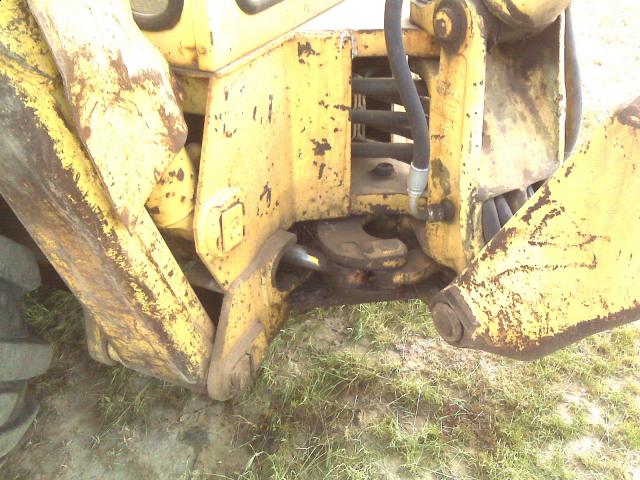

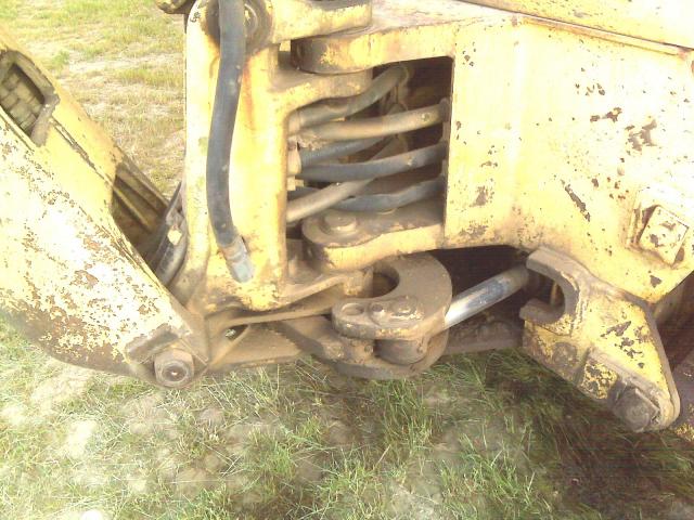

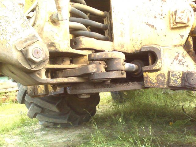

If I had to say anything bad about fords at all, it would be how the "engineered" the swing. On my 5500, just to connect the cylinders to the swing post, there is a total of about 8 pins, and probably about 25 or 30 bushings. NOT a good design IMO, cause just a little wear in each bushing adds up to a bunch of slop at the end of a 20' or so reach.
I think the case and deere's of the era used a cylinder pinned direct to the swing post, and not a bunch of linkages like mine. And dads 4500 has the chain, which is either really expensive, or really time consuming if you make your own chain...

These arent my pics, but I found them and you can see how complicated the swing is on the 5500. And I believe the 750/755 is identical...

Wow, D & E series, and I thick C was not like that, much simpler. One thing mechanics told me was if getting an A series I believe to make sure the torque converter was updated, been awhile, not positive.
I've run the E series and the newer model New Hollands and it seems like the D series was built more like a tank and not so much plastic. I really like my 655D and it had a hard life before I got it.
Had the main hyd pump out a couple times, pump driveshaft, radiator, injection pump did some valve work, seemed really simple. The engine has SAE fasteners and the backhoe, made in Belguim is metric.
