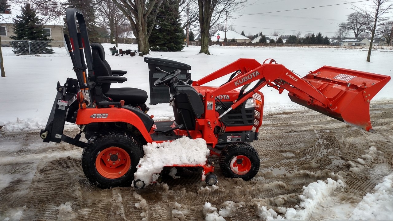

I leave the MMM on my BX2230 when I push snow, neever had a problem with it. I just clean the snow off it before I put it back in the shop.
