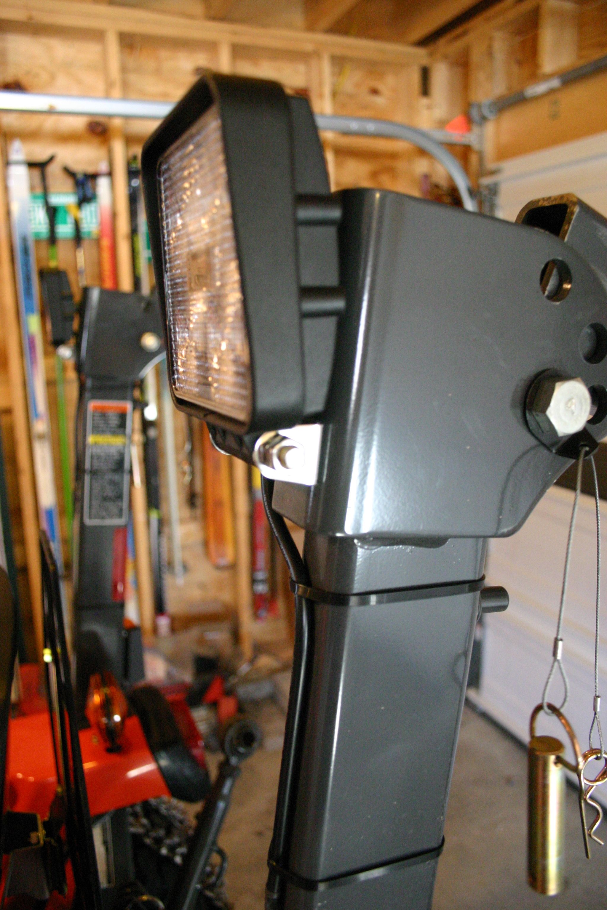

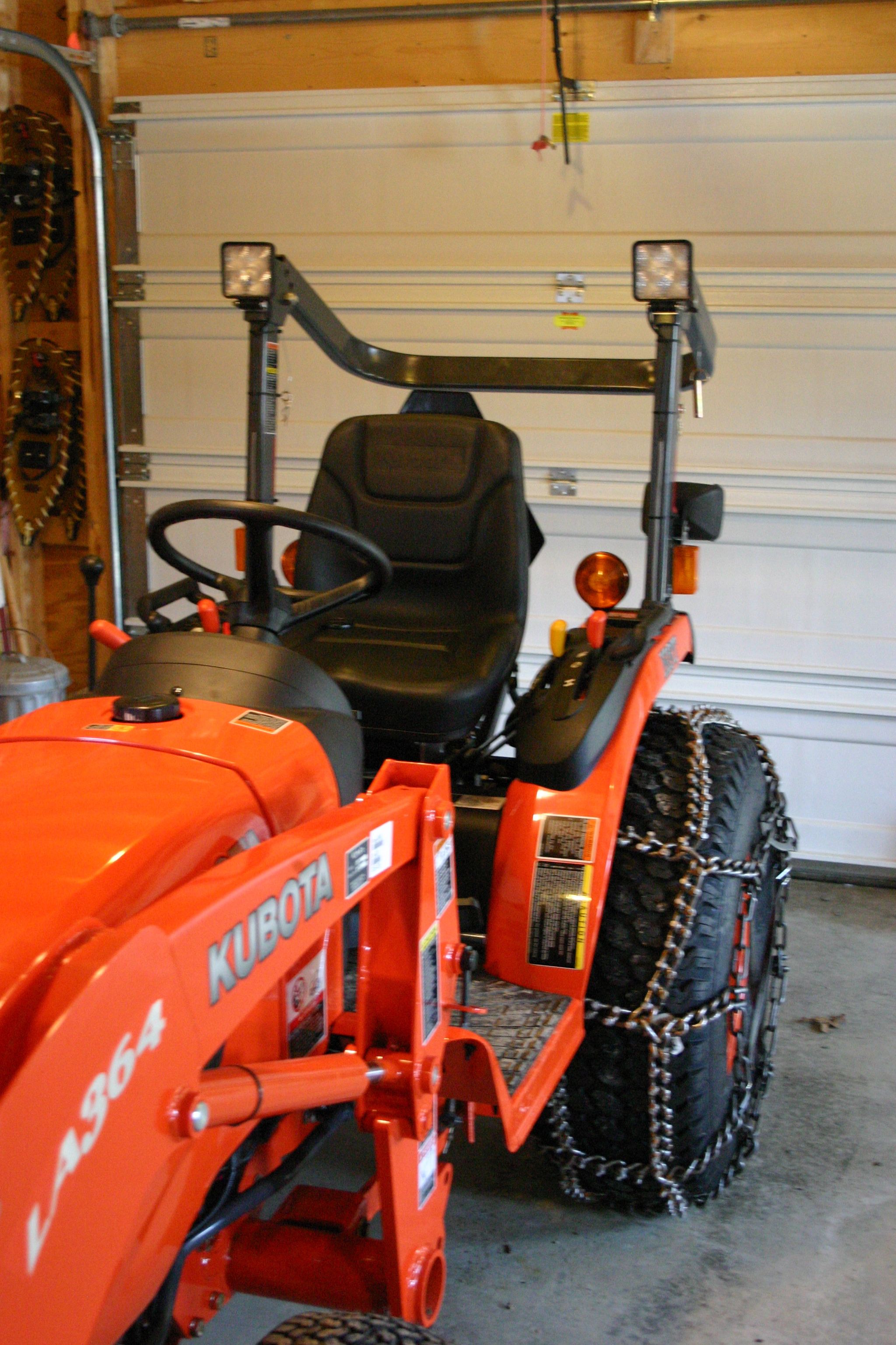

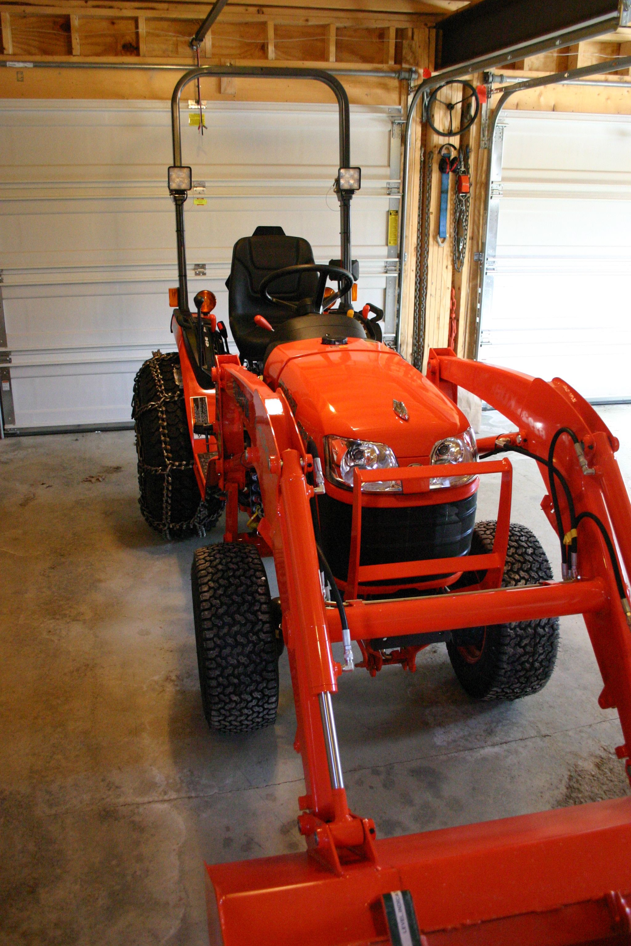

For what it's worth, here they are installed. What I liked about the square ones was the way they were perfectly sized for the ROPS - in that they weren't vulnerable to damage by sticking out to the side and I could still fold the ROPS.

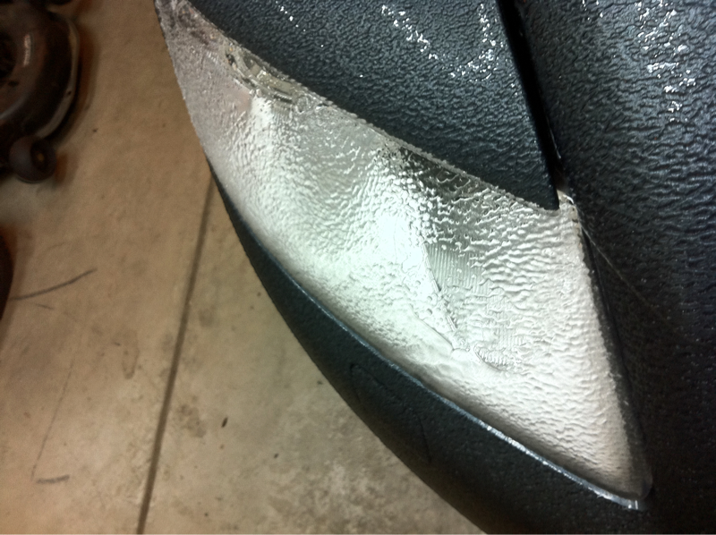

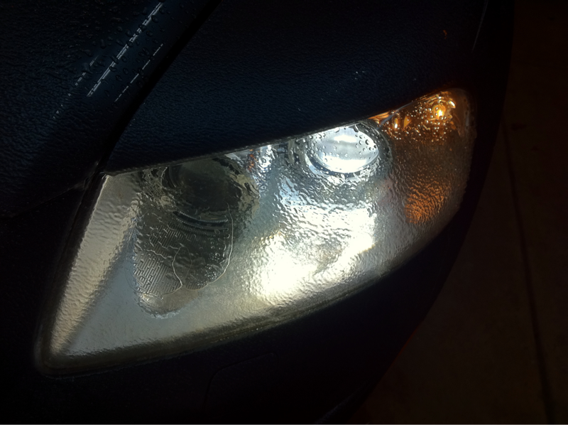

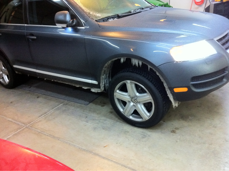

On my VW, the low beam headlamps are HID with the high beam being Incan, when we have an ice storm a couple months backs, I noticed ice build up in front of HID low beam bulb but the heat from the temporary use of high beam Incan melted the ice.
