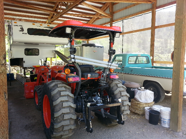

I put a Sun shade and some 27 watt LED lights on my tractor today. <img src="http://www.tractorbynet.com/forums/files/customization/421503-led-light-questions-forumrunner_20150418_203443-png"/>
Nice. That will come in handy and I like the old truck to.
/ LED light questions. #63
Nice, just the same as the ones I have, what a difference in lighting, why don't you mount two more for the front.
I have two more and I was thinking of doing that just in front of the ones that are there, but I wasn't sure if I would like all the light coming from behind me. I thought I would turn the ones I have around and try it first. If I don't like them there I will have to come up with a way of mounting them on the front of the Sun Shade, I think just under the front lip.
I have 4 total on my ROPS, two facing forward. I have no issues with them behind and above me. Kind of helps light up the sides a bit too. Sure beats lights mounted on the hood that are always partially blocked by the FEL.
