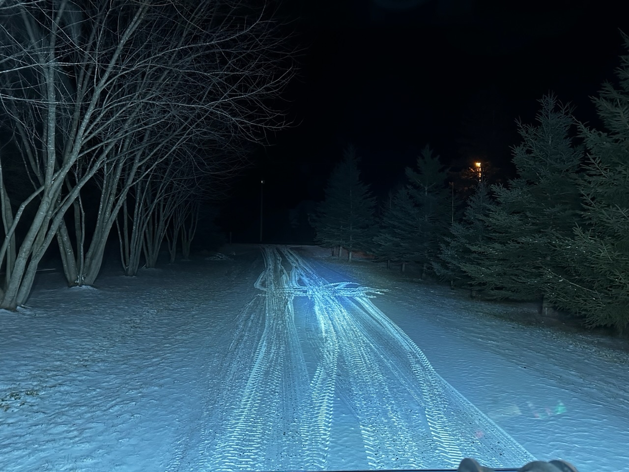

Decided to make use of this no snow time to finally go ahead with upgrading to some of the lights to LED kits. I had some burnt bulbs and a damaged housing already and found some pretty good Black Friday deals down at Princess Auto.

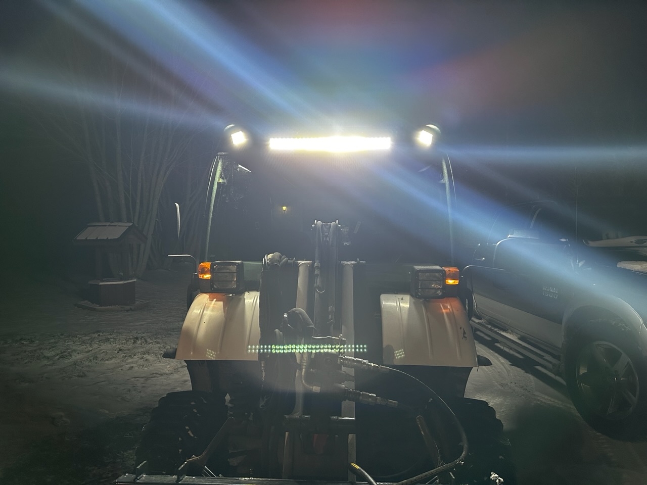

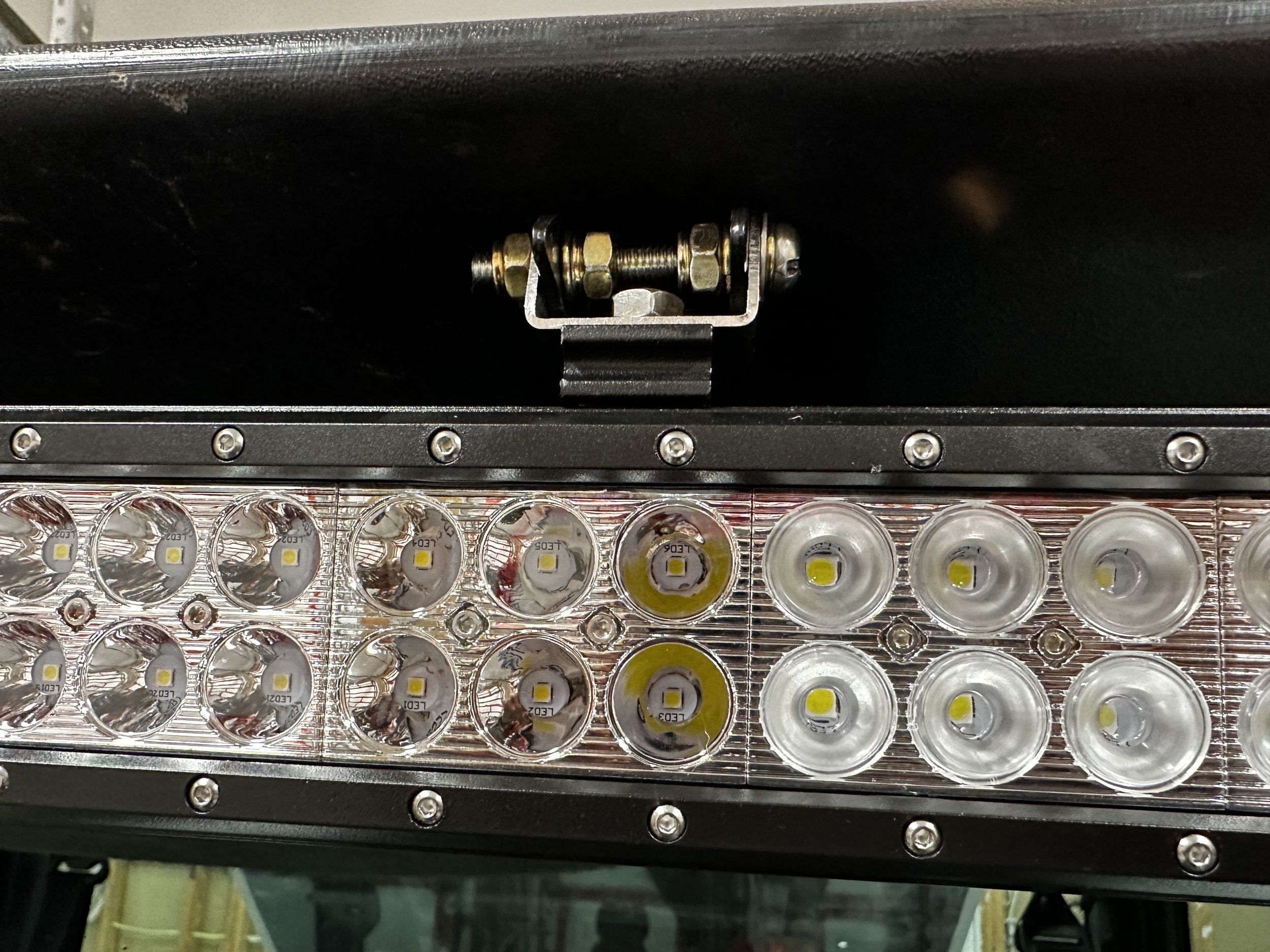

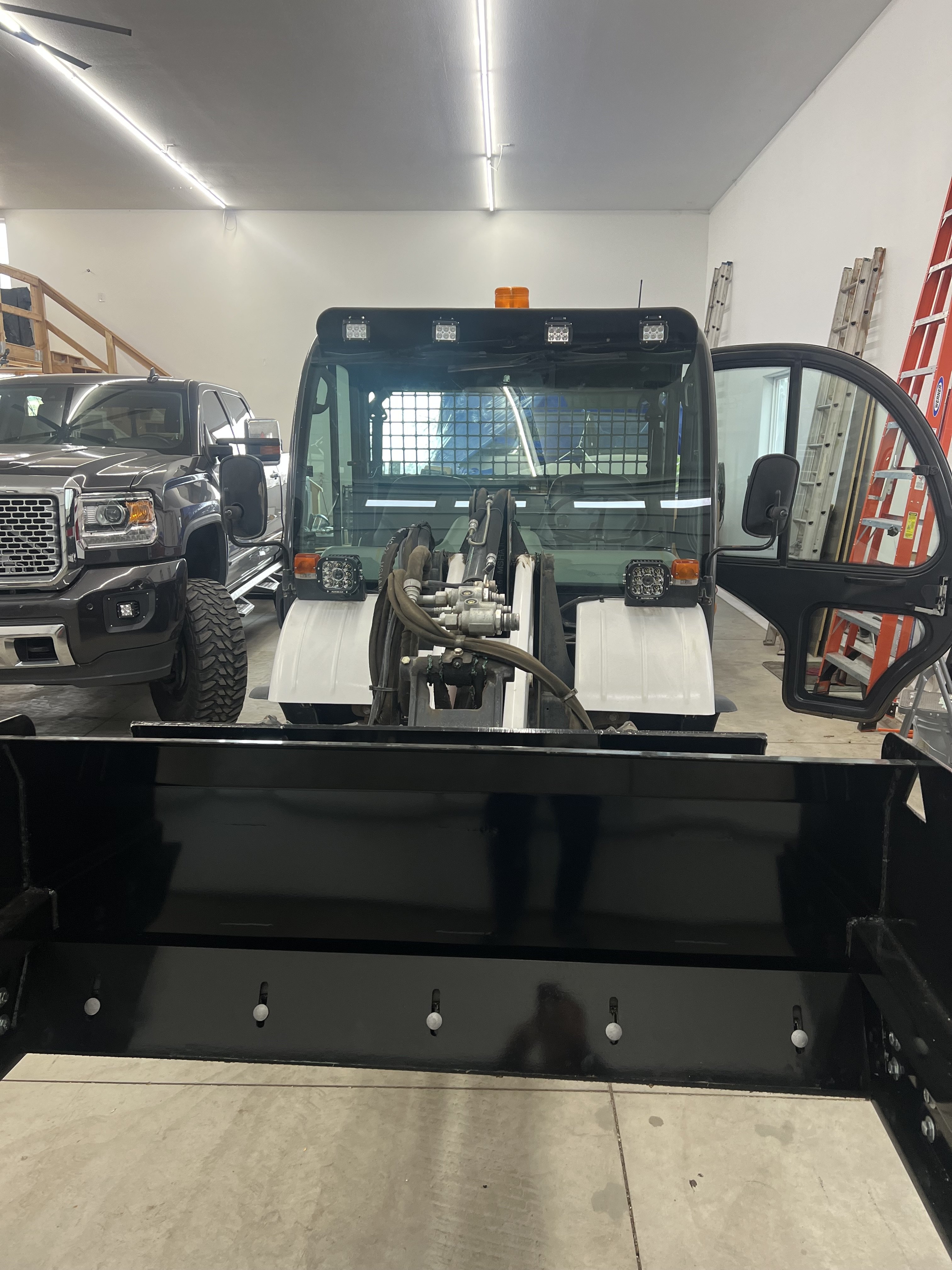

I ended up going with a light bar across the front and 2 flood lights rotated outwards to help with the spread:
I managed to use the original hangers with a bit of tinkering to help keep everything away from the windshield. Using use the supplied light bar mounts resulted in the wipers colliding with the light bar:

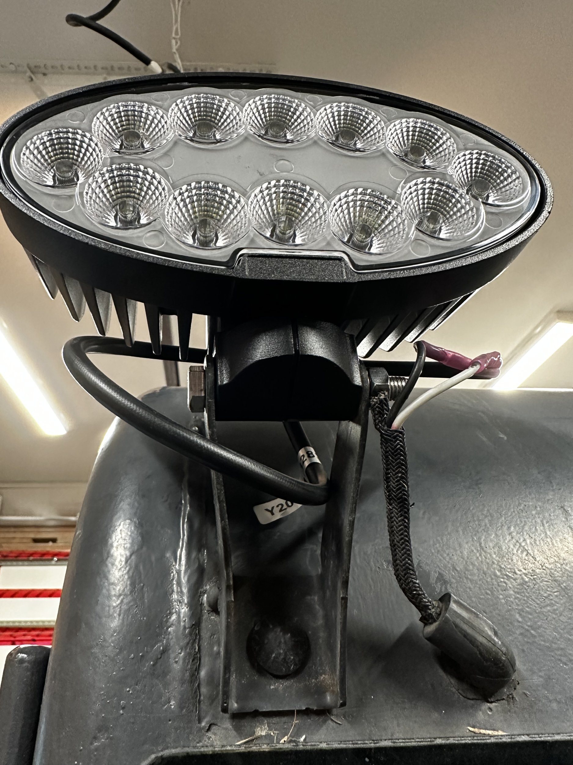

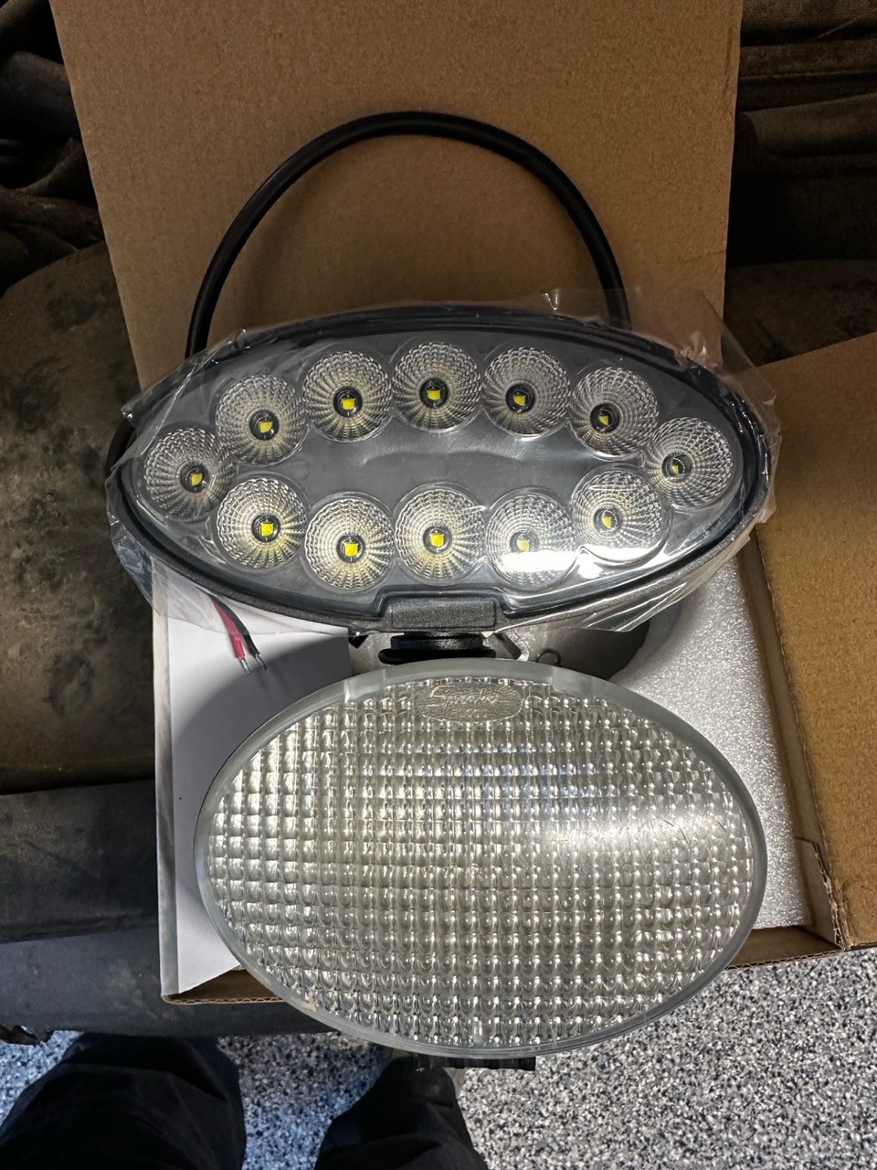

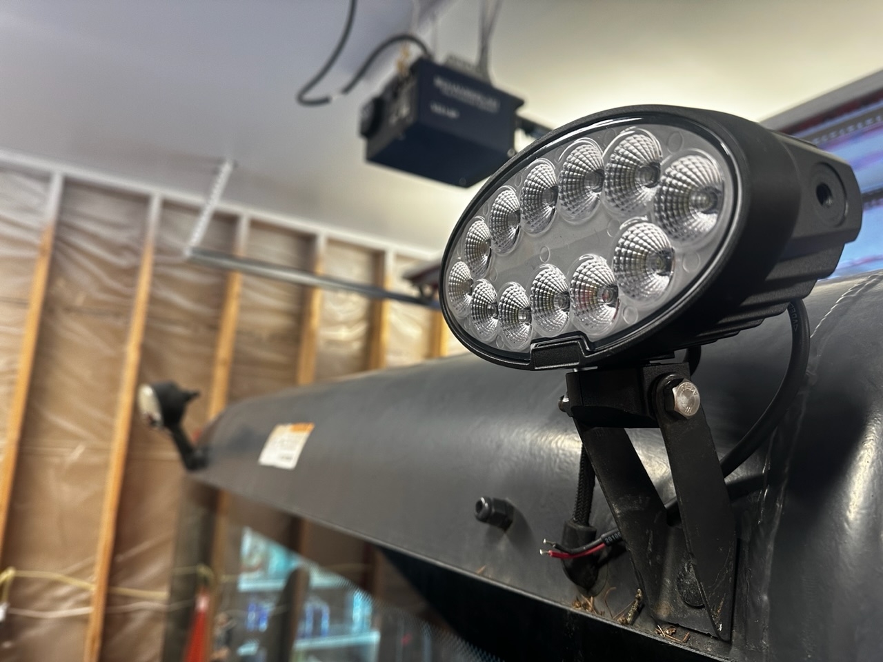

In the rear I went with 2 large flood lights and they were pretty similar in size. Managed to fit those into the original mounts as well:
For the connections, I decided to remove the connectors and go with marine grade splices. I thought about going with removable connections - but decided to go as water tight as possible instead:
The results are even better than I had hoped. I’m out in the country and had often wished for better lighting. Safe to say I wish I had done this years ago.
Front Before:
Front After:

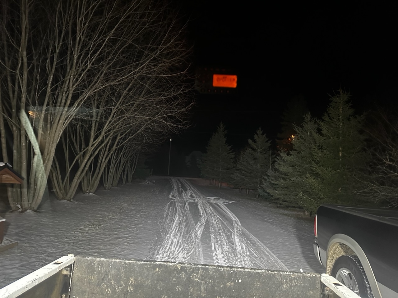

Rear Before:
Rear After:
I love the brighter whiter light - definitely recommend the upgrade!

FWIW, I found 885 connectors online and put those on the new LED light harness of two lights I had tried on the front. That way I retain the stock connectors, the lights are easily replaced and the 885 plugs are a waterproof connector.

Nicely done. I went the route with trying to mirror the stock set up, both with the floods and the driving lights.
Does anyone know how to wire the floods and the driving lights to all work together?
