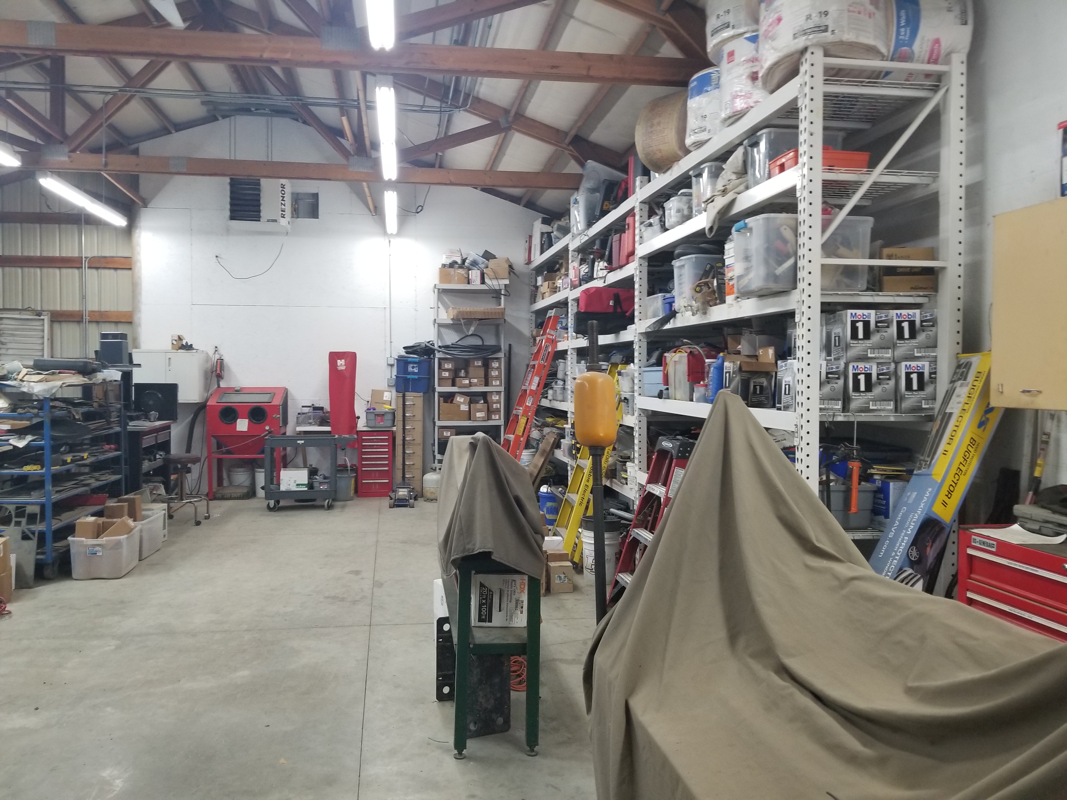

Rewired the lamp socket for grounded plugs and install two of the six "8 foot" Barrina led strip lights in my garage. Barrina LED Shop Light Fixture 8ft, T8, 72W 9lm 5K, Clear Cover, V Shape, Daylight White, Tube Light, Hight Output, Bulbs for Garage, Warehouse, Plug and Play (Pack of 6) - - Amazon.com
(I'm quoting the "8 foot" because the lights aren't quite 8' long, they're several inches short of that if you're making plans with a measuring tape).
So far so good. My first response on turning them on is "wow" and "awesome" because there is so much more light than my old CFL's, even with just one strip (though I've installed two so far in the center bay).
I have an FM radio playing in there, no RF interference, though maybe it takes AM channels to notice. I don't know how long these will last, I think the warranty said 3 years. But for now, the brightness is wonderful.
Photos really don't do it justice because the camera adjusts to the additional light. But the eyes notice it. For old eyes it now means I can read manuals without a flashlight.
