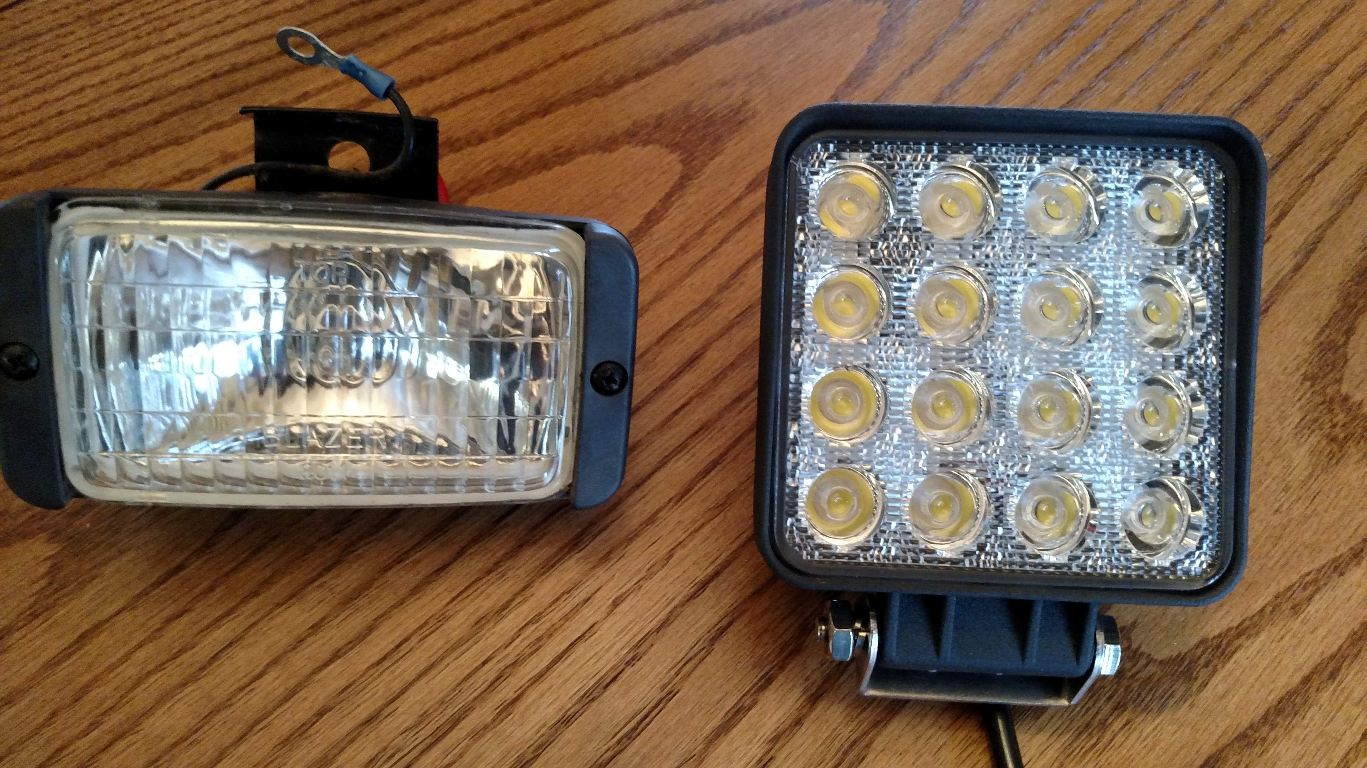

I worried about snow blocking the LED lights, but so far, it hasn't been an issue. Maybe they are just warm enough? Mine are ROPs mounted... but they get plenty of blowing snow and wet snow from overhanging evergreen branches.
   / led work lights for l3901 #14

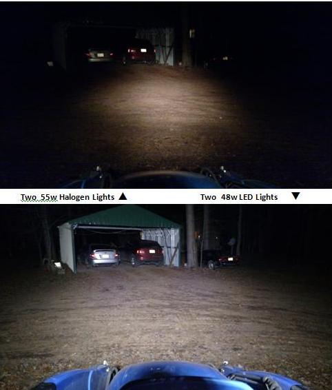

Difference between Halogen and LED ....

   / led work lights for l3901 #15
Great pictures showing the difference. I was amazed on a trial run in the dark the other night with the new led lights.
   / led work lights for l3901 #16

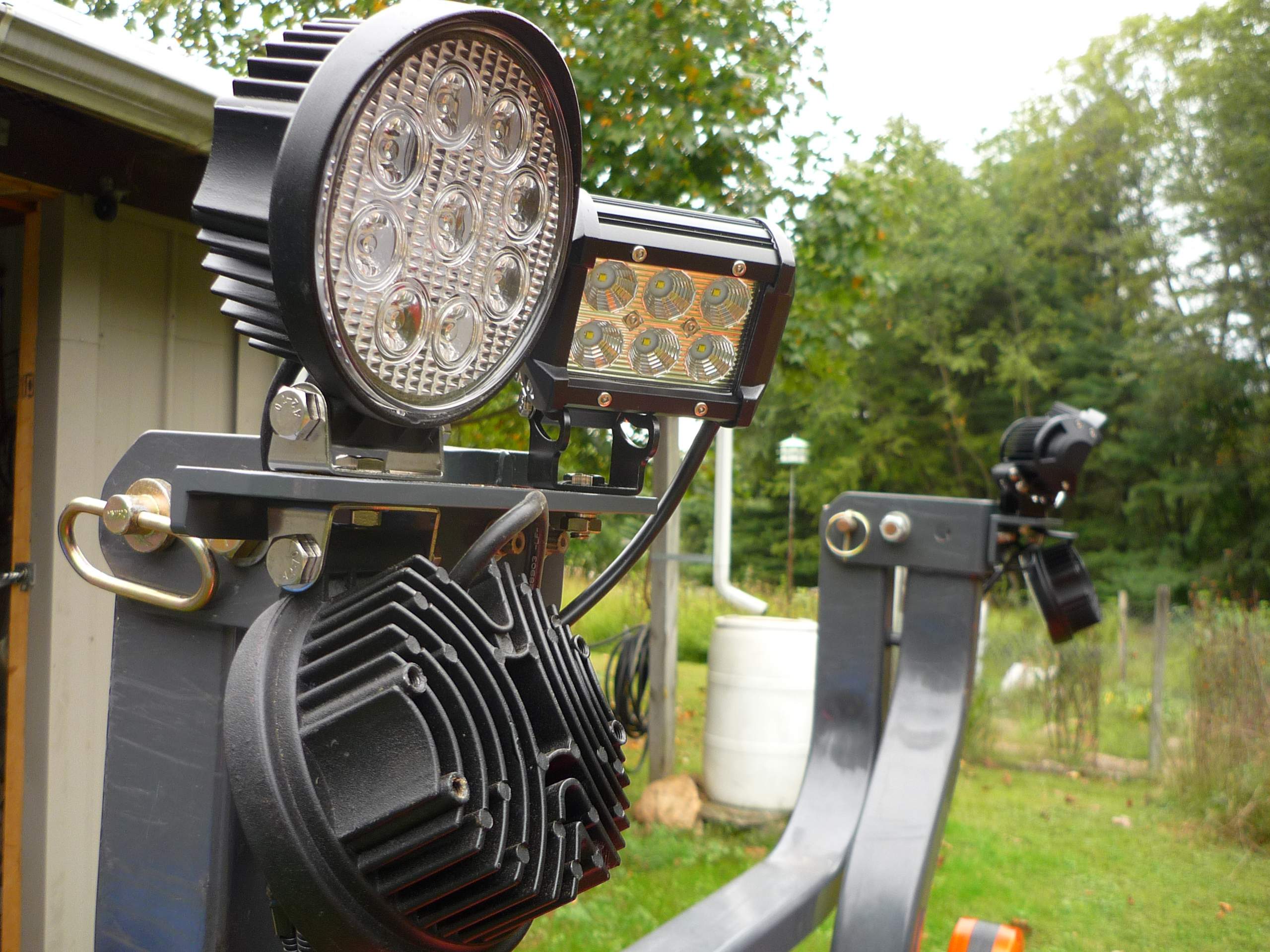

Varmint
Whee did you get those mounts you used?

   / led work lights for l3901 #20
powerscol, I won't triple post the photo, but I just made them from some scrap 2 x 2 x 1/4" aluminum angle I had. I would have used steel, but didn't have any the right size, and since the alum. was about the right length, free, and easy to cut, as well, it was a no-brainer. It's heavy enough it doesn't flex/vibrate (resonate?) I did have to drill some holes in the hinge bracket of the ROPS for 1/4 - 28 bolts, but the integrity should be un-compromised by small holes there. I like the lights high enough to clear the plow, out enough to not hit the back of my head (with light) and light the front/sides well, yet not so far that they are likely to get whacked by stuff. I'd probably use the top underside of the ROPS if I usually had it up, but I can't because of my limited barn entrance height.
Eric makes a good point- look for 5000 K lights if you can find them. Too blue isn't so great to work in- especially if you're working in a snowy environment. Not that we've seen any here this year. It was almost 70 in NYC at Christmas. That's just wrong.
