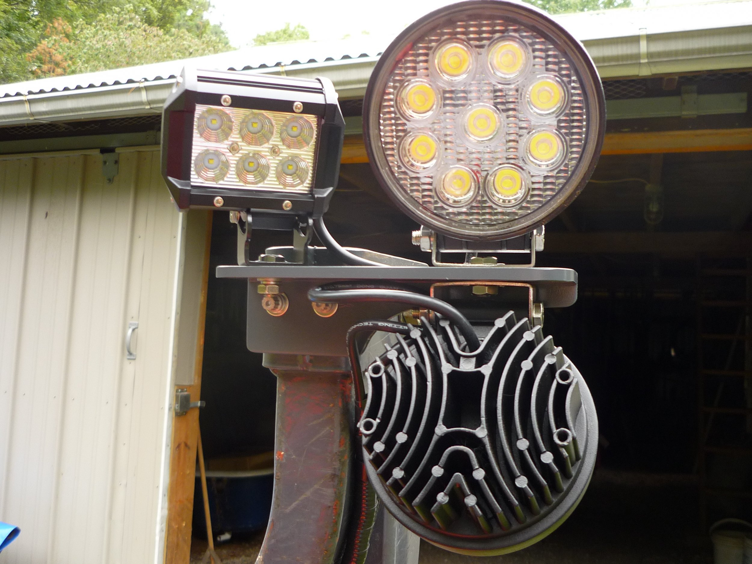

I too think the factory headlights are pretty useless. I wound up with 6 mounted LED's- 3 on each side of the ROPS, on brackets bolted to the folding hardware, so no holes in the ROPS. One forward, one to the side and one rearward for each side. All three pair on separate switches. Works fine, as needed. But since there's almost no real snowfall the past few years, no plowing required. I won't miss plowing at night to stay on top of a blizzard! The lights themselves were carefully selected from the many available on eBay, none very expensive, about 7-8 years ago. So far, absolutely perfect. I have a digital voltmeter monitoring alternator output, and with all the lights on, plus the OEM flashers, I still have charging voltage. But just barely.
