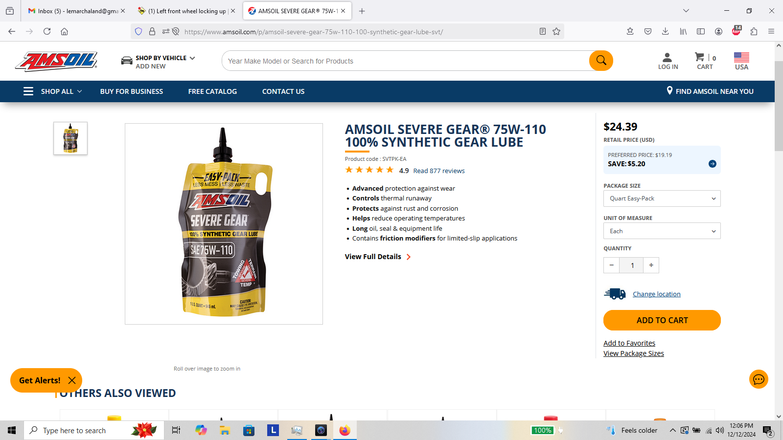

Myself I'd drain the differential and both axle drops, flush with some diesel, blow it out with air and refill with synthetic, such as;

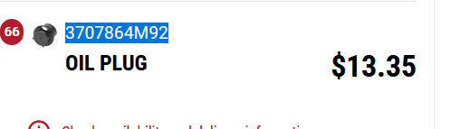

yup straight shot. however I would also replace the filler cap/vent to be safe.
part # 3707864M92 (item 66 in parts breakdown) runs around 14$ and and LOOKS to include oring.
