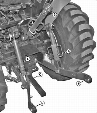

This is only my second tractor so I am still learning. I notice that the left lift arm on my new 3720 has a grease fitting. I don't understand why. I thought that only the right lift arm was adjustable.
I must be missing some fundamental point. Can anyone clue me in?

That lift link isn't adjustable (threaded), is it? Doesn't appear to be.That is kind of odd.

Yeah, but the fitting ("A" in the pic) is on the barrel, not where it pivots.
I'll venture those barrels (for the lift links) are manufactured so they can be used on either side during final assembly...nothing that would effect the end user (operator). The handles for the adjustable side are probably welded on downstream in the manufacturing process.

Look at the diameter of the lifting link. I would guess the bottom portion can be disconnected from the lift link. Then it can be turned out, to lengthen the link. The flaw is that the link is already plenty long. It might also be used on larger tractors requiring a longer link.

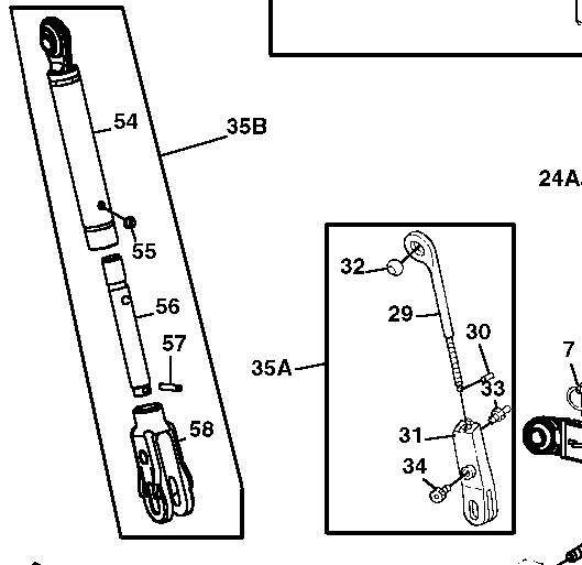

jdparts shows a different link part number left vs. right.
But does indicate that the left link is adjustable (by disconnecting and turning in or out). To keep the threads free and not rusted together, there is a means to grease them through the zerk.
Give it a try, and see if it works that way.

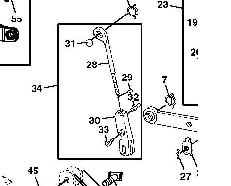

Are you positive it is not adjustable? My 4300 has an adjustable left link with the zerk on the lower buckle clevis (part 30) that can be turned on threaded part 28.
But then, there is a replacement link listed that does look like the picture posted by the OP, that shows both left lift links. Don't see threads on that replacement link 35B. The 35B replacement looks heavier duty than the 35A that I have.

I've no idea why that left link would be threaded. I'm guessing it may be used on different tractors (at different set lengths) or to adjust for the travel of the lower links (lengthening it would result in the lower link being closer to the ground, but not raise as high).
The Deere manual does show it as a location to grease, BTW.
Maybe having two links is typical on Ag and larger utility tractors (never noticed, but Deere manuals I looked at (as I write this post) do show grease fittings on both links). Both of my previous machines were "value" tractors and had a solid left lift link (no adjustability).
