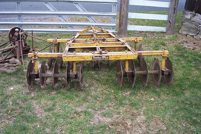

Afternoon George,
The farmer down the road from me gave me a 7ft Taylor Way disc harrow this past fall. In the photo you cant see it but the center support support piece that controls the angle of the front gangs is cracked in half :( It is tubular steel with a series of 1/2" holes spaced along its length for changing how aggressive you want the front gangs. I just measured it and made a new one out of solid stock. This spring Im planning on cutting out the old one and weld the new piece in.
Im planning on pulling it with the Massey, hopefully it can do the job ! ;)

George, running a discer is just another good reason to get a nice MIG welder.....

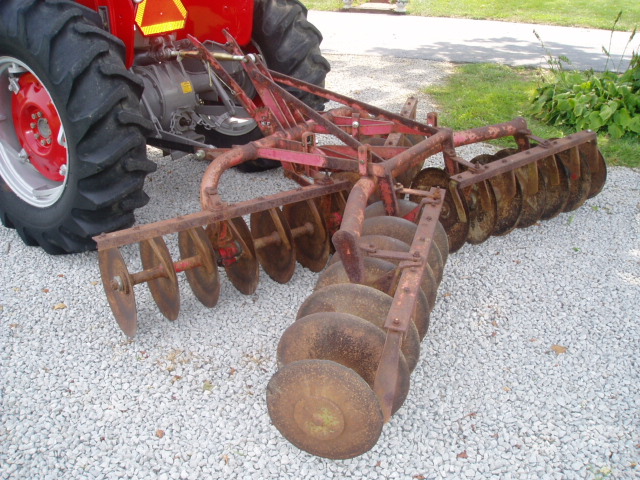

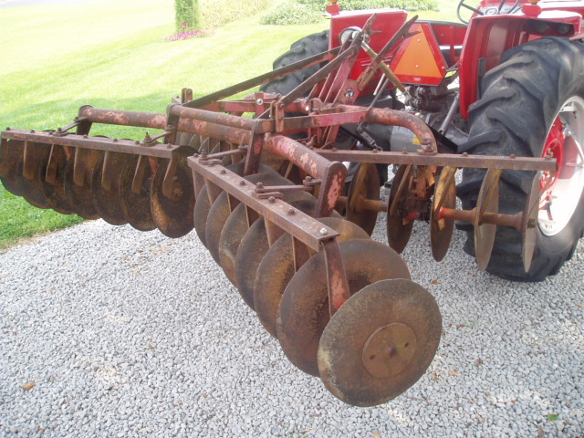

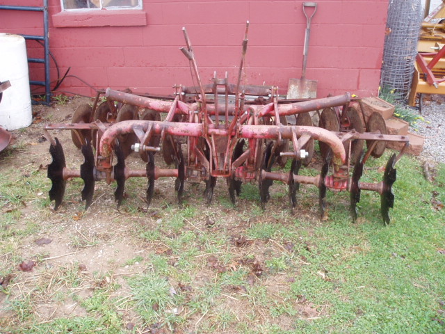

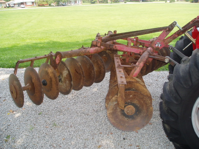

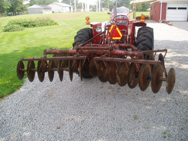

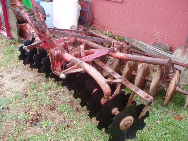

Scotty started showing pictures, so I have to now ;)
Here's my favorite type of 3-point disc. I've wanted one for YEARS. Finally got around to buying one last fall. When Harry Ferguson started selling his own line of tractors, a line of implements was also available. In the late 1950's, the Ferguson 6' and 7' lift disc was upgraded to the model 25. The design didn't change much, mainly more built-in weight. The #25 stayed in the MF line-up until the mid 80's. They work..... Just over 1000lbs in 7'-6" trim, they'll dig as well as some heavier disc's. Remove one bolt per gang and each gang floats independently. Levers above hitch allow "on-the-move" adjustment of gang angle, both front and rear. And the #25 leaves a nice level seedbed.
Pictures 1 thru 4 show the disc as I bought it. 8'-10" width.
Pic 5 thru 8 show it after the axles were shortened, making it a 7'-6" model. Rear disc blades had been recently replaced. Fronts were a different story. So... New notched blades.
