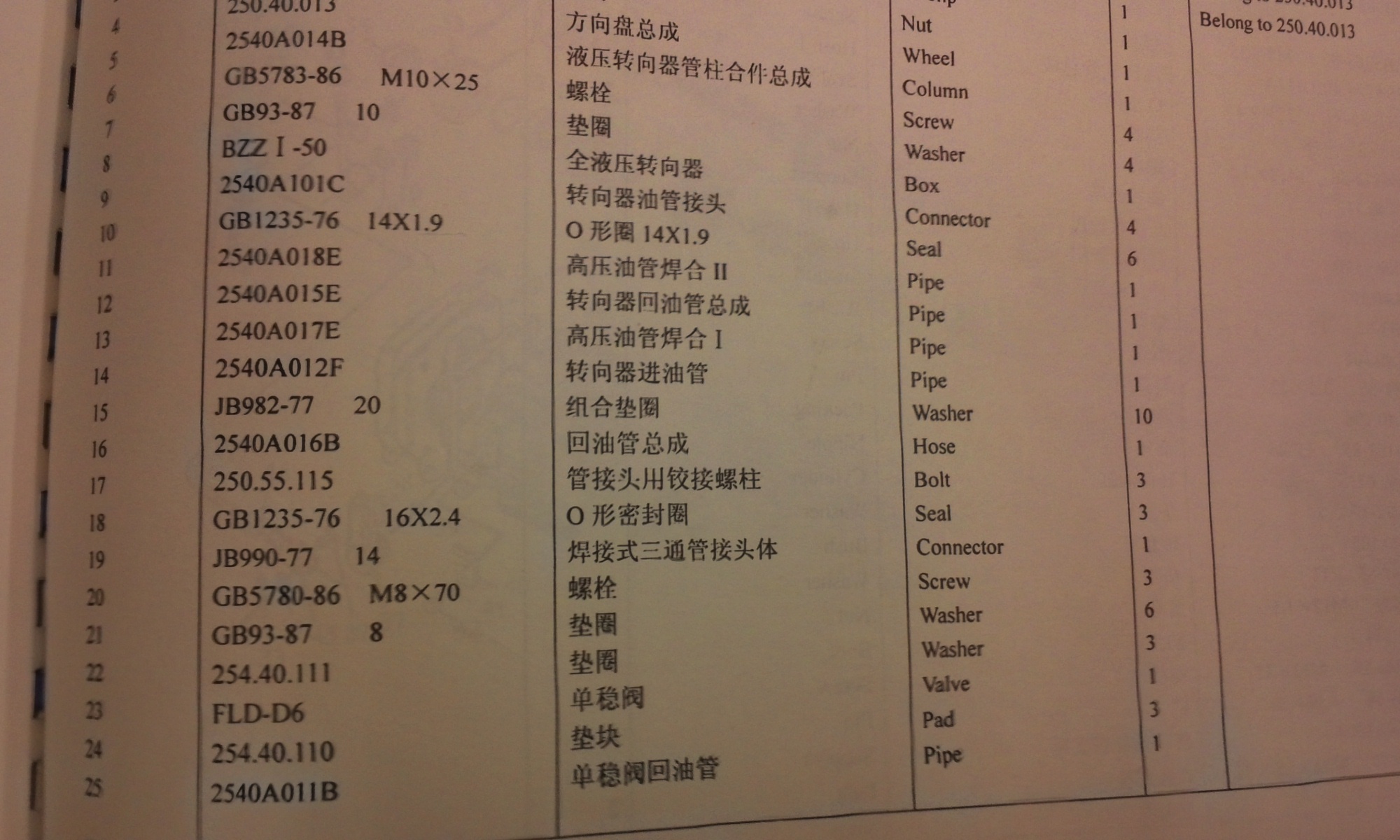

A friend with a Chinese wife translated the Chinese characters on the metal label
Lenar Tractor valve Chinese translation
From the top:
Single-channel stabilized shunt valve
Model FLD-F 6
Set the pressure 10 If this is 10 MP then it is 1,450 psi
Serial number 03090602
Bottom is the name of the factory. the Zhenjiang Hydraulic Parts Factory
I need to see the end of the part with the nameplate on it if there is any sort of adjustment there.
I still need a scan or photo of the parts diagrams which have the hydraulic components.
I don't yet know what a Single=channel stabilized shunt valve is. Every search I do comes back with medical reference. Not much luck googling Zhenjiang Hydraulic Parts

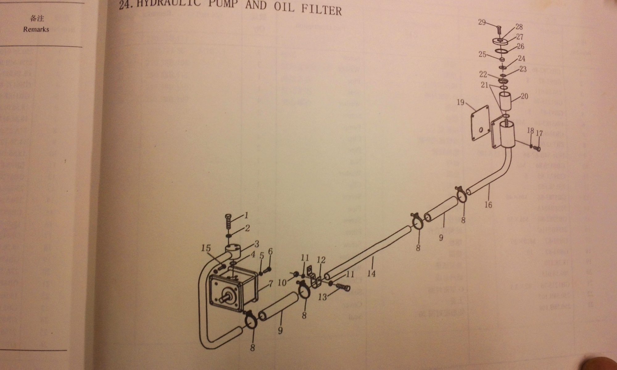

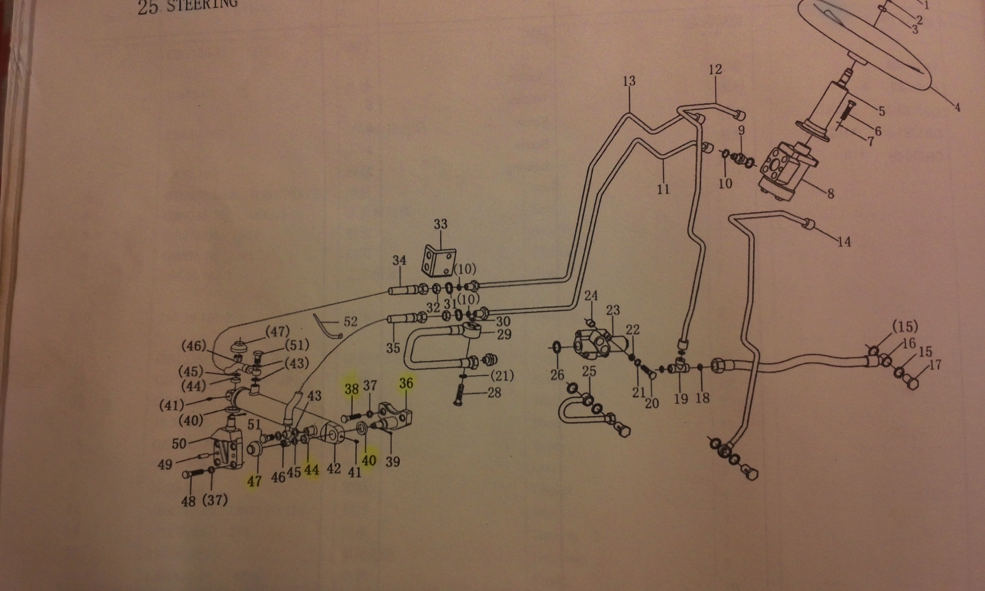

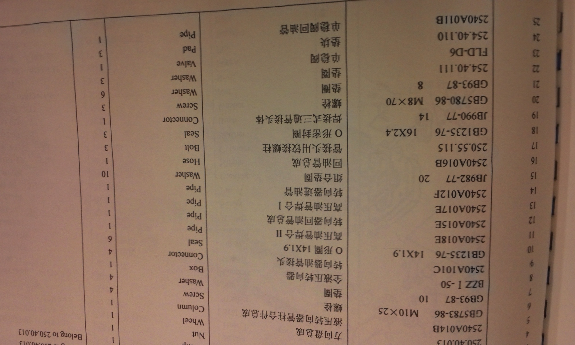

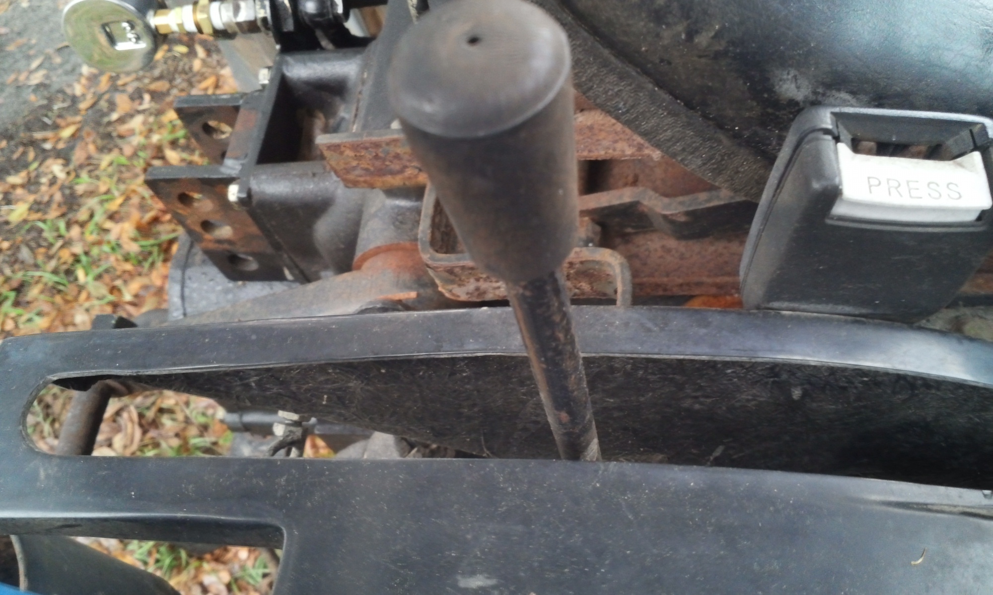

Hi Dave,here are some additional photos for you out of the parts book.I have no idea why the valve is on the steering page and the pump is on the hydraulic pump page,but at least we know now that it is the valve.I took a photo of the parts list and it says that it is a valve.The other photos show the knob under the seat to get flow to the 3 point lift or the quick connect plug to run the backhoe.You shut the knob off to direct flow to the fitting for the backhoe and open it to direct flow to the 3-point liftbars.The FEL nor the power steering are affected by either position of the rear knob.The lever for the 3-point hitch to raise and lower is also in a photo.The low pressure return line for the backhoe goes into a barbed fitting tapped right back into the gearcase,as the transmission is also lubricated by the hydraulic oil.I have never disconnected the quick connect to the valve from the pump.Nothing on the pump as far as ID.Thanks again very much,
Mike

This may seem like a stupid question but..... the knob under the seat, why the numbers on it? Could this knob be to adjust the stiffness of the seat suspension and have nothing to do with the hydraulics. You describe turning the knob all one way or the other so having numbers makes no sense.
Part number 23 valve. Do we agree it is the component with the Chinese writing on it that we have been discussing?
Dave M7040
   / Lenar 254 II Hydraulic pump weak
#30
Dave-yes,the valve,part number 23 is for certain the valve with the chinese writing on it.The knob under the seat for certain cuts off the power to the 3 point and directs it to the auxillary quick connect for the backhoe.I have no idea why there are numbers on it.
