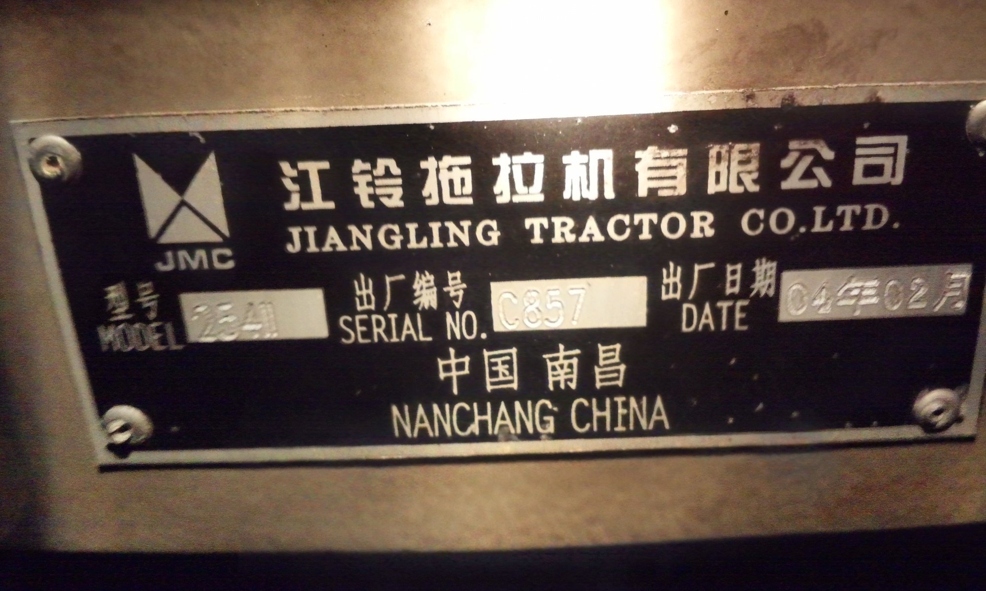

This is where I would start looking for a name plate.

Here you go Dave.

Great stuff
This will make getting accurate info much easier.
dave
Mike
Sent the label photo to Red River parts.
See their answer below.
I will email you the link to the manuals.
I think the relief vale info I sent you recently was from those manuals so I dont know what to suggest as you have higher pressures than the manual says you should have.
I suggest, after you look at the manuals,to call Red River and through a conversation try and figure out if there were any dealer options that might have been put on your tractor which are not reflected in the manuals. For example, when the FEL or backhoe was put on, did something get changed?
