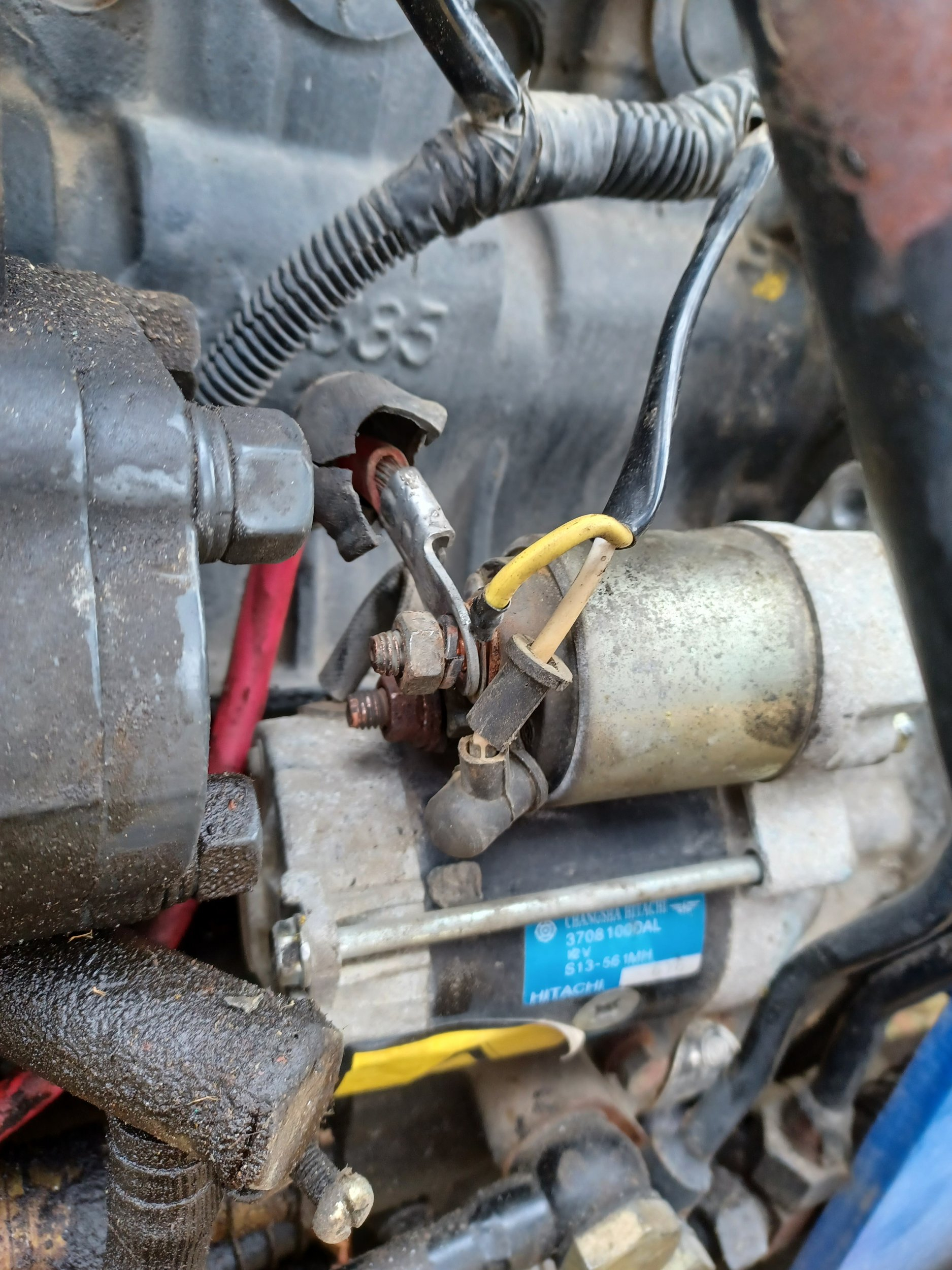

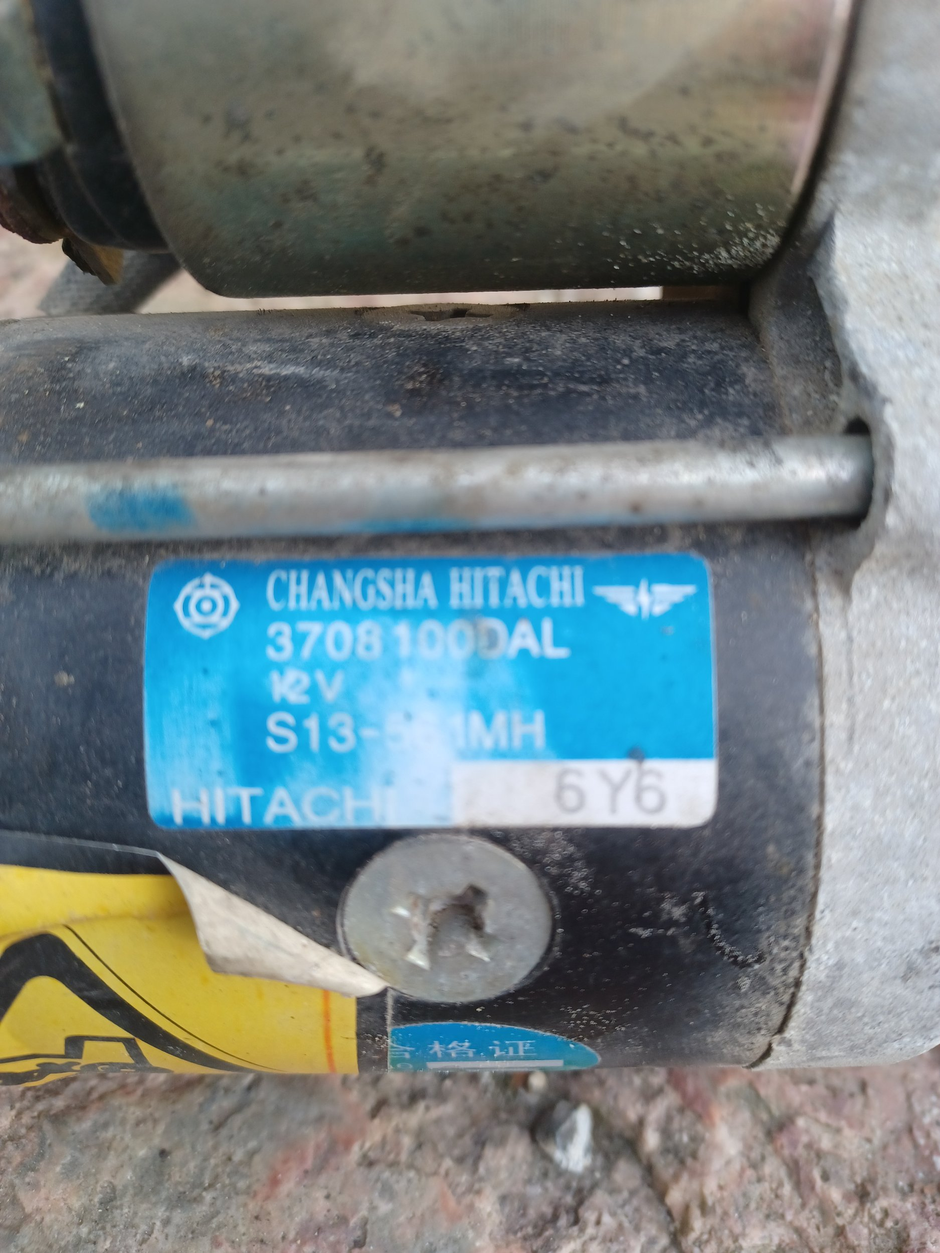

Might be to late answer for you, but if others have the same challenges I posted a picture of my starter on Lenar 254II
I have to change the starter after 16 years (not bad lifetime) and had to remove a nut from the hydraulic pump to fitt the new back in. Took about one hour to remove and refit the starter.
