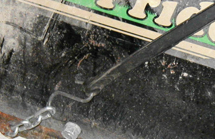

I too, had a problem with my back blade "digging in". Had a local welding shop in Petoskey plasma cut a slot in a 2" pipe, weld flat washer on each end, and also weld a couple short lengths of chain near each end. I slip the pipe on the bottom of the blade and use a tarp strap across the frame to the two chains to hold it in position. Works like a champ.

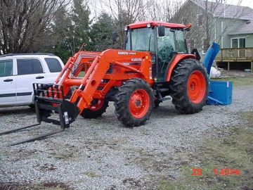

eric:
Here is a picture of my snow removal outfit. Only got to use it once this winter. I'm 60 miles south of you and 30 miles south of Ron.
Seroius power for serious snowfall. Problem is, no snow. I think this summer I am going to scrounge around for an old Meyers or Western snowplow and subframe and mount it to a QD plate so I can put a snow plow on the FEL. That way, I can make a pass down the road and 2 passes with the blower and the road is done. I live about 2 miles from the pavement that the Road Commission sometimes plows. /forums/images/graemlins/grin.gif

   / Let It Snow,Let It Snow,Let It Snow #16
Sure can. pic 1 of 3

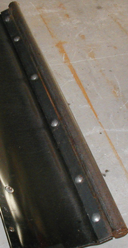

   / Let It Snow,Let It Snow,Let It Snow #17
pic 2 of 3

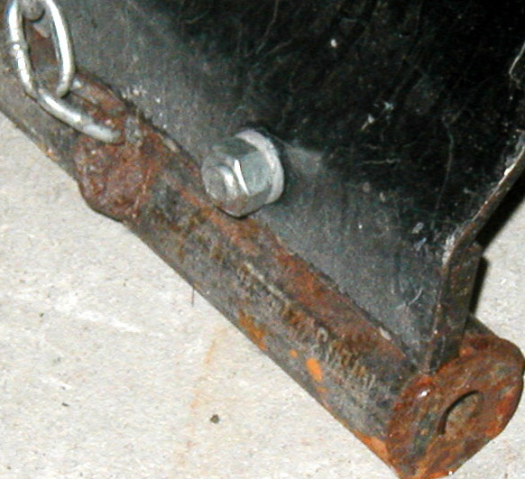

   / Let It Snow,Let It Snow,Let It Snow #18
pic 3 of 3.
If you have a pipe made up, have them use hard pipe, it'll last longer.
