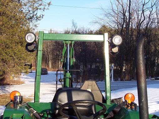

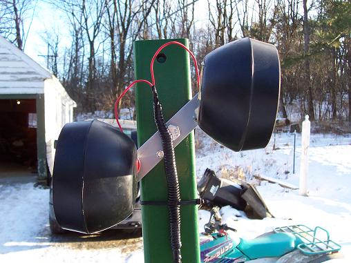

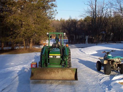

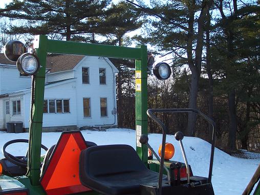

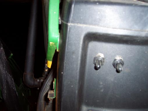

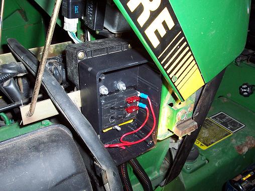

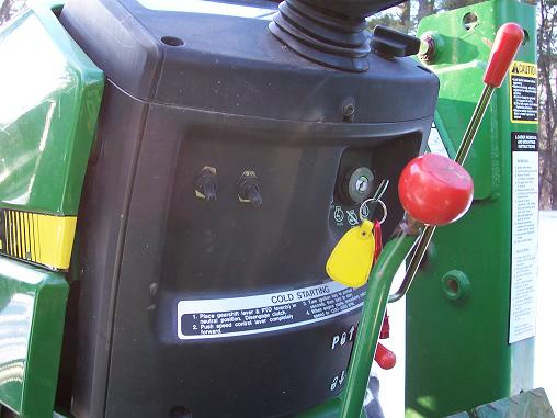

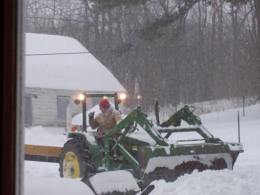

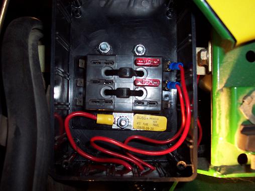

Hey Guys,
Thanks to all of you my lights work great, here are the pics I promised!!!!!
