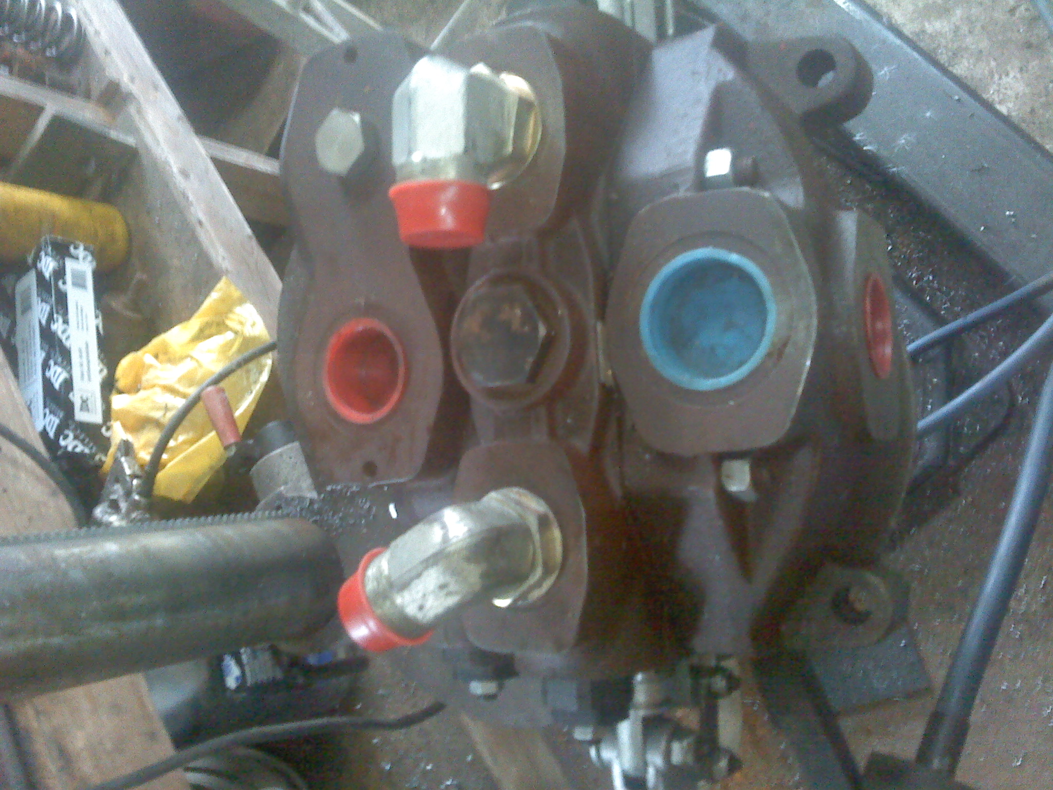

Hi everyone, I have recently acquired a monster beam to build a log splitter with. I will post some pics so everyone can get on board with the size of this thing. It's 16" x 16" x 17' and 1-5/8 thick. I have a 10" bore cylinder ~8' long with a 5-1/2" rod dia. A 165 hp straight 6 gas motor and front end from an International truck that will take 10.00x20 tires and should make a good axle. I'm looking for this to be a community project and would welcome any and all ideas going forward. I'm looking at a 60 gpm pump and a six or eight way wedge.
Stand by for some photos, away we go.
Thanks Mike

With 60 gpm, this is the smallest valve he can get by with,. This one is a v70 with air shift. Holding a 60gpm valve lever by hand gets old after a while. This valve will cost over $1000 new, and I havent ever seen one this size on a dozer, trackhoe or similar construction equipment. So good luck looking for used at the scrap yard. A better bet when looking for used might be to try and find a electric solenoid valve, altho, most that size I have seen have been closed center. But since you also need a very large pump, going with a varible displacement pump, might make the project a little more pocketbook friendly.

wouldnt work, to do so you would have to split your flow with divider valves, pass thru the solenoid valves and recombine the flows to the cyl, and then on return do it all over again, very poor setup.
   / Let's build the biggest non commercial splitter ever! #56
Why would you need flow divider valves? All the valves would open together and supply the same circuit so I don't see why it wouldn't work.
With that approach I would look for or machine a manifold block to split and combine the flow on input and output. It would be complicated and expensive to do it with T fittings.

Each valve would need its own in and out ports and none of the d3 subplates are big enough to handle 60+gpm of flow. This means you would have to use a seperate subplate for each solenoid valve The out port on the pump would have to be tee'd or divided into three seperate flows before it reached the three subplates and the flows recombined after the solenoid valves before reaching the cyl. Now assuming he was able to pump 60+gpm thru the three valves for cyl extention, the flow on retraction would be closer to 75-80gp (without doing the math) Even assuming the three subplates did get a equal share of the oil flow, together they are not rated to handle but about 75% of the return old flow. This would necessitate using a dump valve to return the oil back to tank. Now somewhere in all this plumbing mess you would have to tee each hose to that dump valve, or multiple dump valves, before going back to the CV subplates and directly to tank. Yea, it can be made to work, but by the time you buy all the extra parts needed, you could have bought a proper sized valve and not had to deal with a lot of hukabuking engineerings. Also think about what would happen if one of those three solenoid valves sticks or fails, You would be trying to pump the full 60gpm thru one little 5/8 hose and all oil would be directed straight back to tank.
Finding a solenoid valve that would handle 60+gpm flow probably wouldnt cost anymore than buying three of the valves that where suggested. I would look for used valves on large knuckleboom logging equipment that run big bucksaws. Most of those type machines are high flow hyd and should have large hyd control valves.

Good point that retraction would up the flow rate. Could add a 4th spool to increase capacity. I agree with everything you said about complexity of using off the shelf do3 adapters. Id only go with the multiple spools if I had access to a mill to build the manifold I needed. OP hasn't said what he has access to for tools, but it sounds like he is willing to spend time to save money.
I like the exchange of ideas here, even if the project never goes anywhere.
He should add a relief valve no matter what he does.
