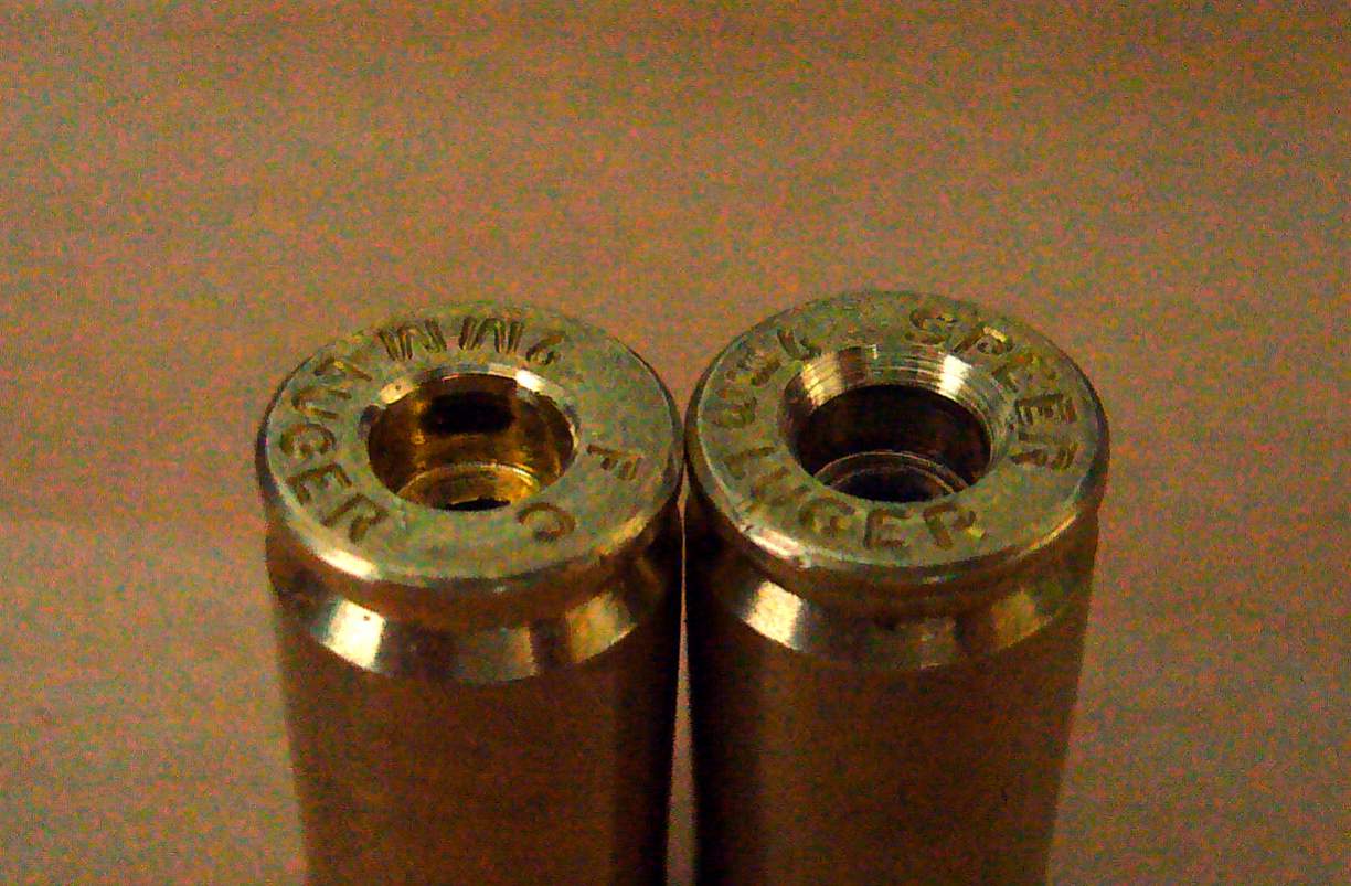

Well I bought the Lyman case prep center and it works pretty well. However, I did not care for the primer crimp remover it comes with. How much it removes depends on how long you hold it there and how hard you push down. After a bit of research I bought the RCBS Military Crimp Remover which fits on the Lyman just fine. It has a stop so the case can only go down so far, similar to the Lyman primer pocket uniformer. It removes a lot less than I thought was probably needed. I have yet to reload brass processed with it but so far I like the concept. This way brass that doesn’t need a crimp removed does not get any material removed. I was a bit concerned that after multiple reloads the primer pockets would be too wallowed out to work properly. Now I can just run all my brass across it without having to attempt some type of pre-sort.

unless they have changes the primer pocket, crimp reamer, the lyman crimp remover CANNOT remove too much metal. it is precision designed to BOTTOM in the pocket and thus once bottomed, the reaming edge shoulder on the OD can no longer remove any more metal. the documentation specifical details this. My unit is 2ys old now.. so 'MAYBEE" they changed.

It does bottom but removes quite a bit of brass even from non-crimped brass. Not the best picture but you can see the difference. The one on the left was trimmed with the RCBS Military Crimp Remover and the one on the right was with the Lyman tool. Neither were crimped brass. Maybe it is just me but it seems the less brass removed the better.

Yeah, I would not be satisfied with the one on the right either.. seems the shank is a bit too short and allows it to go to far.

The cutters both seem to be doing the right thing for mil crimps, but IMO one a bit much and one barely enough. For many, 'loose pockets' are grounds for immediate discard of a case. (In ARs losing one into the action is a bear.)
I wouldn't expect cases trimmed with the Lyman tool shown to hold primers to my stds for other than bolt guns. (.. would set that one aside for now) I've seen/felt/measured seating pressure avg ~1/2 the norm in once-fired 5.56s with such a deep chamfer and prefer swaging vs reaming much for that reason. YMMV btw: overly deep pockets/seating can cause light primer strikes, a whole 'nother issue.
Have yet to see a pocket swaging tool I didn't like, whether bench-mount or press model. Sometimes a sharp edge stands out a bit after swaging, but it's easily cleaned up with the gentlest bump from any chamfering tool just as a neck would be.
