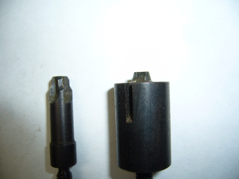

yep.. that looks way wrong... i'd like to see a pic of the tool that made that. I can run my cases onthe crimp remover and hold there till my hand is tired and once bottomed.. there is no more cutting.
either the shank is short.. or the primer pocket is too deep.. or it's a combo tool with a pp true end mill on it and was cutting deeper intothe pocket.. or they have added a wide angle taper cutting edge to ther new tools.
i would not run the one on the right either.
Finally got around to taking the picture. The one on the left is the Lyman that came with the prep center on the right is the RCBS Military Crimp Remover.
I tried it on some other headstamps and it does the same thing.
   / Lets Reload some Ammo! #74
interesting. mine has a more squared shoulder!
