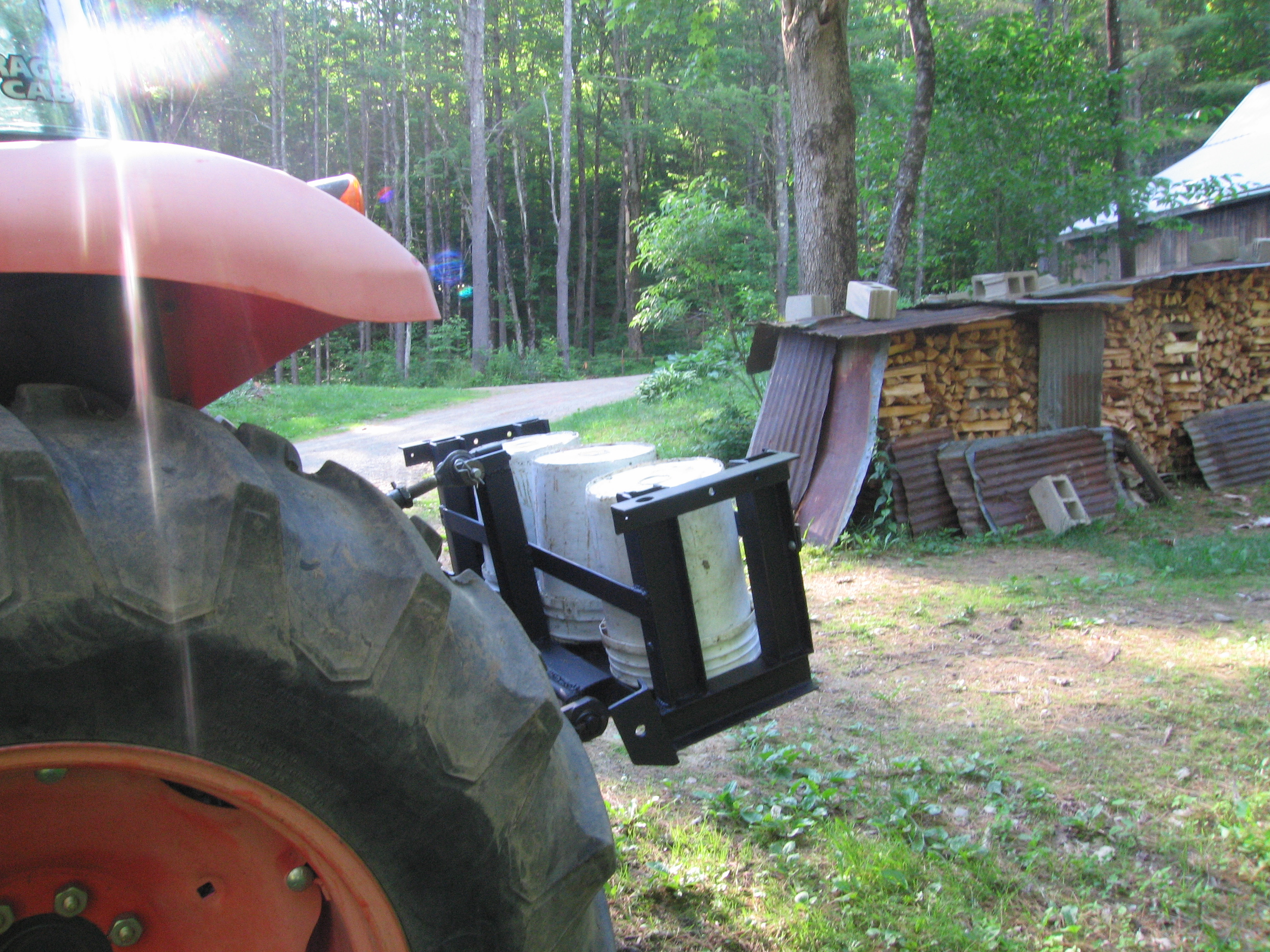

Yea, the scabbard goes into a 2ft piece of pvc that i already had that i baked and molded. The pvc goes all the way through the bottom of the barrel. Scabbard has some holes drilled in the bottom so it will drain.
Now, i guess I'll have to practice my quick draw time
Clever! I like your setup a lot.

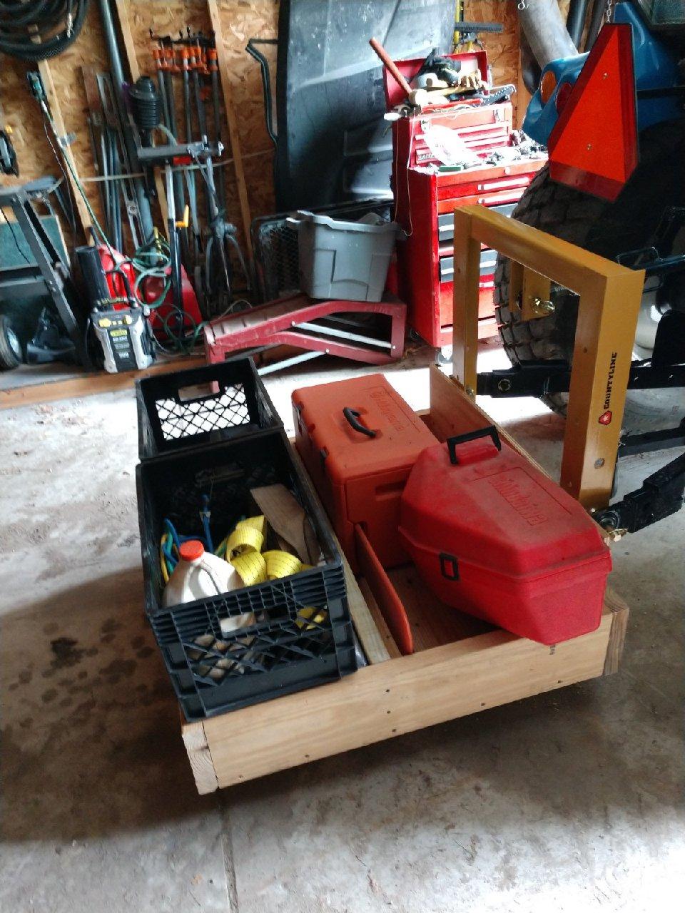

Mine started with a TSC carryall and used scrap I had laying around. The ballast is 735 lbs of lead ingots. The crates are screwed down and keep the ingots from jiggling out while adding a bit of storage.

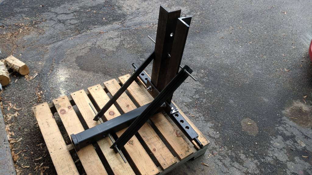

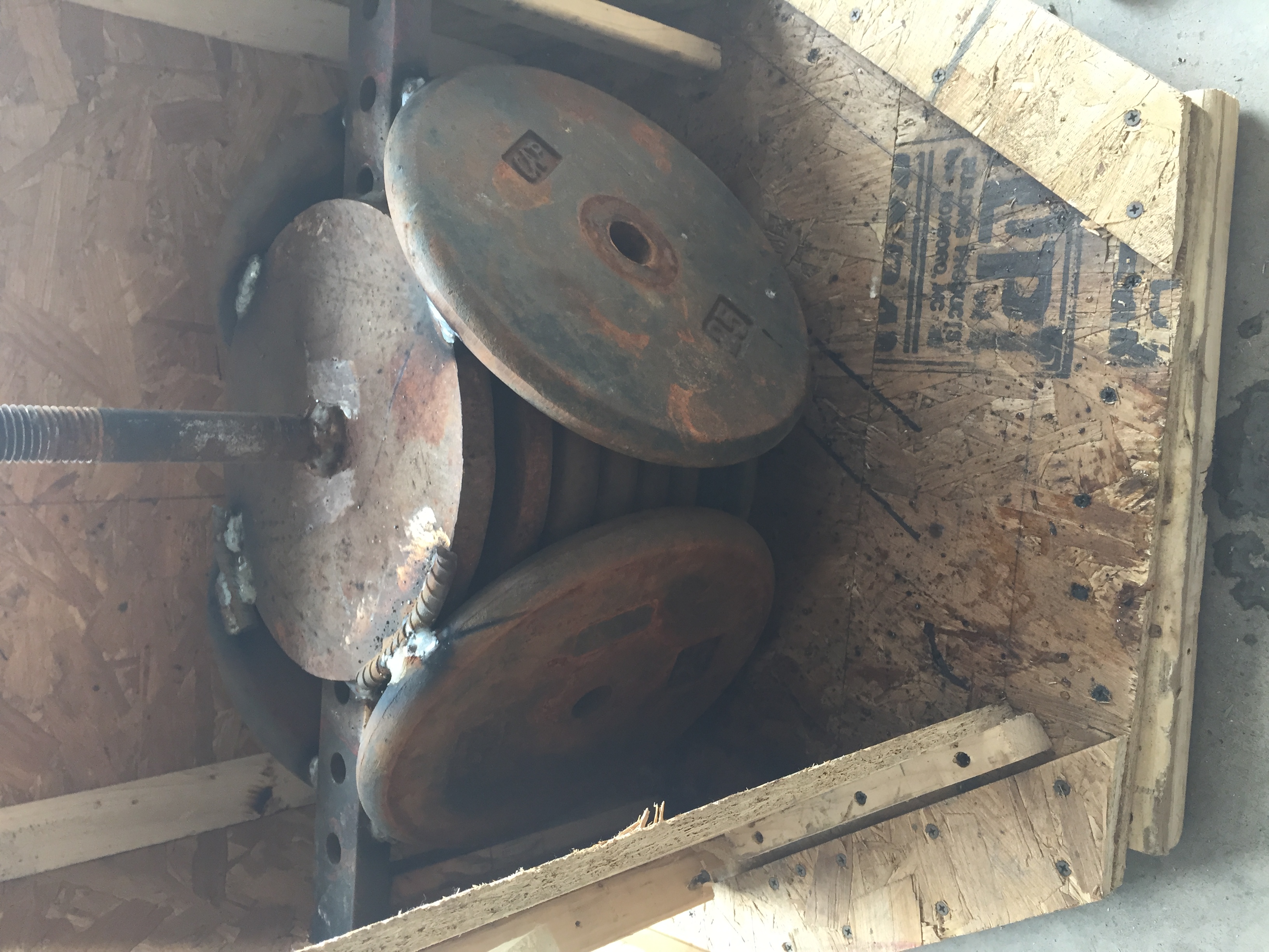

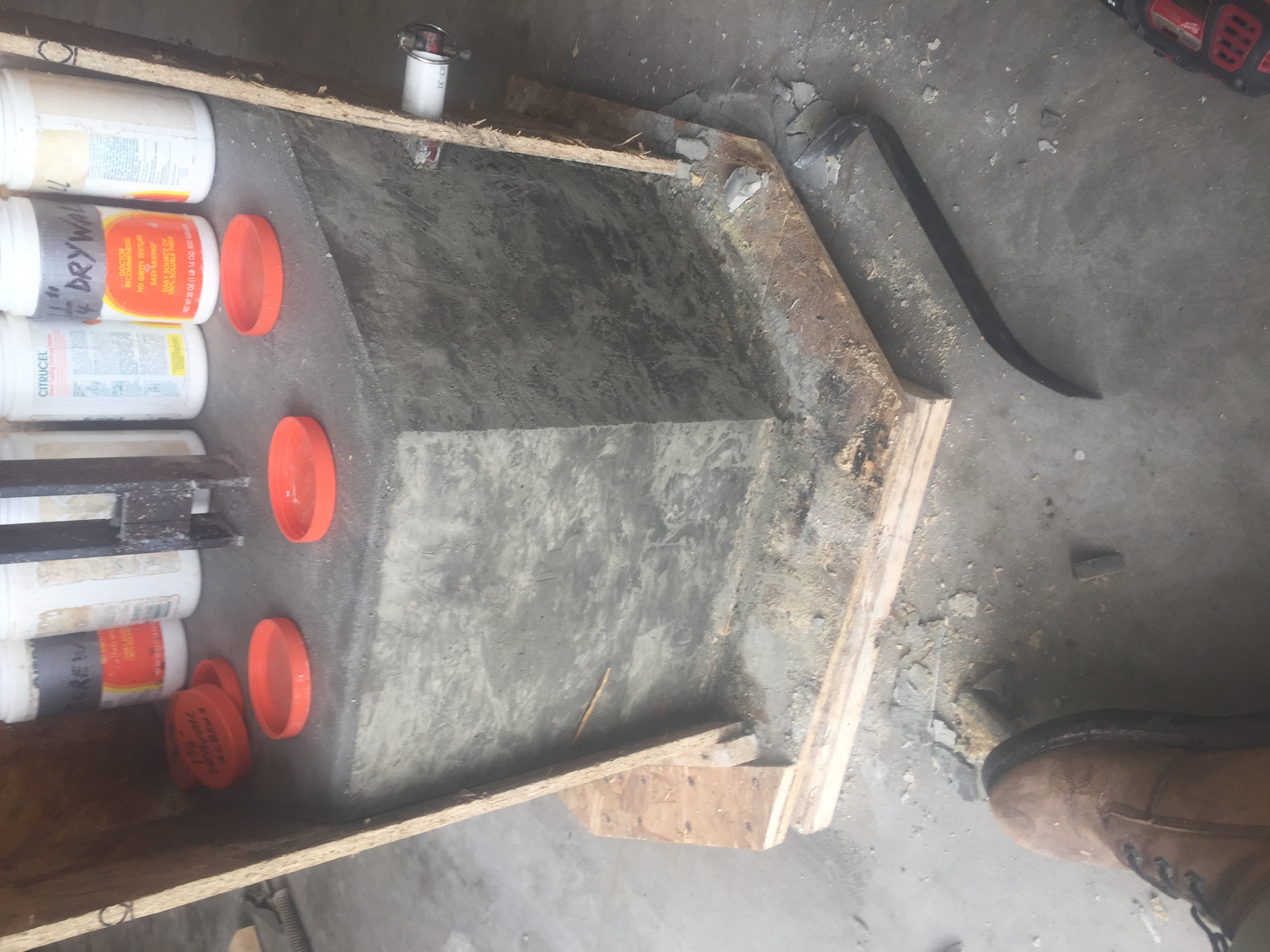

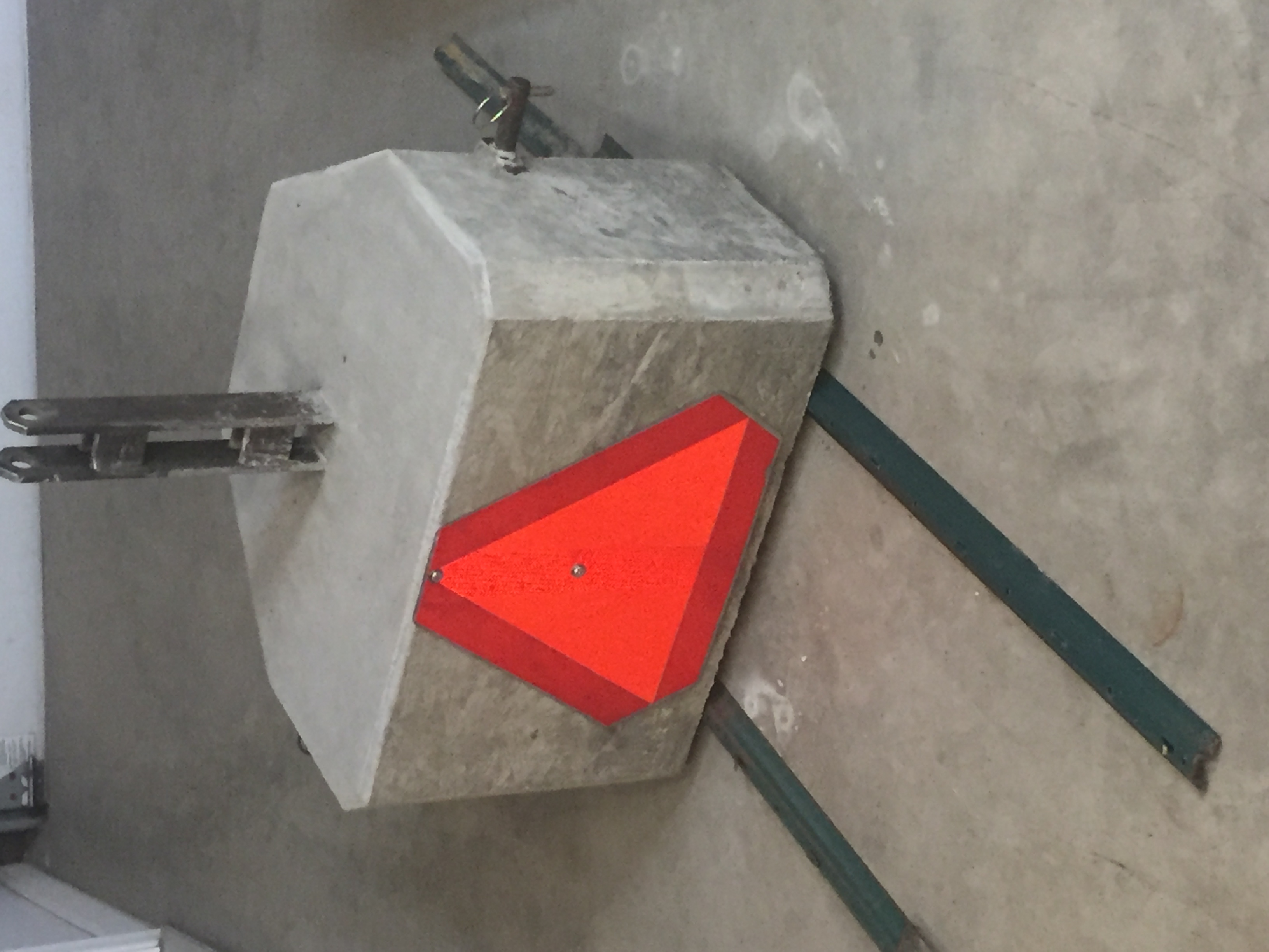

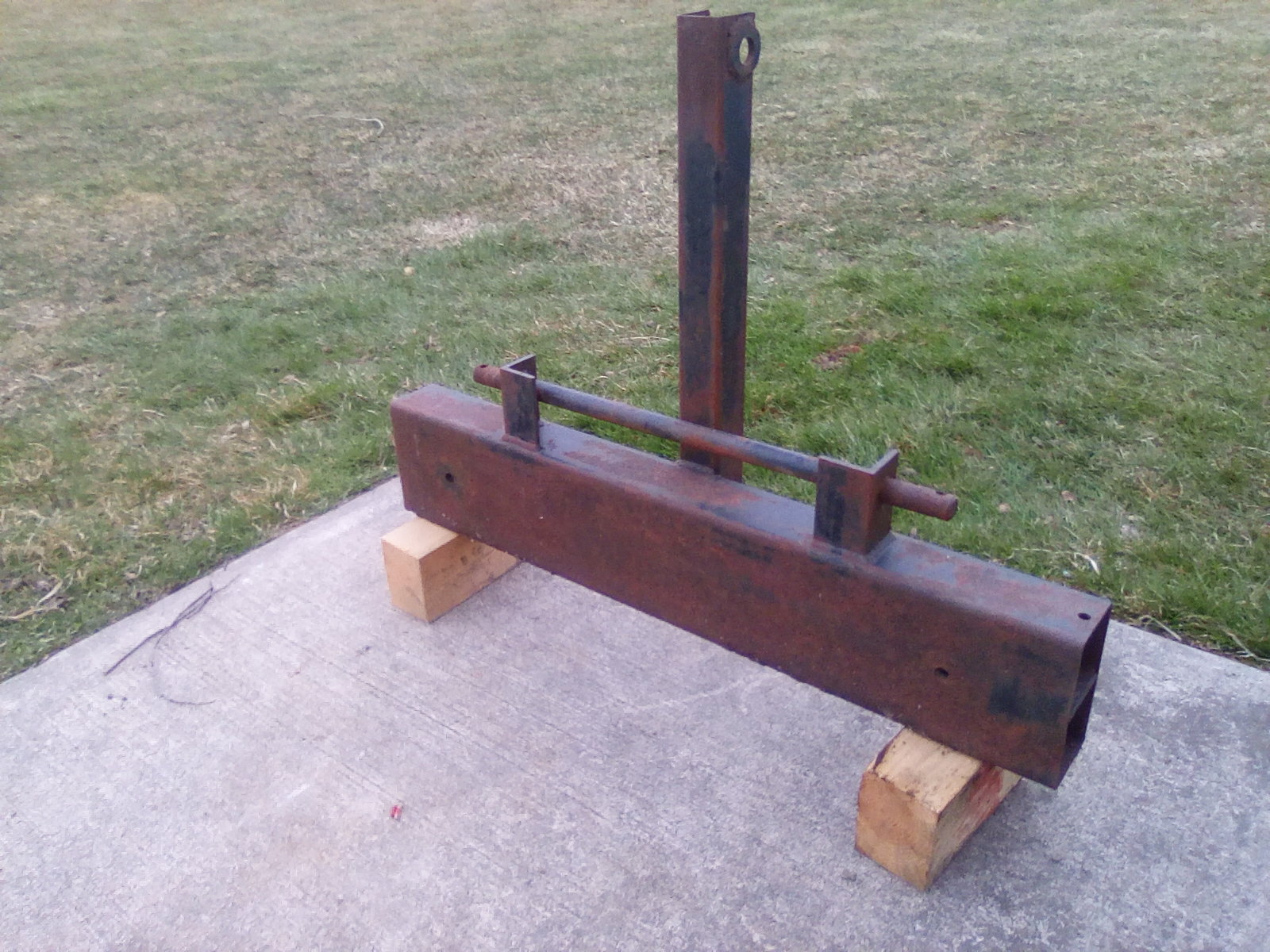

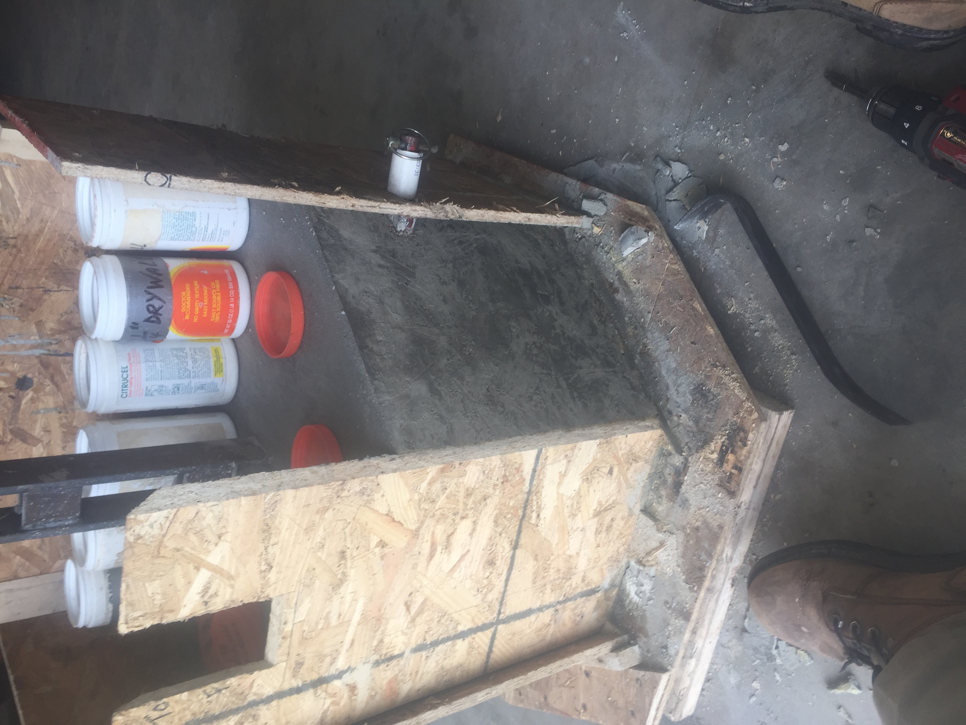

Here is phase 1 of my homemade ballast box. It is a bolted steel frame using a Cat 1 drawbar, 2 foot long 2" receiver, 3/8" thick 3" angle, 1/4" thick 1.5" angle, and some threaded rod.
It will be encased in concrete 24"W x 24"L x 28"H and estimate it will be 1300# including the steel. I plan to add a piece of bent rebar as a top eye, a small conduit to wire lights, a tube (and drain) for rake/shovel, a SMV sign and 2 bolts on top to secure a toolbox for chains, etc. I plan to set the drawbar 5" in from the back and and 9" above the base. I want to be able to set it down as an extra brake.
I welcome any advice before I build the forms. I'll post progress photos.
   / Let's see some homemade 3 point ballast! #107
Be sure to install a notch for the toplink or it will end up bent into a pretzel...
