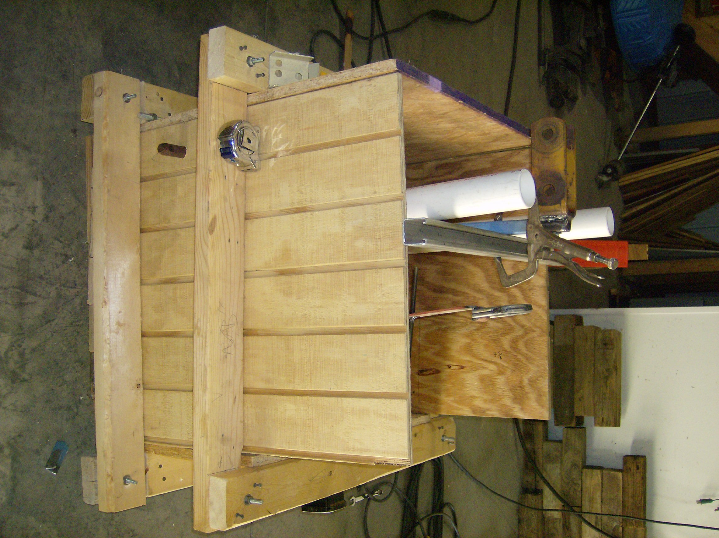

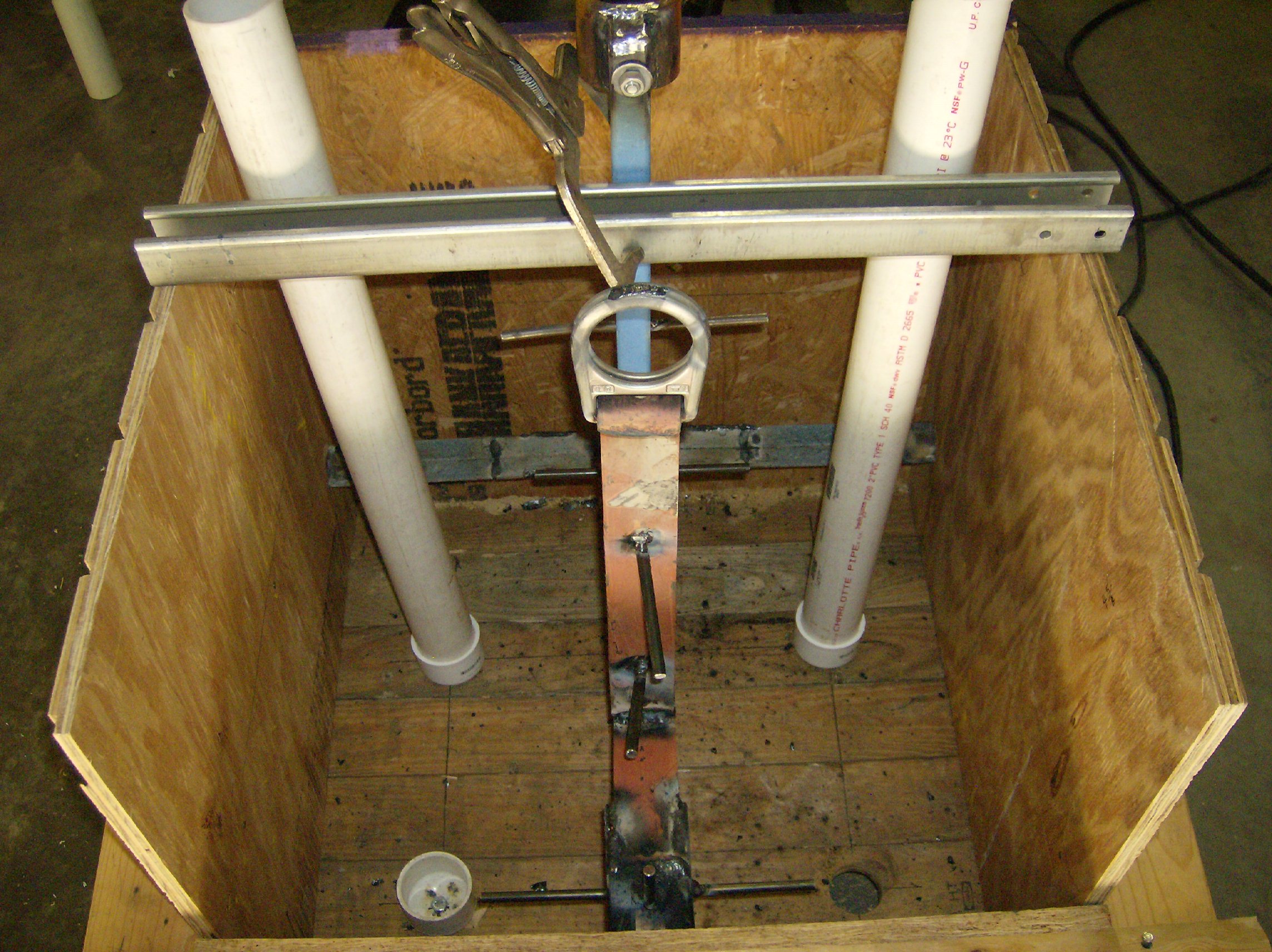

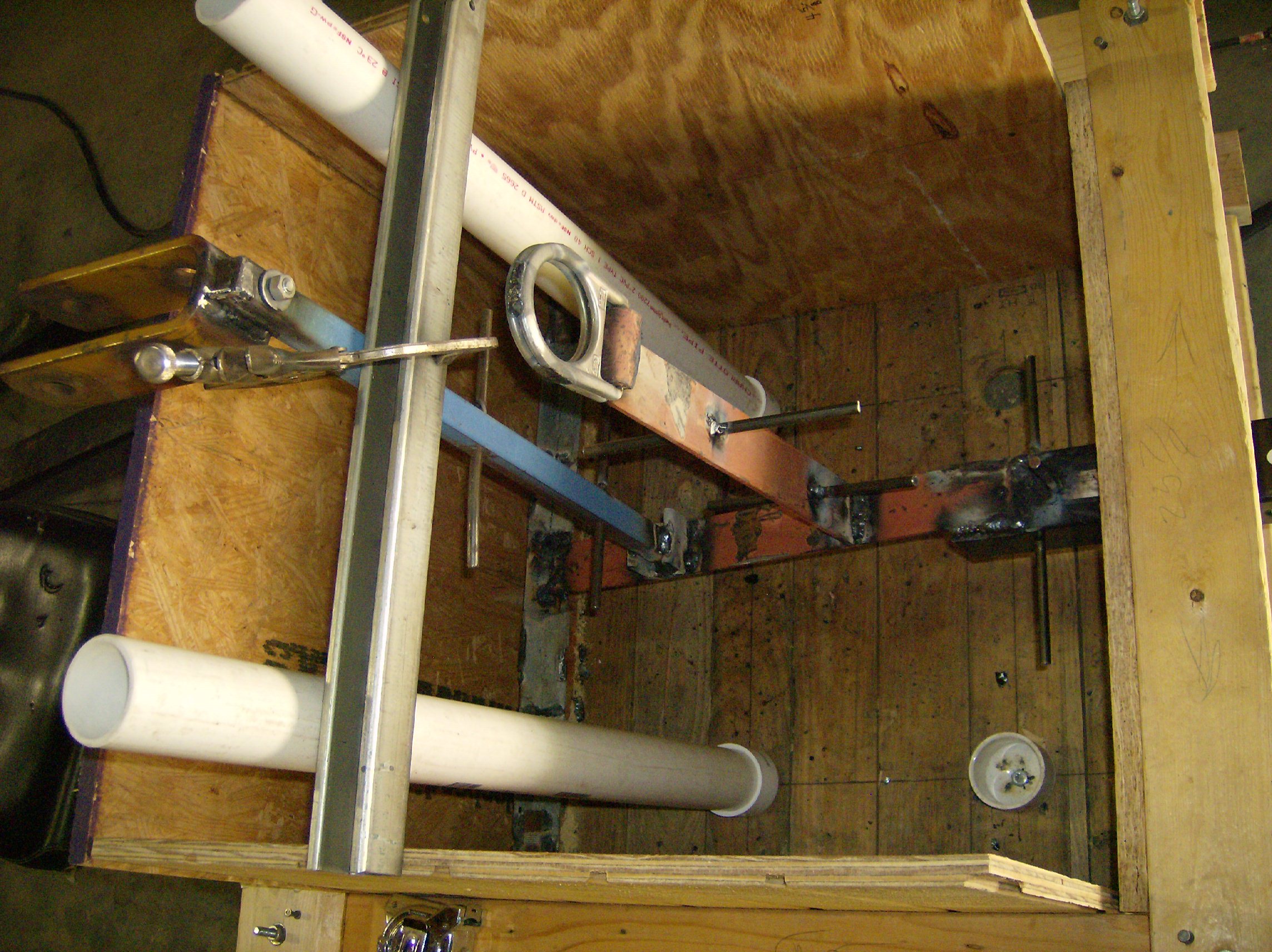

Sorry about the sideways pics , aint posted pics in a long time.

   / Let's see some homemade 3 point ballast! #127
The pics come out fine when you open them. I don't know why some seem sideways in the thumbnails, but it doesn't matter.
   / Let's see some homemade 3 point ballast! #128
Well fellas , it aint purty down in there. More later
If you have not poured the concrete may I suggest an addition. I placed two 1x4x16" boards in the bottom under the tubes. After the pour I removed the 1x4s and replaced them with 2x4s that act as feet to reduce damage to my garage floor. I drilled smaller drain holes through the 2x4s into the tube caps. Just an idea.

   / Let's see some homemade 3 point ballast! #130
Pictures taken with I-Phones don't always orient correctly, something APPLE has never really fixed.... Best solution before upload is to load pic into good graphics editor on real PC do any fixing and then save, then upload....
