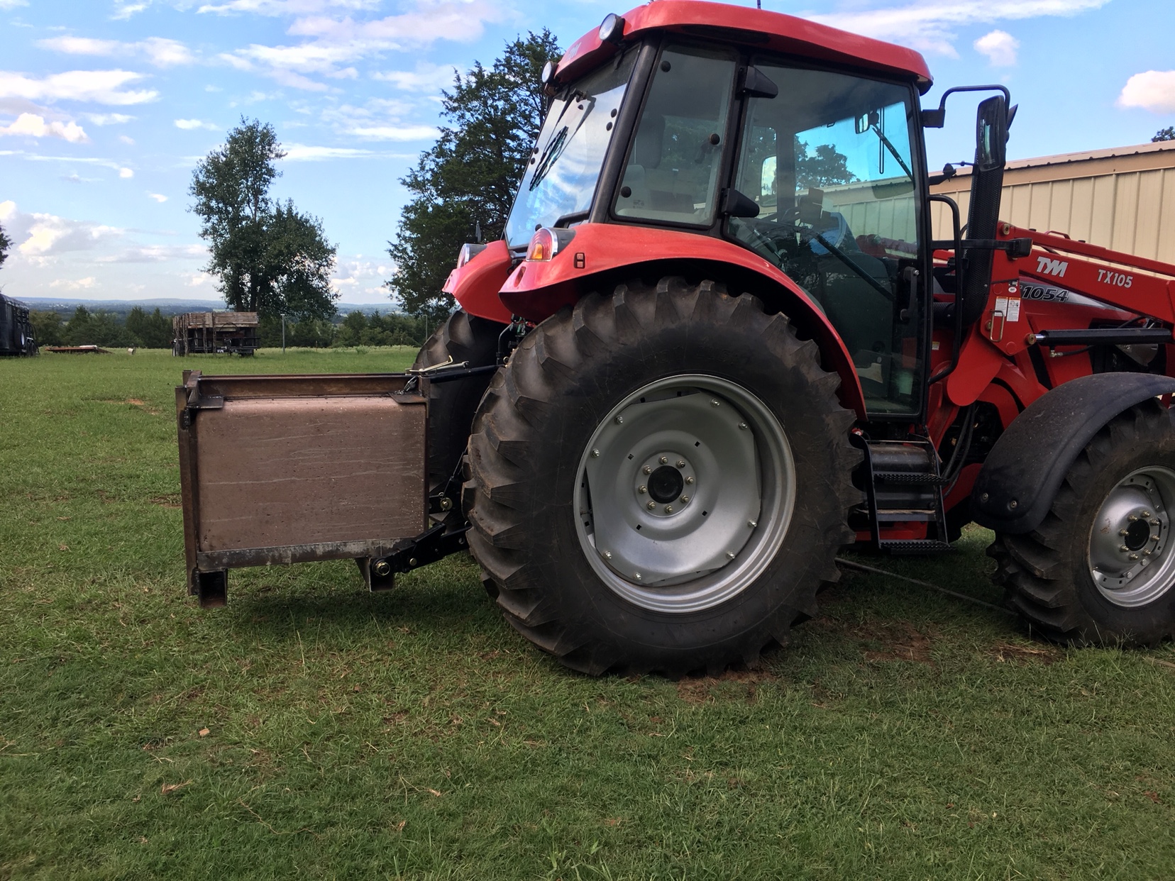

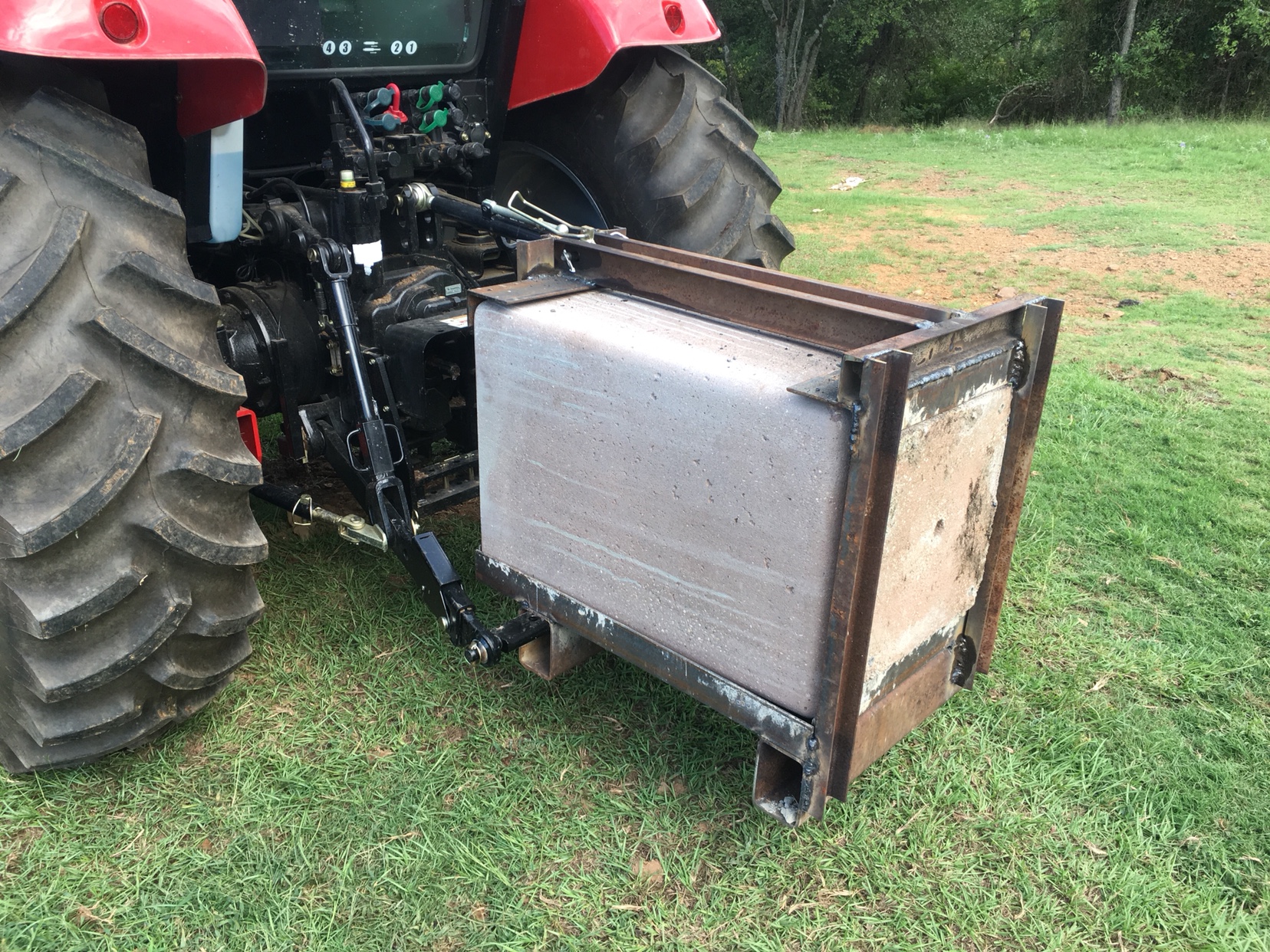

So here my ballast. I used a 24”x 36” precast concrete trash can that was being discarded at work. Mixed up 12 80lb bags of redimix and use metal on hand for the frame. I used some 4x6 rectangle for the base so I could slide my drawbar through. I wanted to have the weight away from the rear axle to get the most benefit without it sticking out too far. Tried it out today and it has made a world of difference. IMG_1960.JPGIMG_1963.JPG

Nice! I'm always amazed how much better the tractor rides with the weight.
Super nice and simple but you might want to consider afixing that drawbar to the square tubing somehow. once that gets bouncing it's going to put a ton of stress on your 3-point linkage. Just something to think about...

I would guess the total weight is around the 1500lb mark. The 3 point is rated at 6k. I didn’t notice any movement yesterday. I left the window open to observe. I’d be surprised if it bounced. I’m kind of a slow poke around the place! My intent of using the drawbar this was two still be able to use the drawbar for other tasks. Securing it to the ballast would certainly be easy enough if needed though.
I am going to fill the tires soon and I’m curious as to how much stability that will add.
