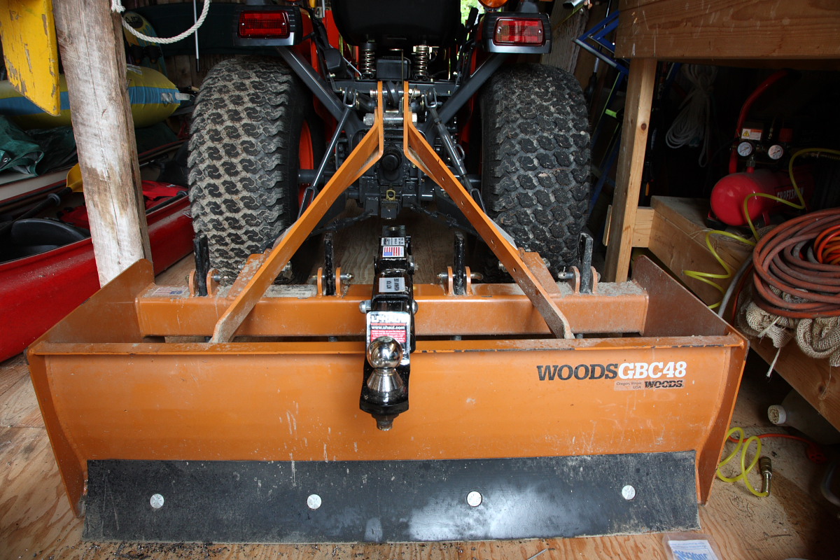

Or otherwise modified rear 3-pt implements for enhanced practicality!
I don't even have a box blade yet, but it is very high on the desired-implements list. It sounds like a lot of folks here keep it on the rear of their CUTs almost all the time. I am in the process of breaking ground on an overgrown parcel of land, so a box blade is an obvious choice for ground shaping and root tearing, etc.
However, I still need to be able to tow around a trailer, skid logs, etc. And taking off the box blade every time I want to do any of this seems like a major pain. And it's always good to have more rear ballast weight by keeping it mounted.
So, I thought I saw a picture once of a box blade with a tow hitch. How about a log skidding boom / chain hook? What about a tool box, battery box, or winch mount? Maybe a chainsaw holster?
Seems like a box blade with accessories could be the ULTIMATE rear 3-pt attachment. Anyone have pics or experience to share? Thanks in advance!
edit: found one: http://www.tractorbynet.com/forums/...47845-checkout-my-combo-boxblade-trailer.html

Where would you mount your trailer hitch on a rollover?;)

When I use a chain or cable for towing with the box blade installed, I just raise it and hook to the tractor drawbar.

For towing... a log? Trying to think what else you would tow with a "chain or cable". I know I have some log skidding in my future. I do NOT want to tow them flat on the ground, as I understand it makes a mess of things and dull chainsaw blades in a hurry. So I need to get the front end of the log elevated somehow.
My concern for towing a trailer is that a box blade is not going to be able to be raised high enough to safely couple a trailer under it to the drawbar. Nor would that be at all convenient, if it could.
