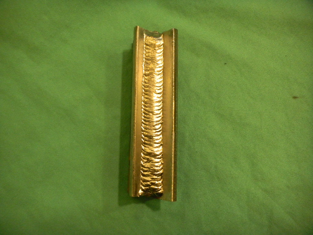

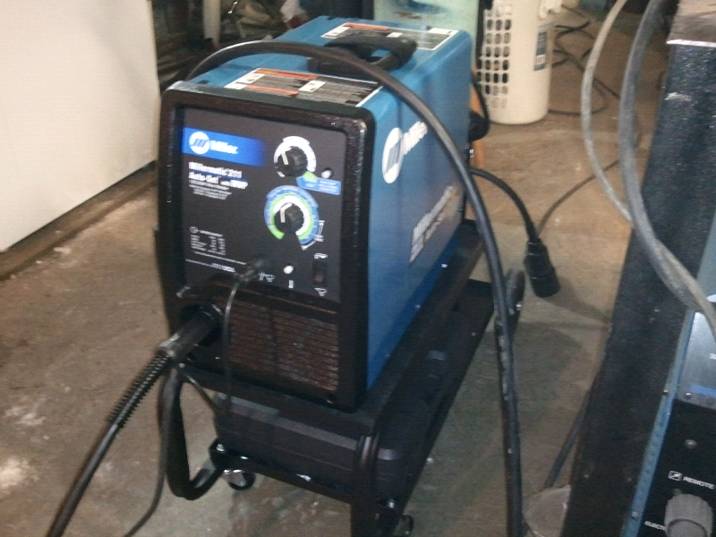

Finally got a chance tonight to play around with my new mig. Millermatic 211, I bought it for its portability, and first spoolgun for aluminum that I ever personally owned. Nice machine, very happy with it so far.

So Mike how does that puppy do with vertical up? Say with some .035, will that machine run .045?
   / Let's see your welds... #93
If I remember correctly the 211 has the MVP plug, does it not? It's one of the few things I'd like to have as an option on my Miller 180. As far as power goes, the 180 has enough for the MIG work I do, but the flexibility of 110-220 is nice.
The Miller spool gun that comes with the 180 (and I think the 211 is the same) isn't bad. I've used mine a few times with no real problems, other than melting a few contact tips until I got the hang of running a longer stick-out.
Mike, do you find you get more spatter with the Miller than you'd expect? I've used mine quite a bit, and I find that welding anything more than 1/8 material gets pretty messy as far as spatter is concerned. I'm using a tri-mix gas and solid 0.030 wire.
Have you tried the Auto-Set feature? I thought it was going to be a gimmicky thing, but it's actually quite good.
Sean
I'd like to get my hands on your welding machine. Hard to believe it has so much splatter!:confused: What tri-mix are you running? You may cut down on the splatter by switching to 75% argon & 25% Co2. If it's not an issue with gas, brand of wire, I just can't believe it's a problem with the brand of machine:confused:, Miller makes some of the best welding equipment on the planet. If none of the above corrects the splatter problem I'd have to say you don't have the machine adjusted correctly.

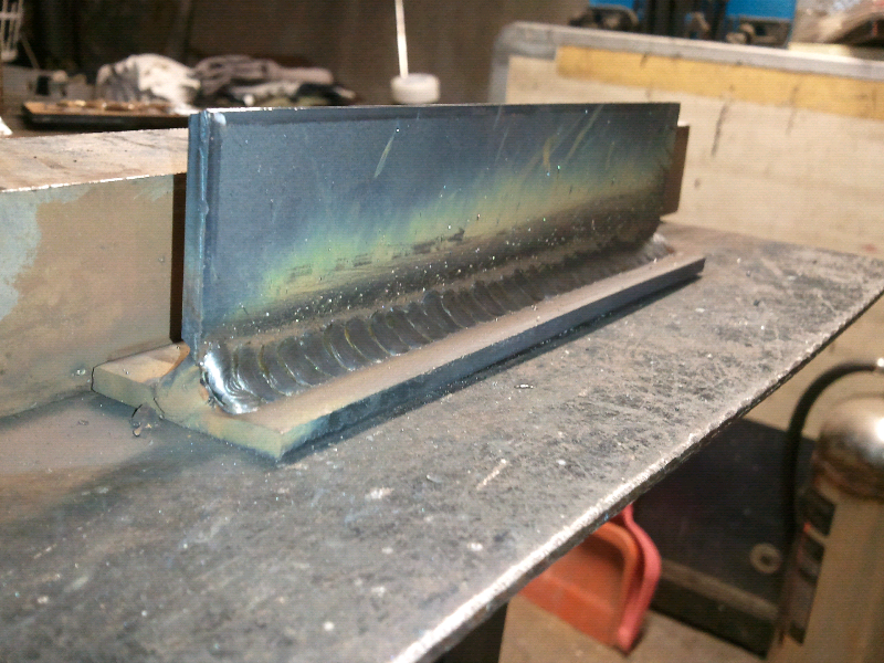

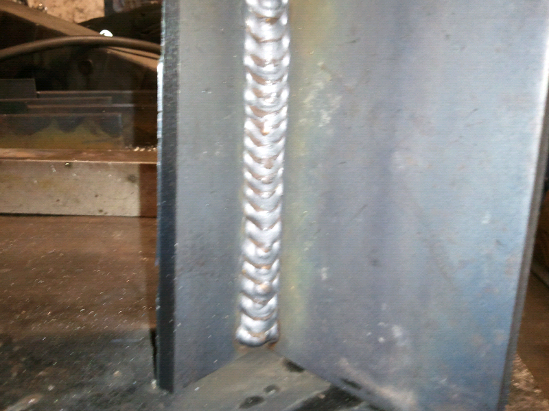

Welds real nice vertical uphill, and down hill. Very happy with my new purchase, the only thing I miss .shield is that quality thump I get when I pull the trigger on my old millermatic 185, but they have to save the weight somewhere I guess. Still not a bad complaint tho, nice little machine. It will run .045 flux core. Chilly im sure shield arc answered your questions for ya bud. Try a %75%25 mix and fine tune that baby and you should be good.
Left one uphill, and right one down hill. Ill play more with fine tuning over the weekend, but happy for now. The autoset I havent played with yet and dont believe I would ever have too, but one day when I have time ill see what it does.

I don't think I've ever run one of those Miller Mig machines. I think the closest would be the old Airco machines. I've heard nothing but great things about the 211. I understand Miller really dropped the ball with the 250, went back to the drawing board and came out with the 251, then the 252. I understand with the 250 the sweet spot was very narrow, and only very experienced weldors could find it.

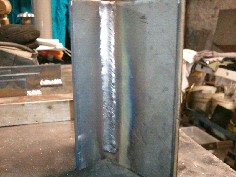

I've done a little Mig welding with my new Invertec, and my LN-25, but next to none with the LF-72 feeder. Here is a vertical up with the Invertec and LN-25.

Nice job uphill with your LN25 shield. Yeah I dont get the whole thing with the auto set either, im almost embarrased to try it. Jeez theres a chart inside the machine, but to each his own. Im a big fan of the miller stuff its all ive ever owned, but ive used everything under the sun, and theres alot of good equipment out there, specially these days. In this industry its just like the chevy ford dodge debate, just comes down to preferance(for the most part).

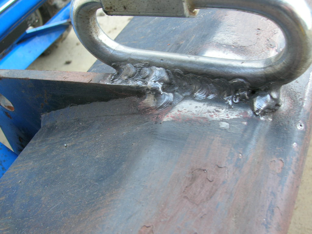

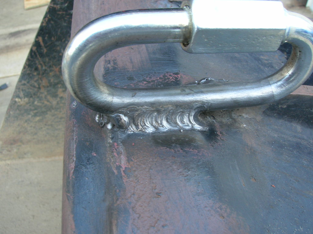

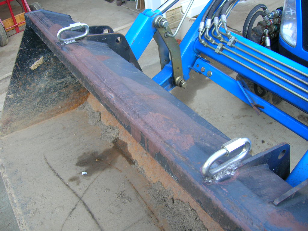

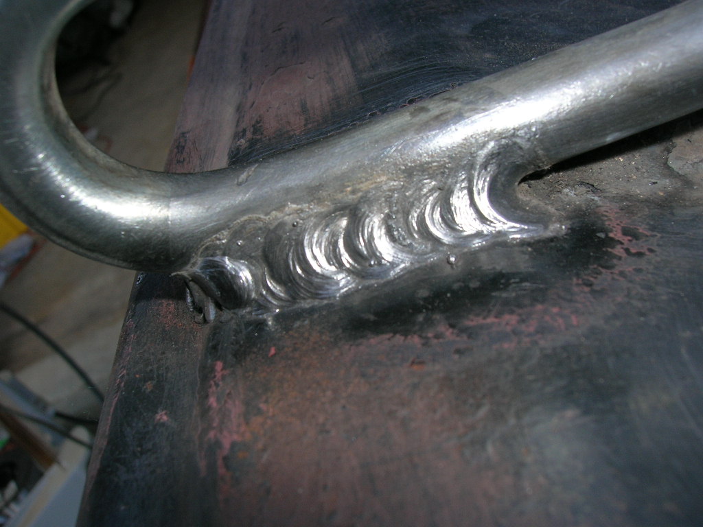

Well I went out and bought a Lincoln pro 140 MIG welder last week. Today I tried it out by welding a couple of links on the top of my bucket. This was the first time I ever used a MIG welder and I think it worked ok. I watched several videos on utube, read the book a couple times and followed the settings in the chart on the machine. Its been 40 years since I last welded anything and that was with a Montgomery Ward 220 volt stick machine and I never quite got the hang of it. I used the .030 flux core wire that came with it and set it at range D, speed 4.5. I have no idea what that equates to in amps or speed but it seemed to work. Here are pictures of how it came out. Perhaps I could get a critique? I'm sure I need more practice - its hard to move slow and even.
P.S. My wife came out to look at what I was doing and asked if those were handles for riding in the bucket?
John C.

Those don't look too bad at all, I've seen a lot worse. It'd be nice to have some more attachment at the back of the links, but the shape of the bucket doesn't lend itself to easily doing that.
The trick to moving slow and even is not to concentrate on how fast you're moving, but to watch the puddle of molten steel. I used to think I had to control my speed to get a good weld, and although you do have to be steady, the weld puddle dictates how fast you travel. I use my stick welder more than the MIG these days, I always find myself having to speed up using the MIG now.
My rule of thumb is to keep the electrode in the front 1/3 of the weld puddle, different folks will have different opinions, I'm sure. Did you use a "push" motion or "drag" with the gun?
What happens to me if I travel too fast and the electrode starts to come out of the puddle is the bead turns "stringy" and narrow, if I'm too slow and sit in the middle of the puddle I get a "bunched up" and lumpy looking weld, or get burn-through on thin stock.
There are a couple ways I've found to eliminate craters at the end of the weld. One is to back stitch an inch or so before stopping, another is to re-visit the cratered spot and deposit a bit more filler metal if I don't realize there's a hole until I chip away slag. The second method is more cosmetic than anything else.
Sean
   / Let's see your welds... #100
Thanks for the reply Chilly.
I was pushing the puddle mostly.
I first tacked each side and pushed from the front back
except I stopped a couple times to look and then restarted
Where I stopped and restarted are the parts that look the
worst. At least to me. They are strong. Just for grins I hooked my chain up
to a 300 pound anchor that I am refurbishing for our community center and
shook it a couple times. No problem and the links even still open and close.
John C.
