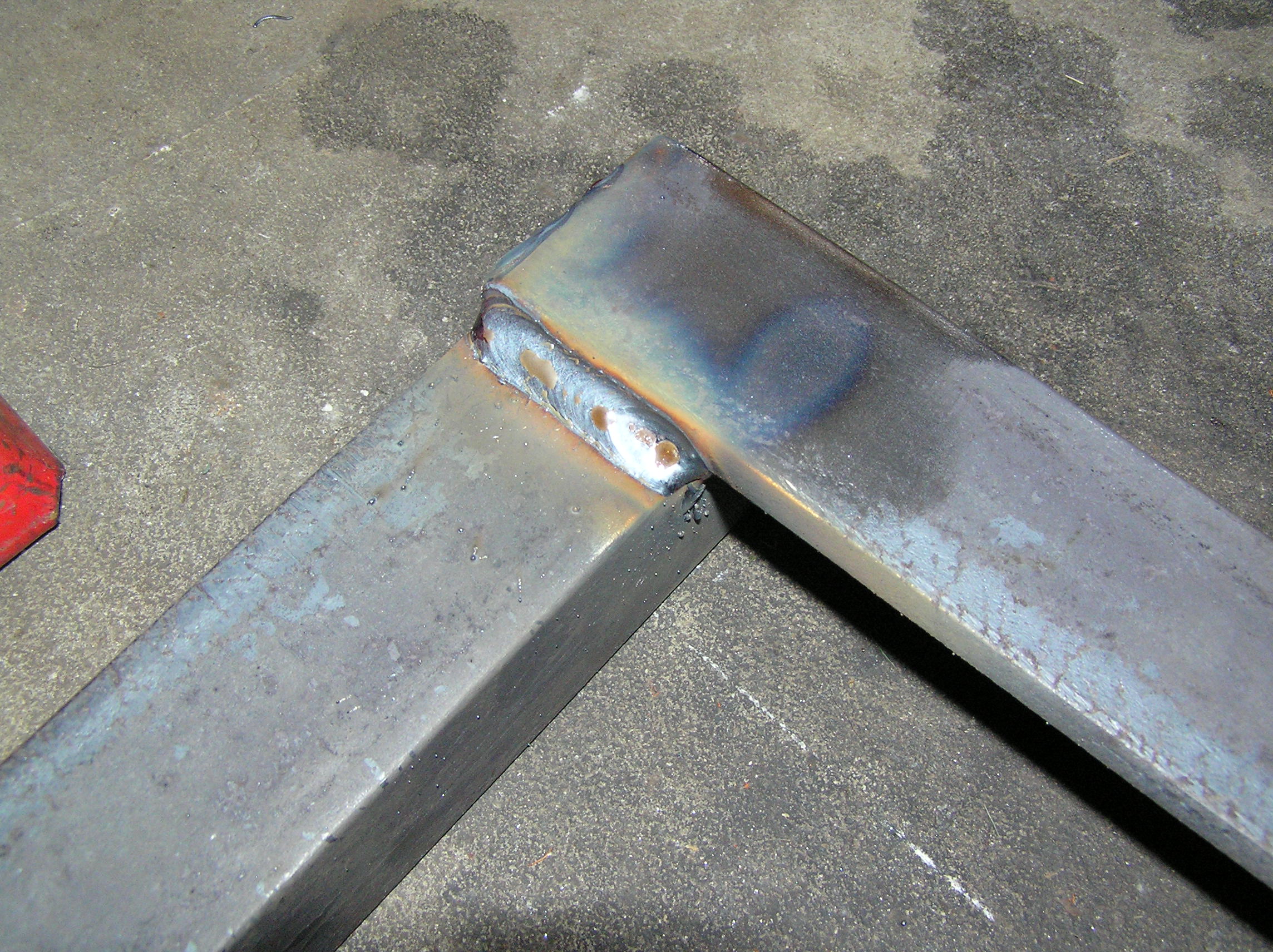

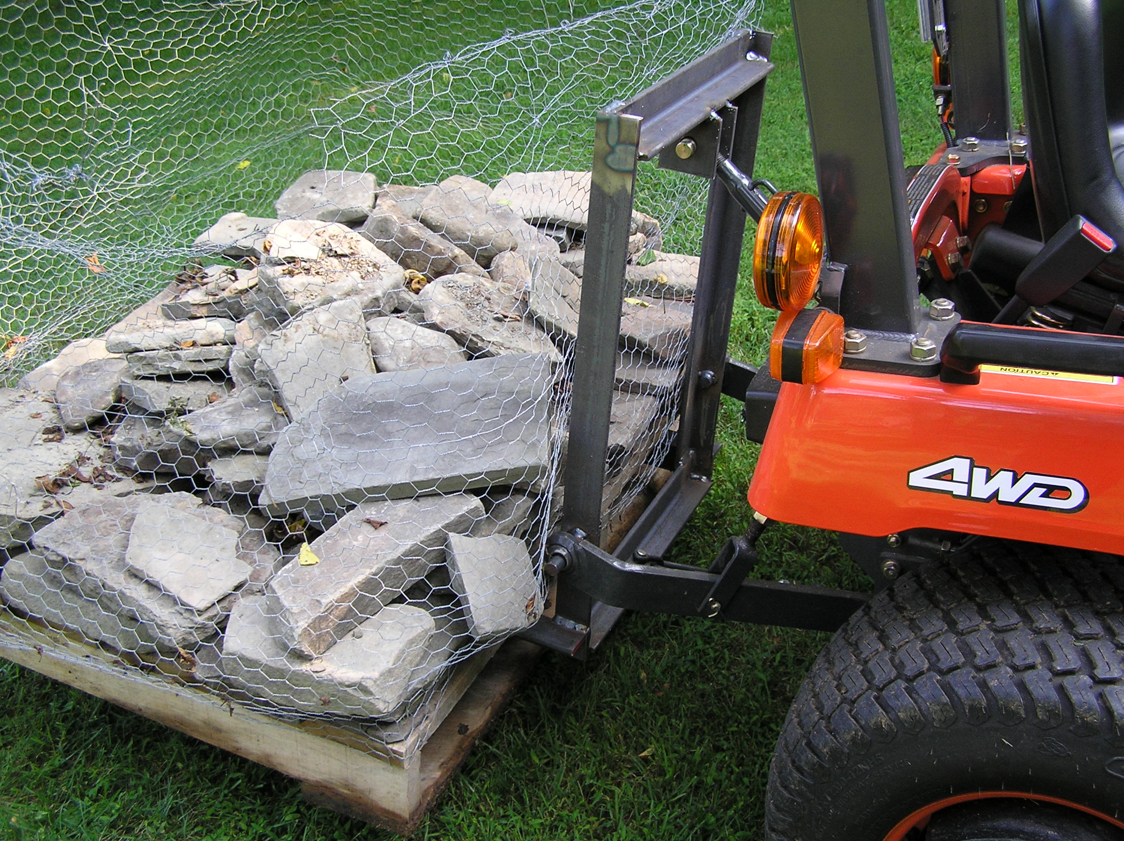

Here's my thee point carryall project that I put together to move stuff around in the yard with my BX

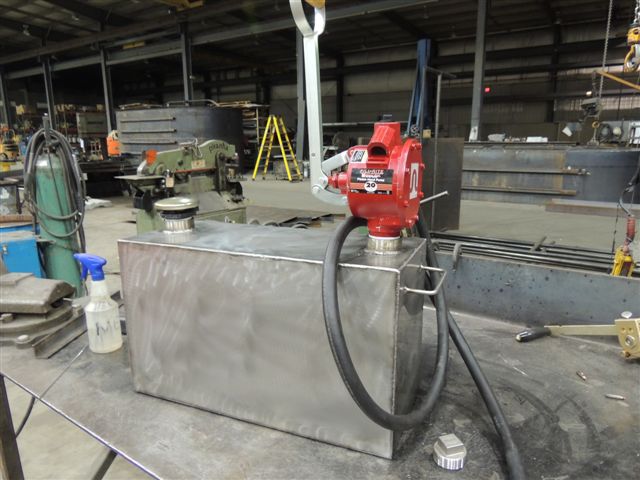

A Gas Tank made from 304 grade Stainless Steel / Tig Welding.
   / Let's see your welds... #135
Nice looking tank. Smaller than most.
Is that going on a portable Maintenance truck?
Strickly used for 100 LL AvGas for my LSA.

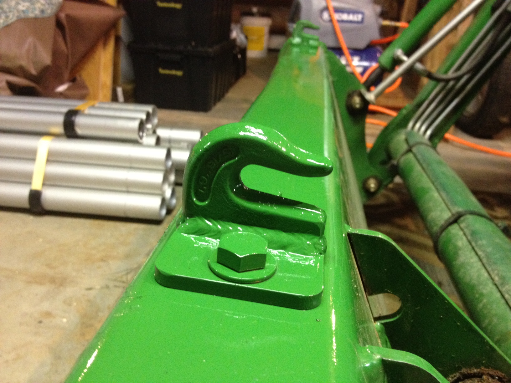

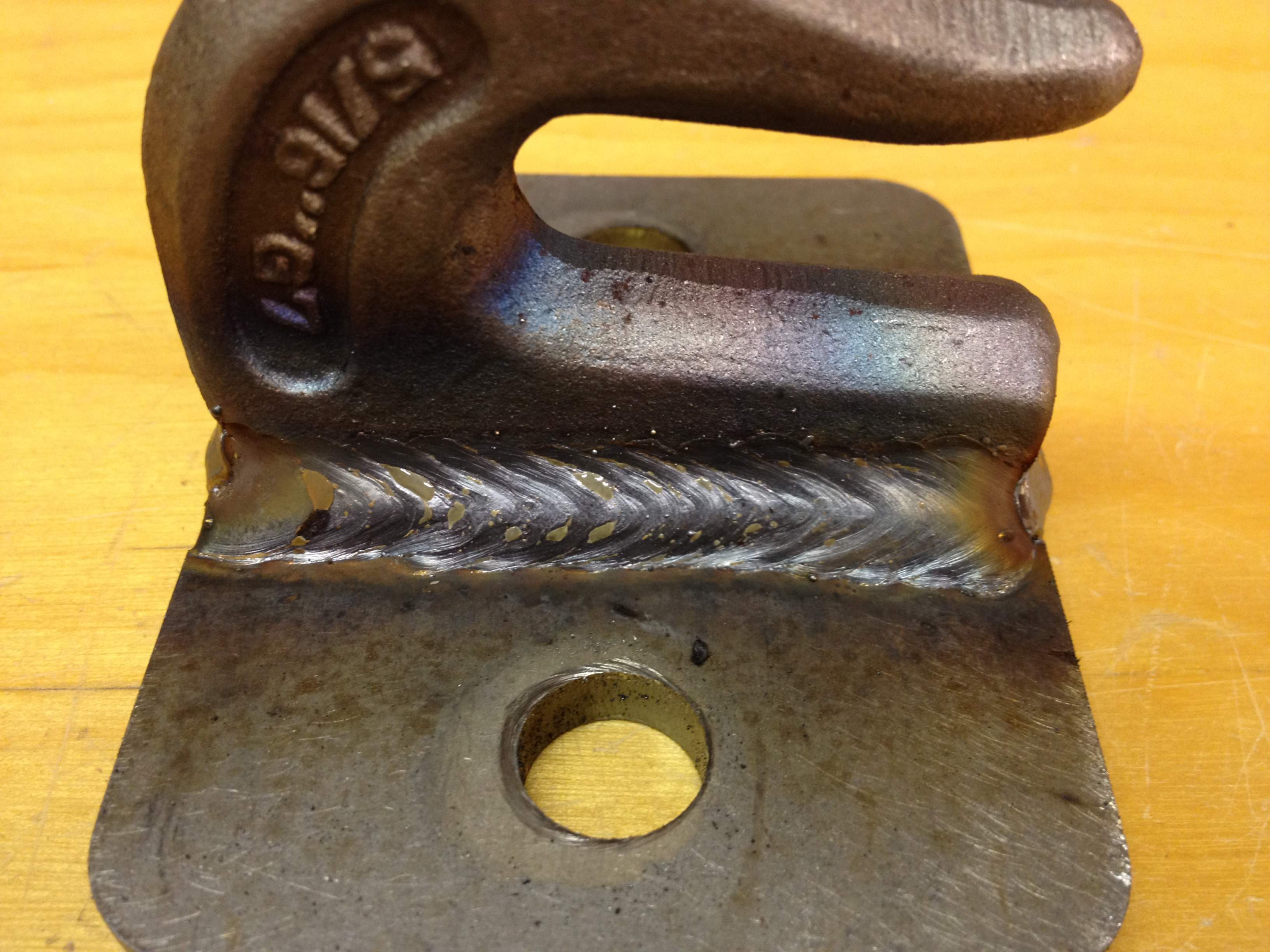

Miller 210, .035" Lincoln L56 wire, 75/25 gas:
After spatter removal, media-blasting, primer and JD Green paint:
