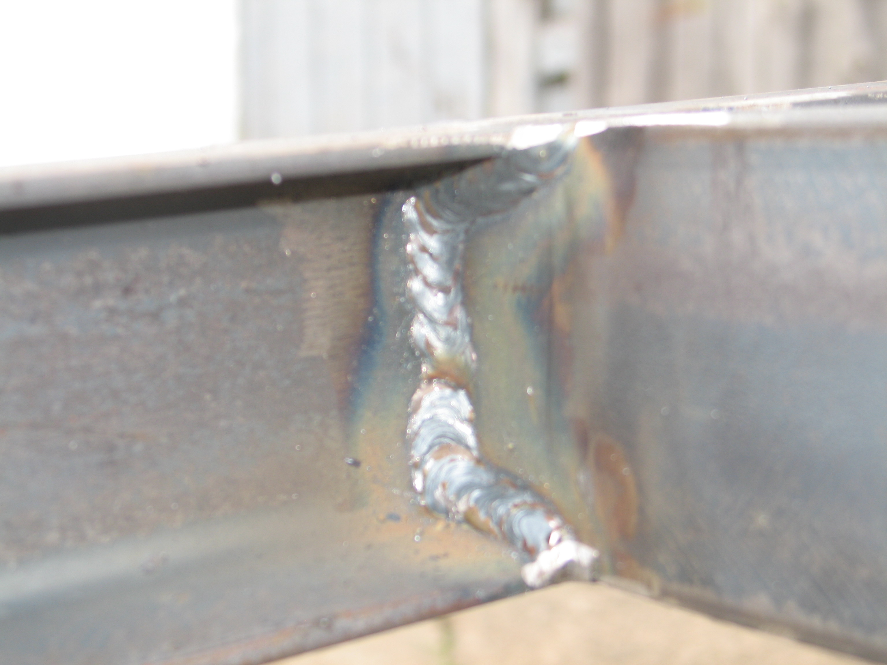

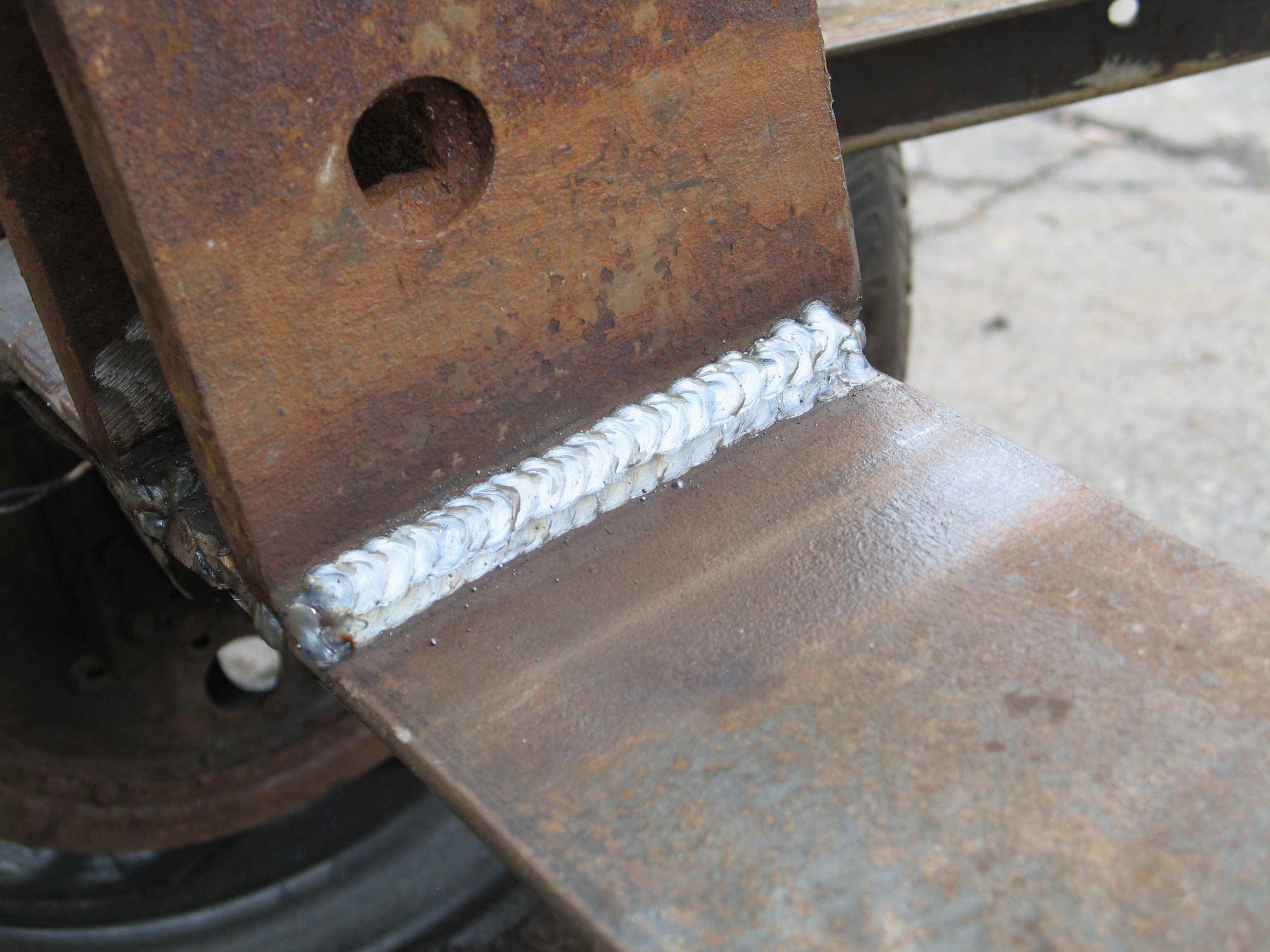

Very good thread you got here and I am enjoying reading it. I'm probably one of those guys that just ran out and bought a welder so they can weld. Some of you guys are professionals so if you would put up with me as I learn, I'd appreciated it.
I do have some pictures I took of some stuff I welded last summer that I know was too thick and I didn't do adequate preparation with. I am not good at disciplining myself to go all the way to get an optimum weld which I should do.
It has been cold out there in the shop and I haven't done any welding for a long time. I should go out and make sure my wire isn't rusted and practice a bit.
Welder is a Lincoln 180C, 240V Mig welder with C02 Shielding gas and I think 0.035 wire. Don't remember what I had it turned up to but probably turned all the way up.
Single pass on about 1/4 inch channel.
This is, if I remember right, three passes on 1/4 and 3/4 steel. I didn't bevel the 3/4 enough to get full penetration with multiple pass.

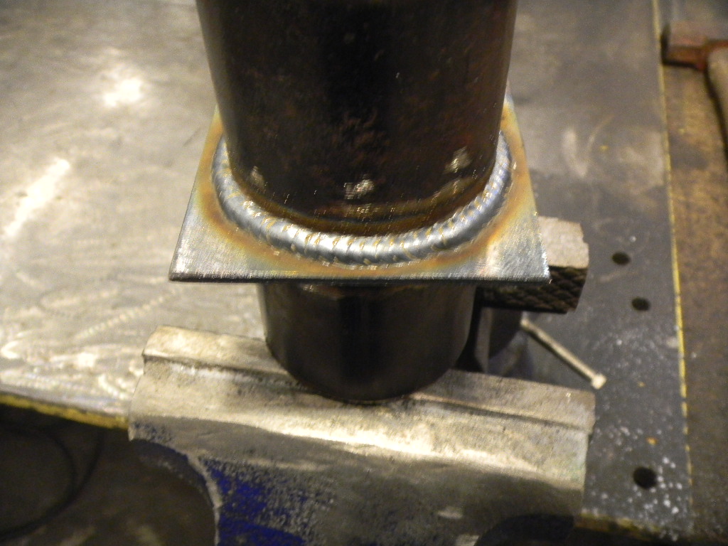

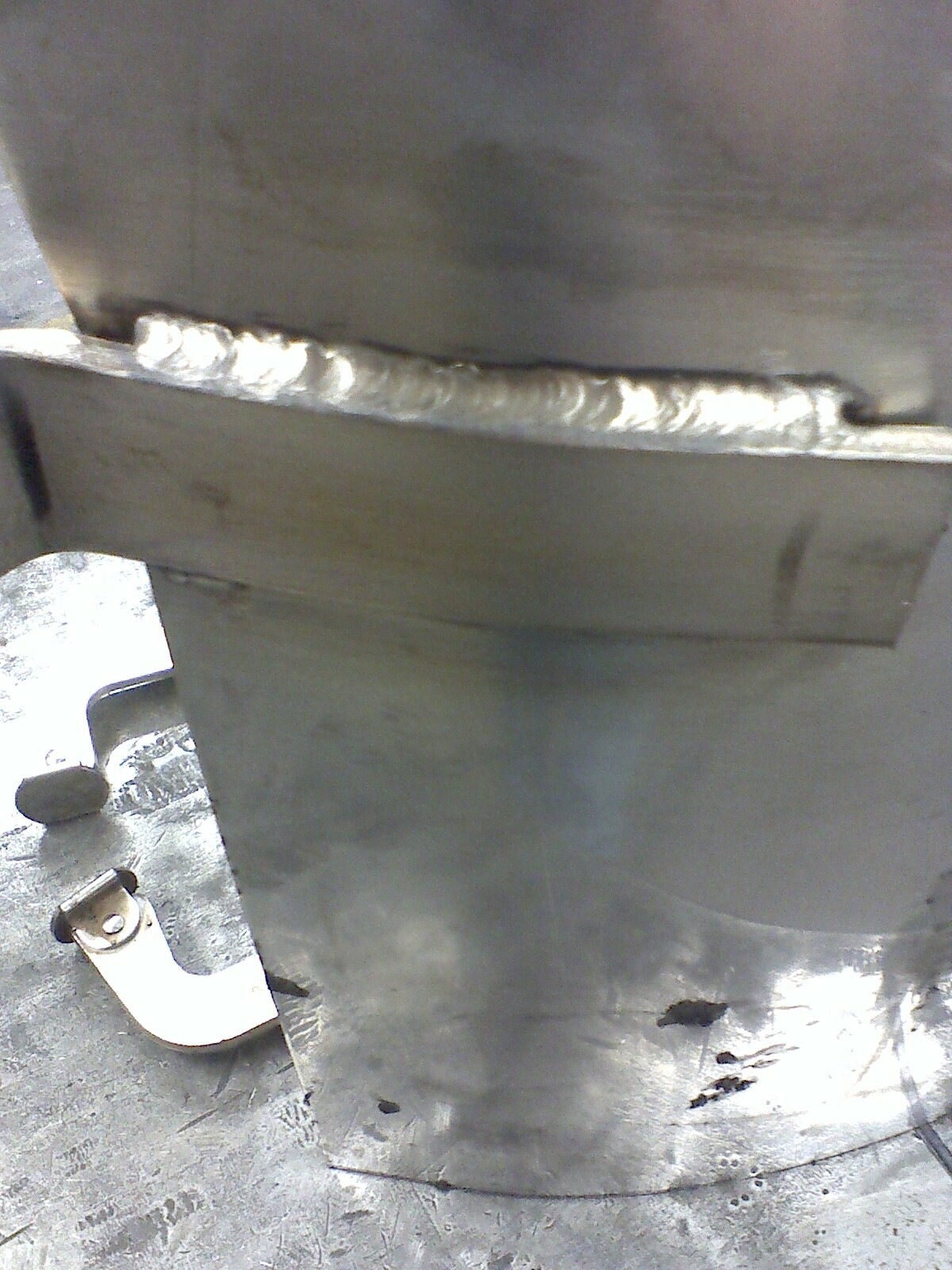

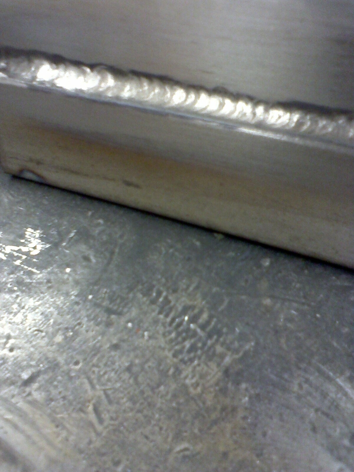

Getting closer! I started out at 16-volts, which gave a little more definition, but I thought it was way too cold. I ran these at 18-volts, 77-amps, wire speed was at 187-1/2 inches per minute, (measured). Even these seem cold to me! I checked Lincoln's site to see if this was anywhere close to factory recommendations. For .030 L-56 Lincoln has a minimum of 17-volts, and 35-amps! I was shocked at this!:shocked:
The travel speed on this is so slow, I fell asleep three times while making this 7-inch long weld! :laughing:

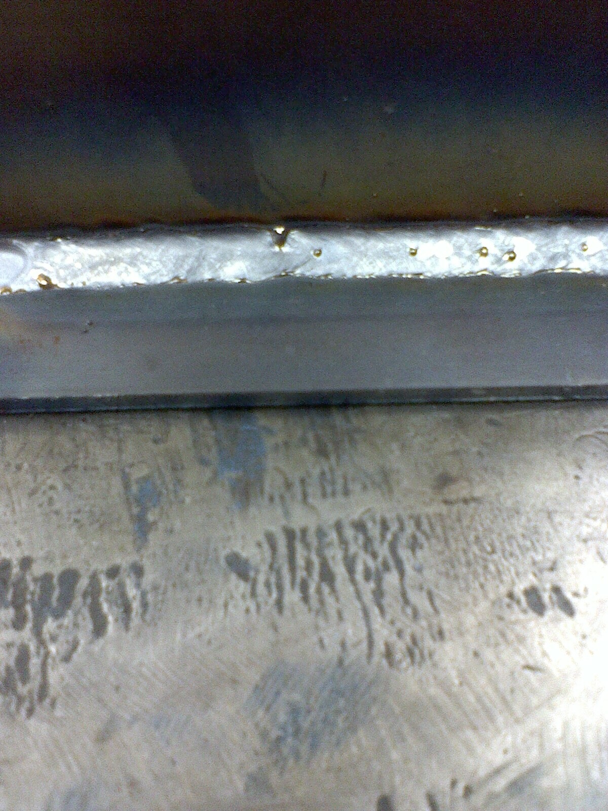

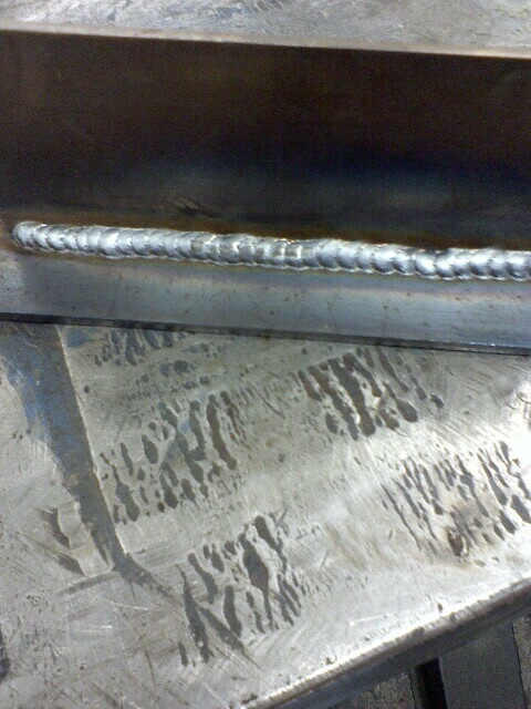

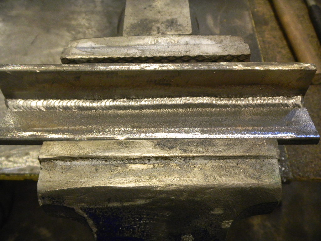

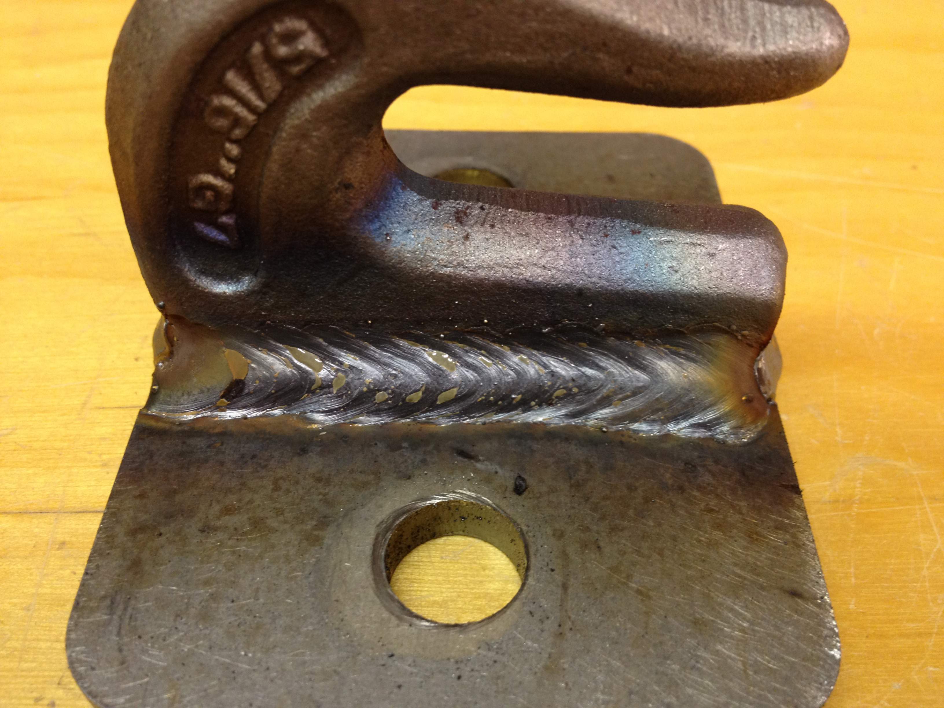

I never had much trouble getting that " fishscale" look. It is all in the type of weave you use. The >>> look is probabally just from a typical u shaped or z-weave. You can run the amps hotter and still get the "tig" look if you do the lower case e pattern. The problem is doing it SOOO consistantly.

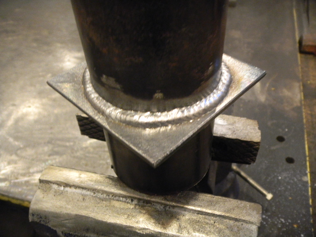

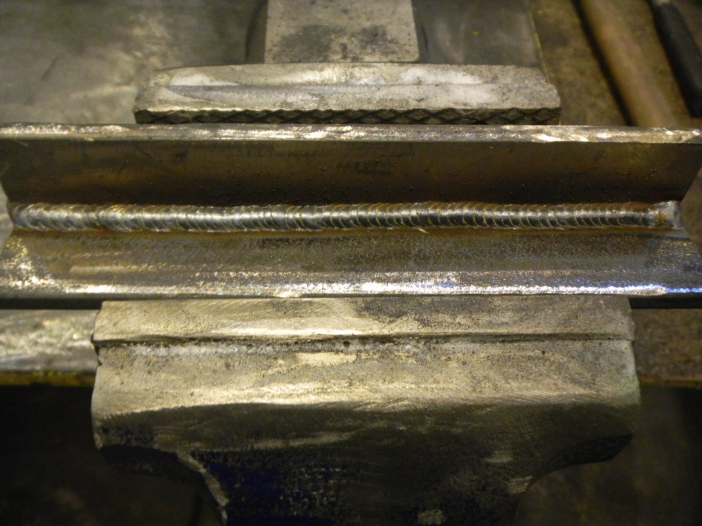

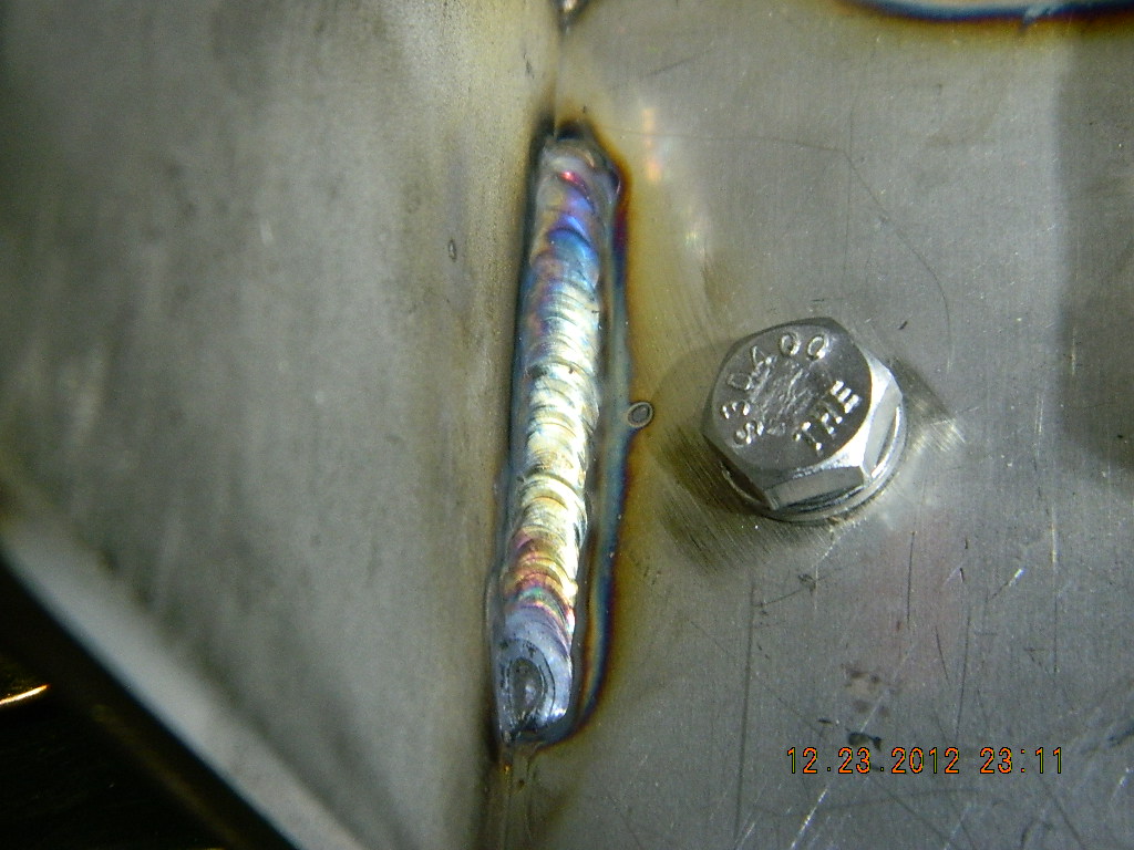

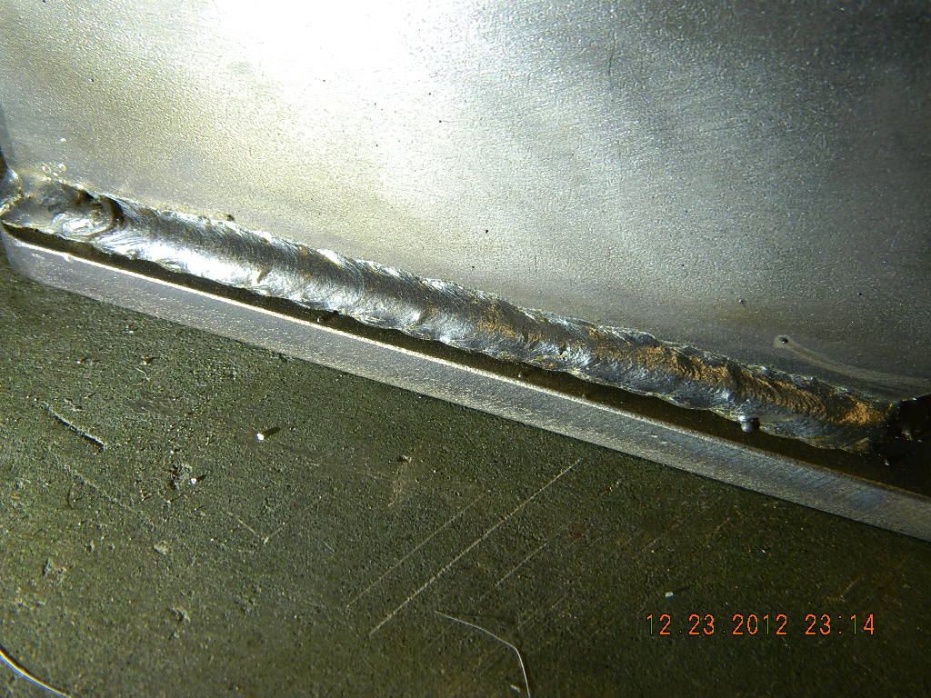

Here is a pics of some I just did. Miller 350P welder and .035 wire. Volts @ 15.8 and wire @ 160 FPM. This was 1/8" cold roll. And I too feel it isnt hot enough. I tried it colder and slower as per suggestions here. I normally would have welded this somewhere around 18.5V and 200-230 FPM.
The second pic is the same size metal, only set up to pulse. Wire speed @ 280. (there is no voltage/amperage adjustment on pulsed). This is about 2x's to 3x's faster travel speed than short curcuit welds.:thumbsup: And **** strong too.

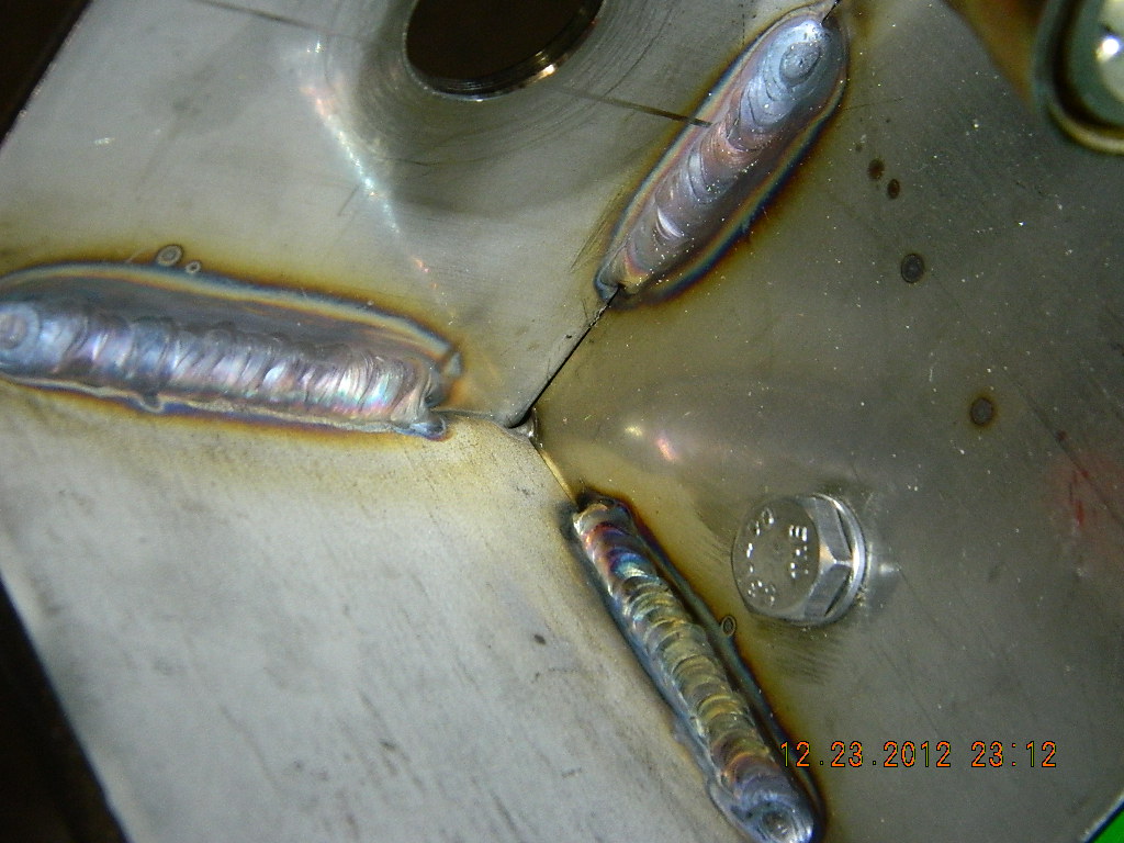

The last two pics was a little TIG'ing on some stainless. Welding 1/4" bar to 14ga sheet for a guard.
